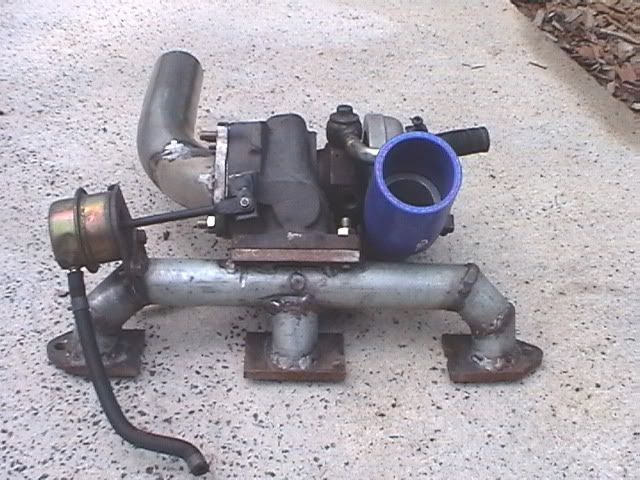

ok another update:
oil return done water lines are sorted
my fuel pump and regulator arived yesterday
got some silicon hose for the inlet
oil feed arived
all new studs on the turbo and got the gaskets
and im working on the dump pipe now
heres sum pics sorry bout the quality
I can't tell from the picture, but is your fuel pressure regulator a rising rate type that senses boost pressure? As this is the type required.

regulator isnt a rising rate but james (kazjim) told me how to modify it to a rising rate*smiley*

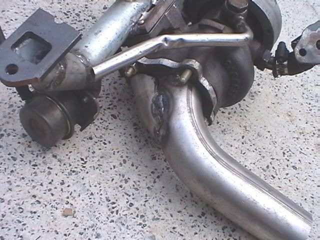

ok nearly done now sum more pics *smiley* dump pipe was made from 2'' mandral bent mild steel and 1 3/4'' mild steel for the top part of the dump pipe
still have to do a little bit of welding on the dump pipe and manifold then its done, couldnt be more pleased*smiley**smiley*

hi benjamin ,i,d like to say well done for having the determination to do so much work to get your project finished ,having done quite a rew one off turbo conversions,i wonder if i could help you a bit ,,with regard to the wastegate welded to the exhaust ,i think it may get a little bit too hot for the diaphram and spring inside the can to survive, remember that pipe will be red hot . also if you look at your pipes coming in from the 2 end cylinders ,they meet the central pipe at a right angle ,this will make a lot of heat and turbulence at this point ,and stall flow back to cyl 2 and 3 ,if you could get a little bit of a turn into the 2 end pipes before they get to the turbo so the flow is directed into the turbine it will be much better .best wishes robert

well this is manifold version I so ill see how it goes, im always making stuff so im sure ill make a manifold that out flows this one later on. Just trying to get it all sorted and on the car for now, not worried about a small hp loss at the moment.
i have plans , drawings that iv done for a much nicer flowing manifold for later on so that will be version II

just another thought on your waste gate actuator, is it facing the rigth way, cause the diaphram will push the gate open and looking at it you have turned it around so does this mean the actuator will need to pull the gate open by the looks of it? or have you welded the lug on the other side of it so it will still push it open?

yeh grant, the lug was cut off and rewelded on the other side then i hooked the compressor up to it and made sure it worked fine ONly using 10psi tho

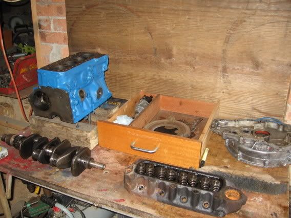

still havent got it on the car as there was a slight change of plans.
ended up geting another 1098 motor and im going to rebuild it for the turbo as the motor in my car atm is a bit tired and a little smokey.
the new motor will be as follows:
1152cc with hypatec pistons
12g295 cooper head with unleaded valve seats
lightened rods
wedged and balanced crankshaft
lightened and balanced flywheel
re-13 turbo cam
isky cam followers
minispares belt drive timing kit
so far the cam and flywheel have been sorted , but shouldnt be too long for the whole engine to be build, cant wait though*smiley*
