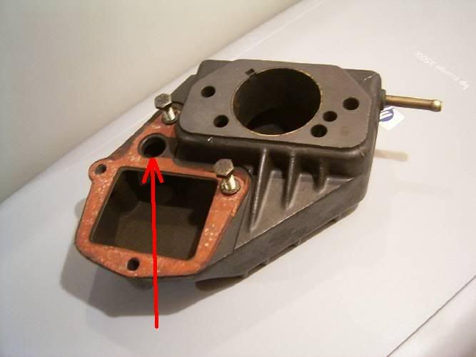

Between the two halves of the plenum chamber there is a spring loaded poppet valve. As standard it is a plastic poppet seated by a spring, it cracks off at about 8psi.
If it is not there you will struggle to make any boost as all the air will piss out.
The poppet seals against this hole-
And sits in this housing-

blimey you dont mess about thanks Tom, just had a look and it appears the previous owner removed it and bolted a washer and a rubber sealing washer in its place.
I think in the new year i'm going to have to do some serious investigation as the boost is going somewhere!
