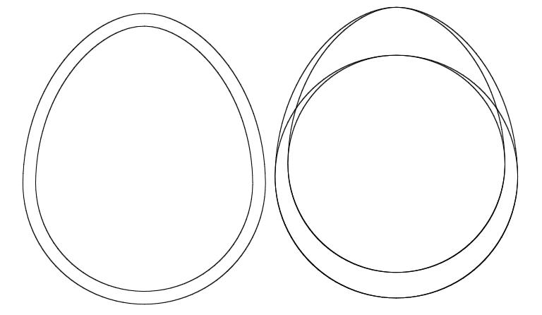

I was under the assumtion that cam grinders used the same "template" which inclues the bace circle, and gust ground the cam enough to get the desired profile whilst getting a clean cam nose.
How can ou grind a cam using the same base circle of a standard cam, and still incrase the lift? You need to grind the base circle smaller to achieve a greater lift.
you cant, thats my point,
to my knoledge a cam grinder is essentially a pantegraph, and what your doing is reducing the cam down to achive the highest point, wheather the base circle ends up at 400 or 500 thou the lift profile ends up the same as its done from the same pattern billet or not.
to my knoledge a cam grinder is essentially a pantegraph.
Edit ** *happy*
with a pentagraph, the lift and the base circle will all change proportionally, but a regrind cam, as the base circle changes, the angel of attack on the open and close ramps are narrower and the lift per degree angle changes. Thats the bit I was trying to put across evenif its a bit fucked up *happy*
Edited by Sprocket on 3rd Jun, 2012.
Ah!
I get what you mean now!
the smaller base circle causes a change in the relationship between the lobe and the tappet contact point,
There is deffo a difference between billet and regrind profiles, but what it actually comes down to I don't know, but as you can see in the crude schematic I drew, the difference can be easily seen between a profile that is exactly the same with the same lift, but on a smaller base circle.
