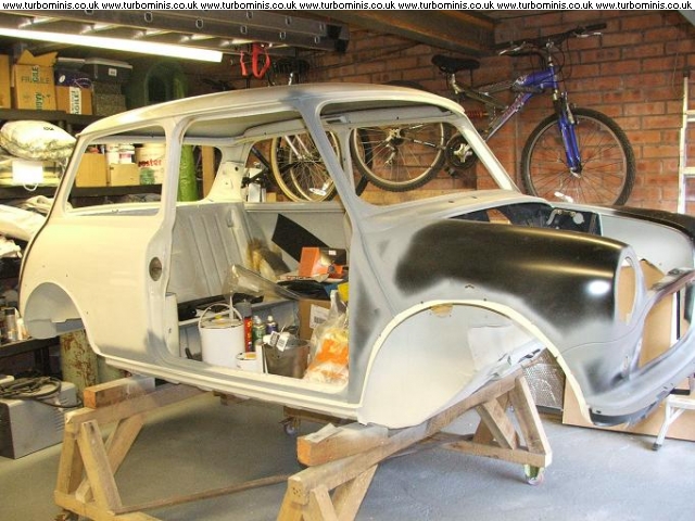

Built the tressle for ease of moving the shell and getting it to a better working hight.

The shell as at the end of the day
