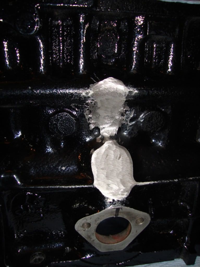

The first of the matty manifolds i had to do some work on it and the block to fit my turbo nice and tight to the block.
all refaced

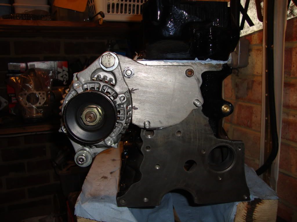

I am moving the alt hole out a bit so the alt will hang closer to the block.

I had to grind a lot more off the block than i wanted but oh well, I don't want a turbo box in the mk1

I got the alt nice and close to the block now.

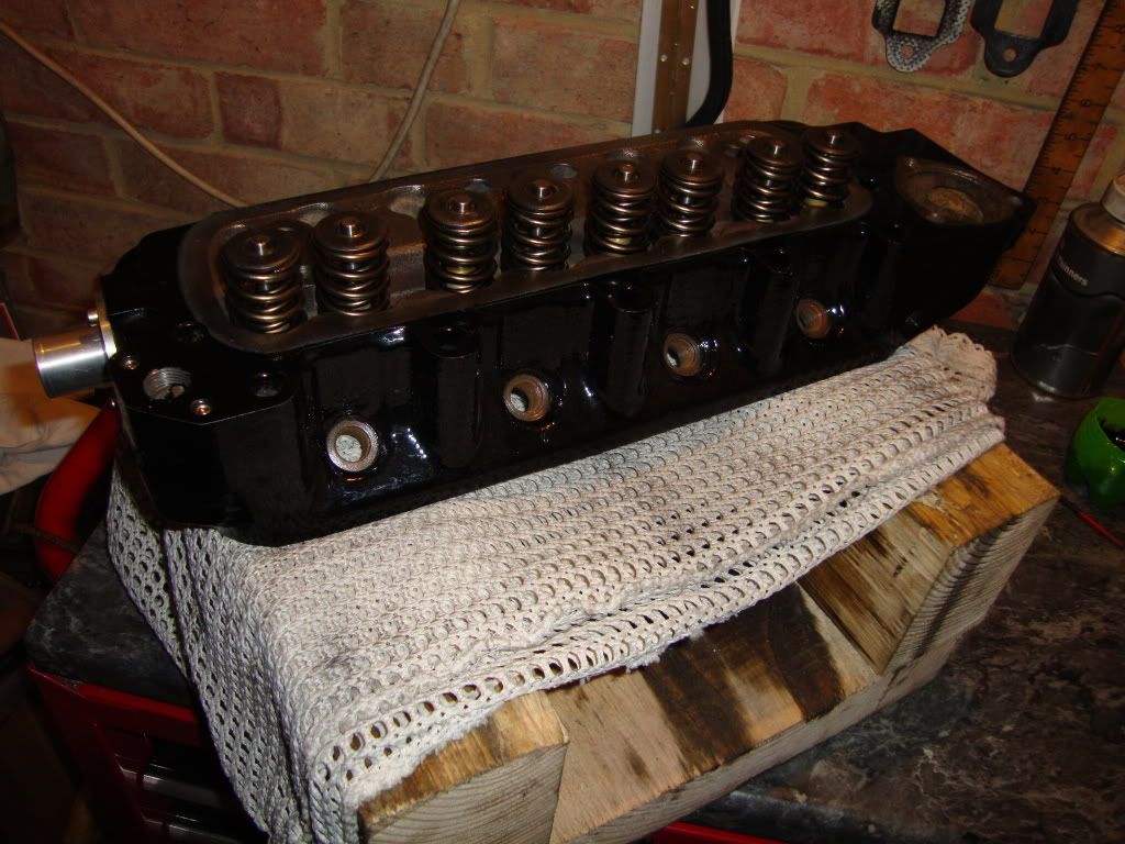

And the head is all put back together now with new springs and all the valves lapped up.

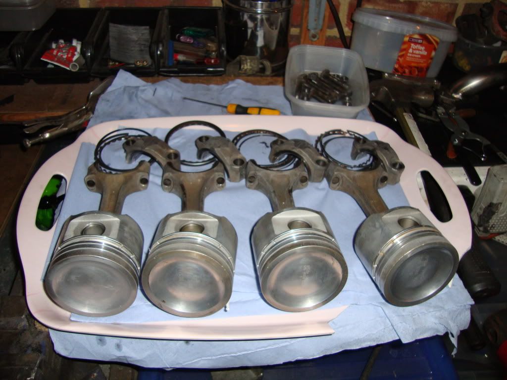

I cleaned the rods and pistons

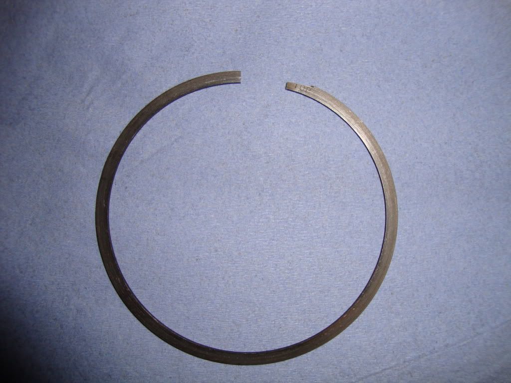

And when I was stripping them I found this, it looks like a piece is missing, what do you think as I am a bit unsure if I will get a new one.

i wonder if that ring was a little too tight or got abit too hot, strange for it to brake like that, did you note what cylinder it came out off? any scrapes on the bore.
possibly chipped of during the strip down
it came out of cylinder 1 with no scrapes at all.

slightly different *wink* Is not the word! I have had to file the compressor housing then I broke through as a crack started, so that got tiged up, then I had to cut the flanges off mattys manifold that he made for me to cut about 15mm off the pipes. Then I had to grind the fuel pump housing and oil way. Then when that was all done I had to drop the face off the turbo flange about 3mm and the turbo face about 3mm so now it sits nice in the back of the block and all because I dont want to cut the bulk head so yes ever so slightly different

definatly ditch that ring, I'd change the whole lot as a matter of course,

I will need to find out how much the rings will be then
there gos £130 then TipTop
