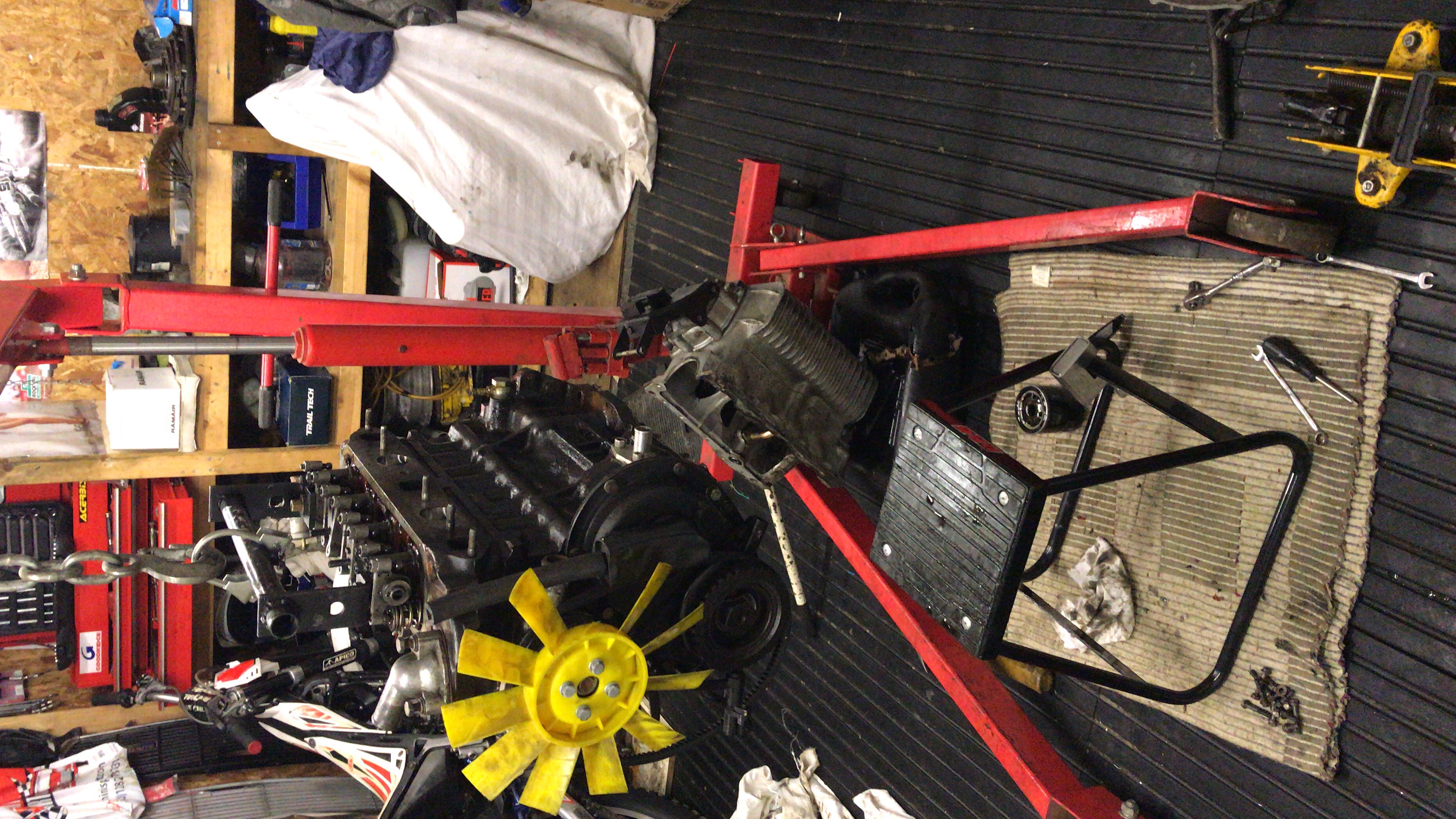

Well found sometime this evening and motivation to get some work done on the mini since it making a mess of itself at Castle Combe.
Engine in out and stripped enough to be taken to Benross to see if a skim will save both the block and head.
Home > Show Us Yours! > Mini 1293 Turbo - The Resurrection 2024
