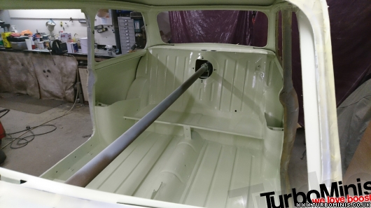

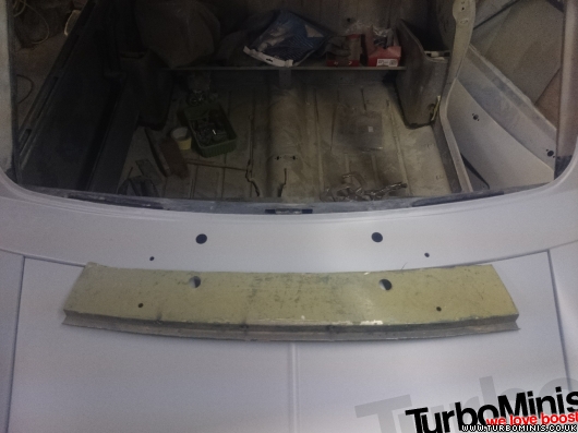

Yes mate checked tonight, you were right. Picture is of the original scuttle I cut off

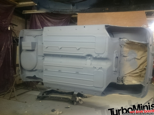

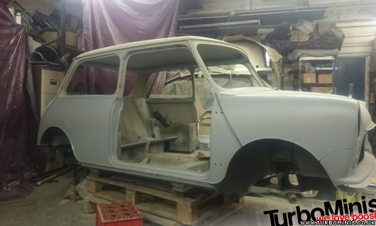

Well I suppose its time for an update, life has been getting in the way as usual. Me and the misses got engaged in May and my brother left for Australia so a full month of parties meant no time for the mini.
Cracked on with the bodywork in June and got the drivers side finished up to the swage line. So just a few bits around the pillars and roof to do and finally it will all be finished.
It went back on the spit a couple of weeks ago for a full coat of epoxy, seam seal and stonechip which I finished tonight. Will buy my paint now and get some colour on.

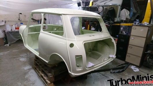

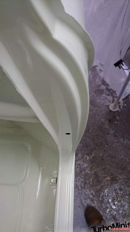

Finally got some colour on. Inside next whilst it's still on the spit

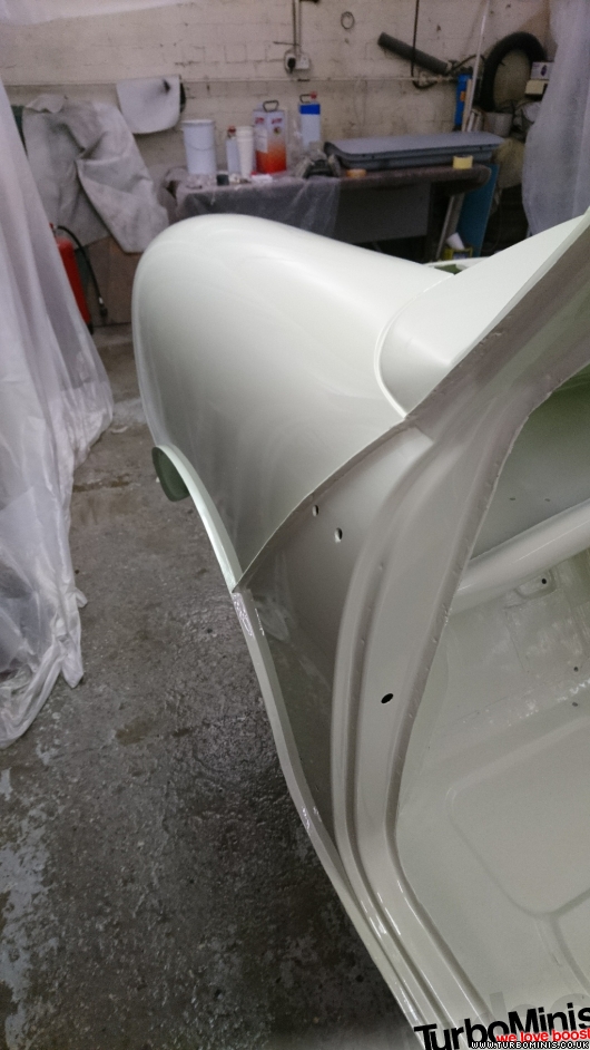

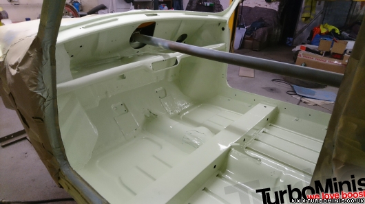

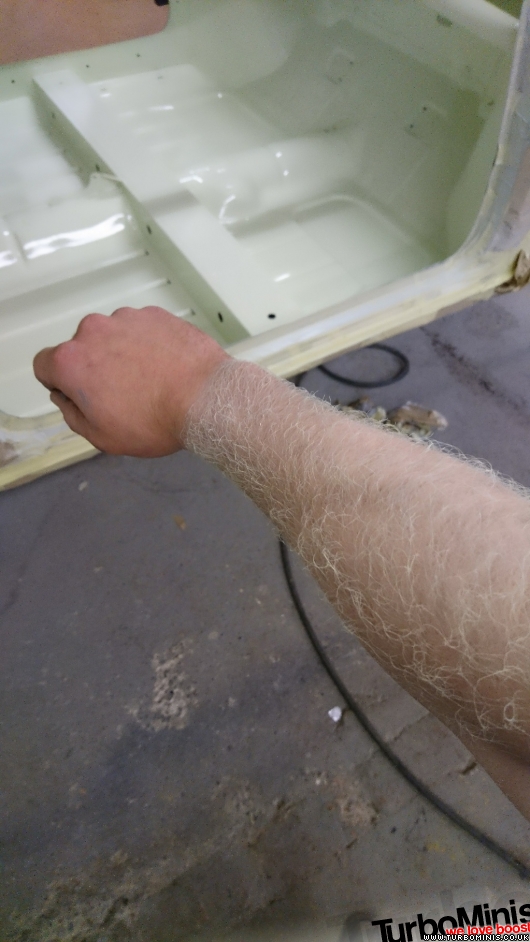

Insides done, pretty happy with how its come out
Will wear a suit next time I think *happy*
Edited by Callum on 13th Jul, 2017.
4310 Posts
Looking excellent, you could have practiced on a spare piece of steel, instead of your arm though!

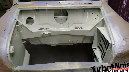

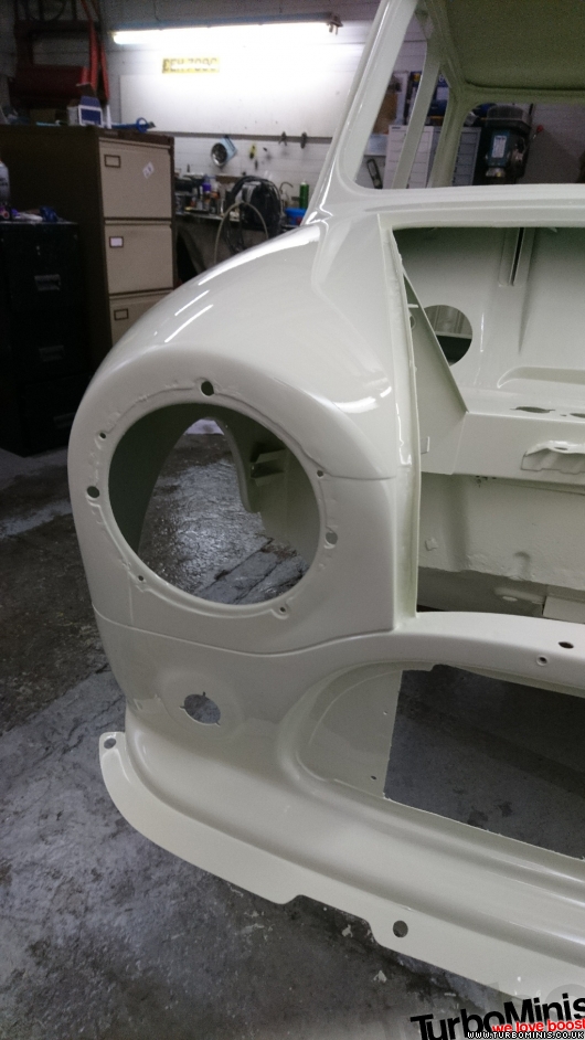

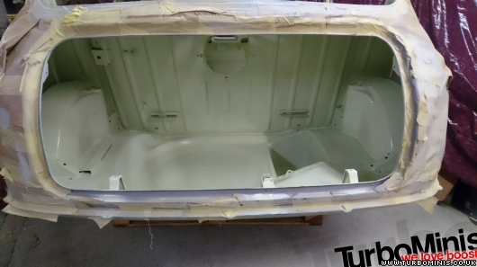

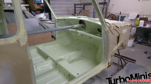

Engine bay and inside the boot painted, bloody hard work spraying in there trying not to touch the pot on anything

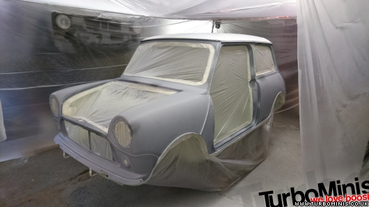

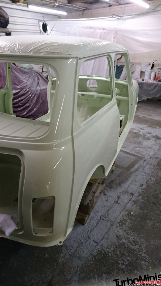

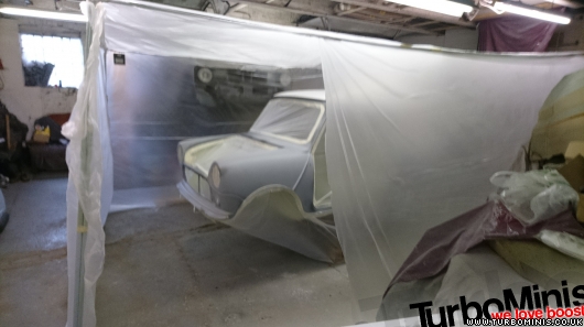

Finally got some paint on it! Knocked up a basic booth on Thursday then painted it today. A few bits of dust manged to find their way in but for a first attempt in a dodgy booth its not too bad.
An old gazebo and some masking film did the job
The pictures aren't great as the gazebooth was in the way
Flat and polish tomorrow then on to the doors bonnet and bootlid in the week.

Nice colour and good job
That looks fantastic!

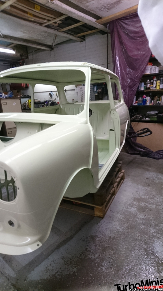

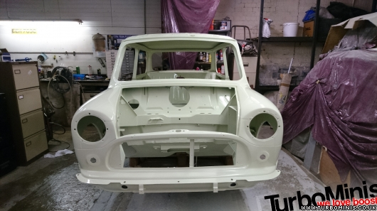

Flatted the whole car today and polished a few areas by hand that I can't get in with the mop. Then just had time to run the mop over the quarter panel. Im going to have to repaint the quarter anyway as Im not happy with some of it, so it was a good place to practice with the machine polisher.
Some black dirt or paint has managed to get into the very first coat so if i carry on trying to flat it out im going to break into the primer. Frustrating but a lesson learnt, will be more thorough with the cleaning next time.
