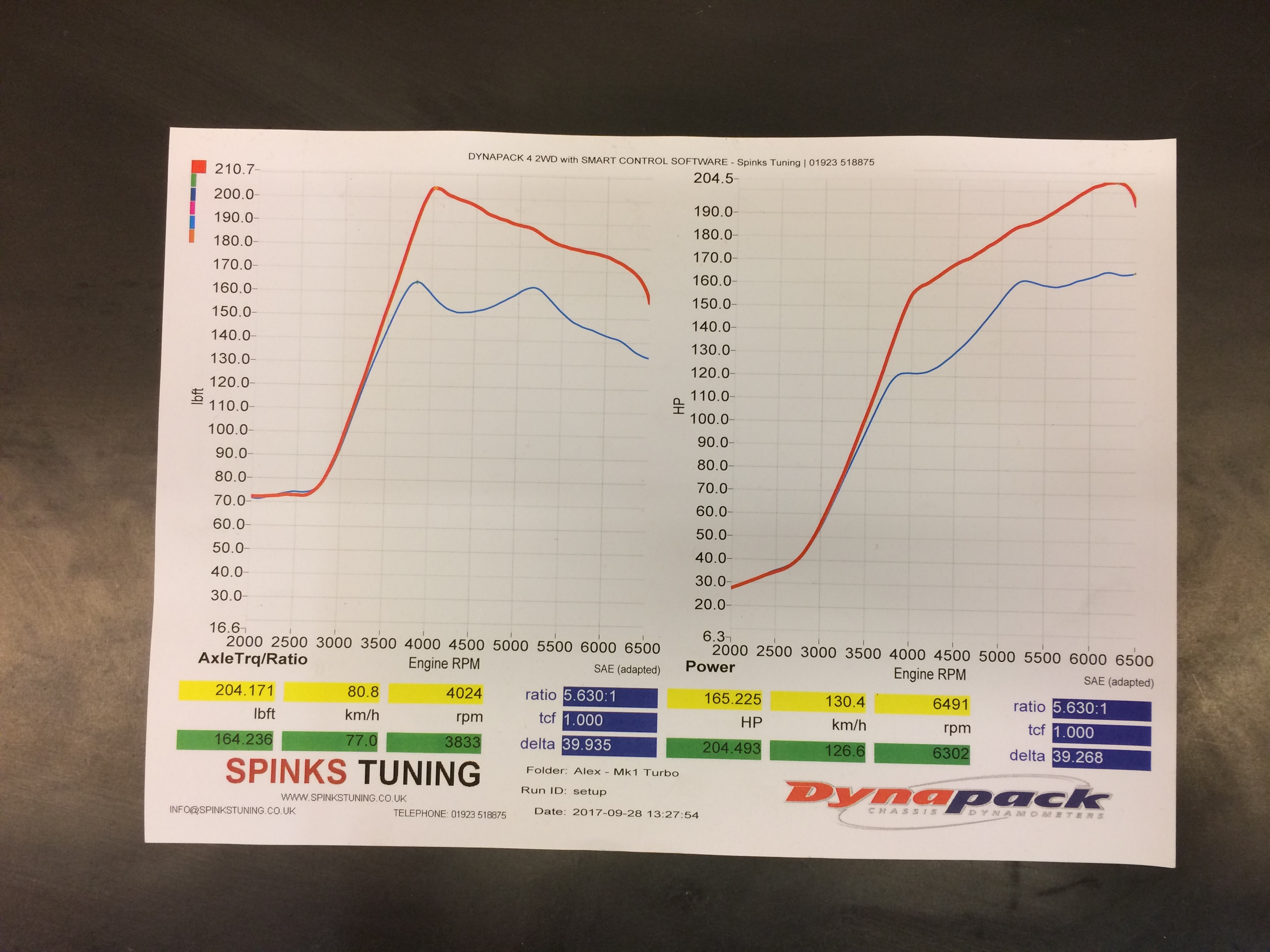

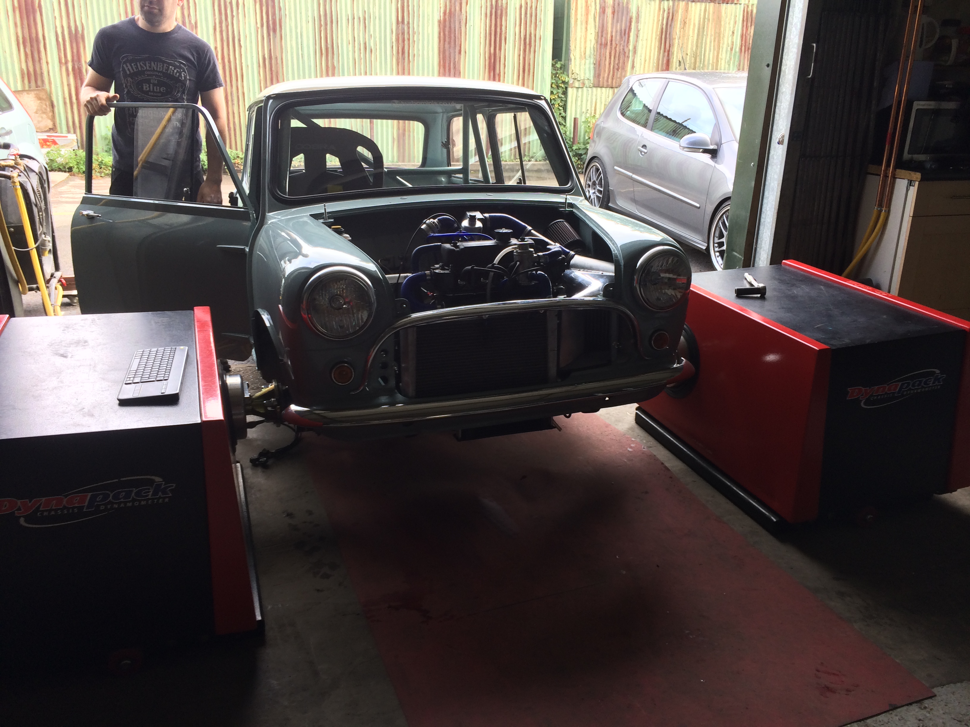

As way of an up date lads I had the car on the engine Dyno on Thursday, all was going well to the starter went man down so all fun was stopped before we could get a big power run in.
Them figs are at the wheels
Kind regards simon.
Kind regards simon.

Dynapack hub dyno....your new garage is getting cooler by the day! *happy*

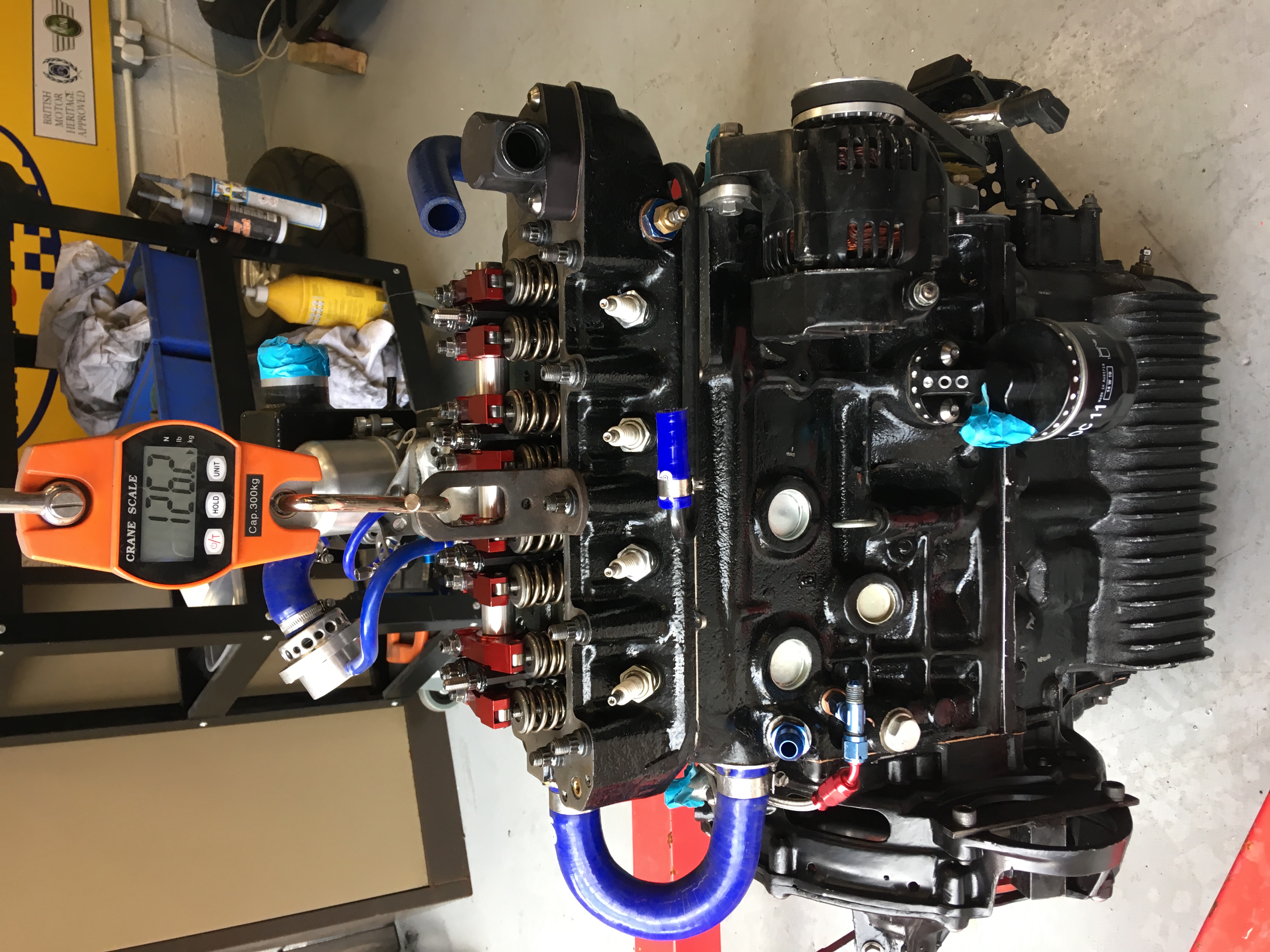

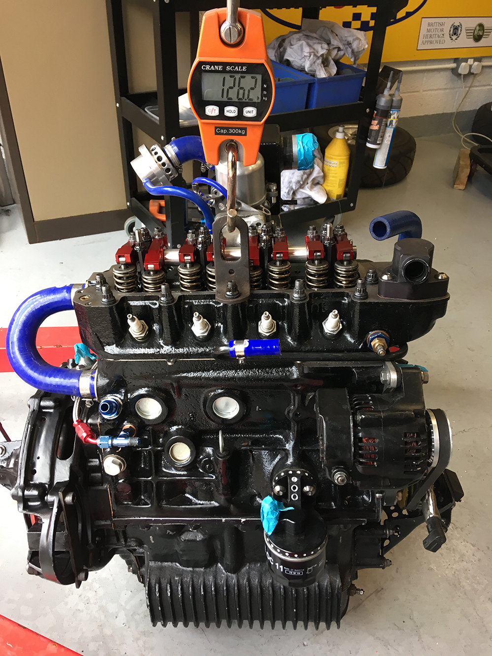

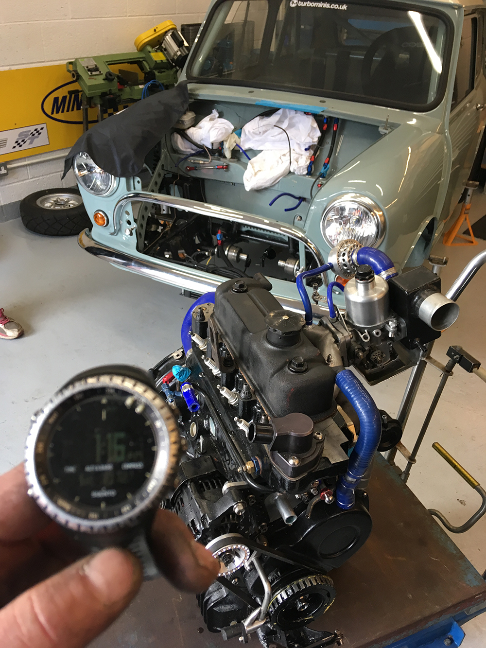

So after pissing about for days trying to work out where my oil leak was! It turned out to be the 1/2 moon seal 😑
So Engine out, and sort it out. Not the end of the world but just a pain.
The picture of the engine on the scales that’s engine, turbo, carb, oil and some water in the block. Not bad but I think it could be lots lighter, but that can wait for a wile to get looked at.

That engine weight is with the carb, turbo, oil and some water still in the block

graemec
940 Posts
Member #: 1424
Carnforth, Lancs
What’s the bit of hose between plugs 2 and 3?
The lightening of your oil filter head is very neat, must’ve taken a while!
hazpalmer
1648 Posts
Member #: 9038
Carlisle, Cumbria
Possible turbo water feed, looks like it runs around past the water pump to the back of the block

Very stealthy
Isn’t that the water hose that goes from the bottom hose to the expansion tank?
