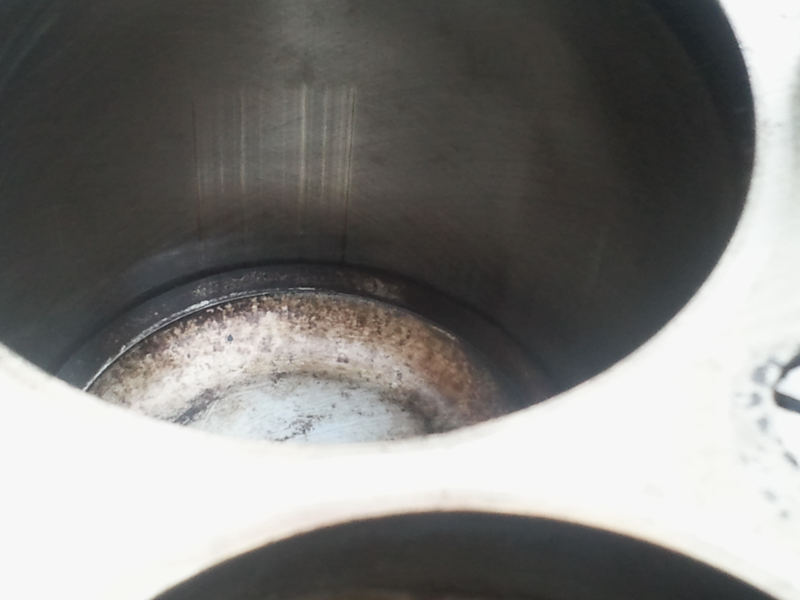

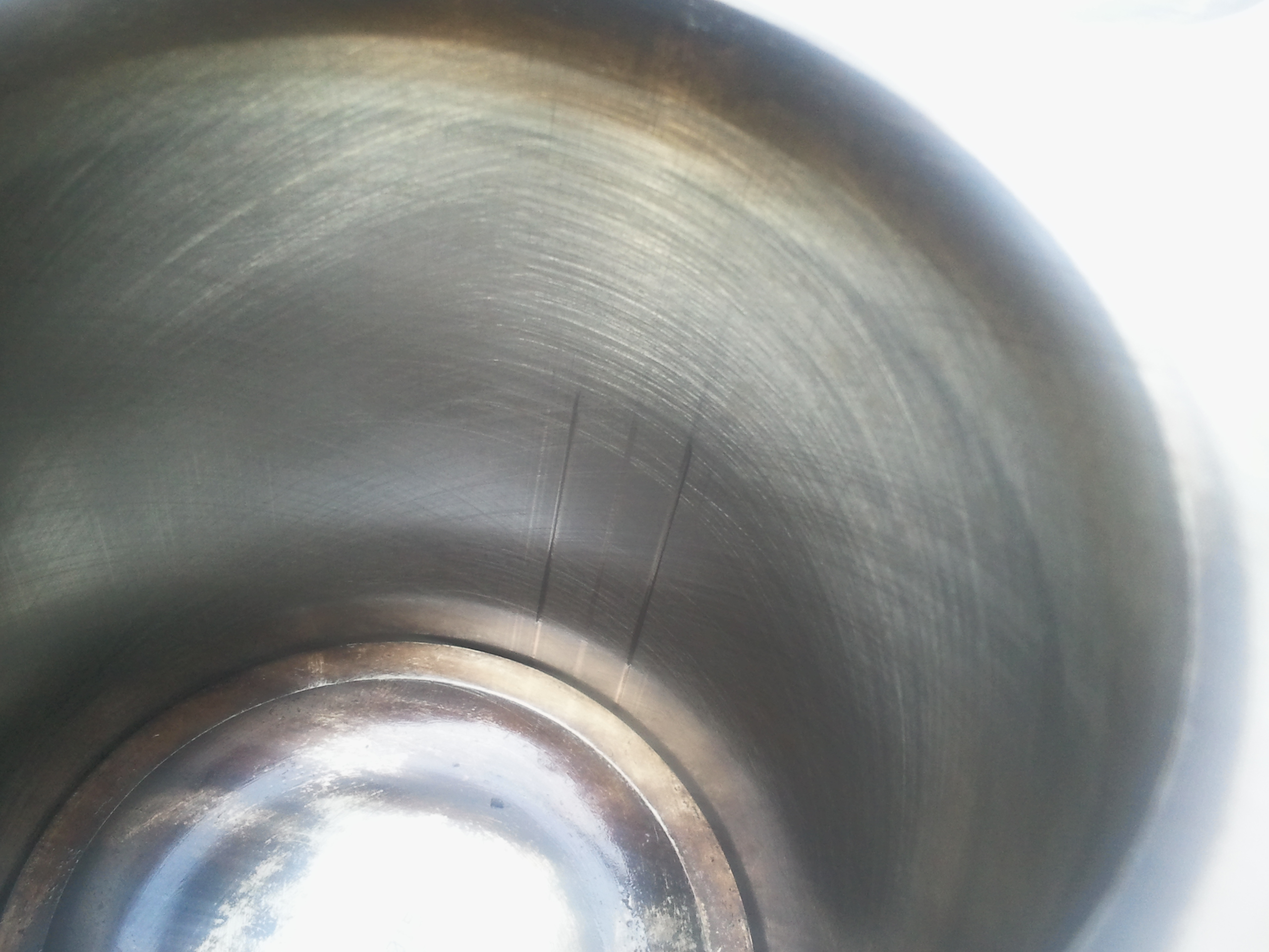

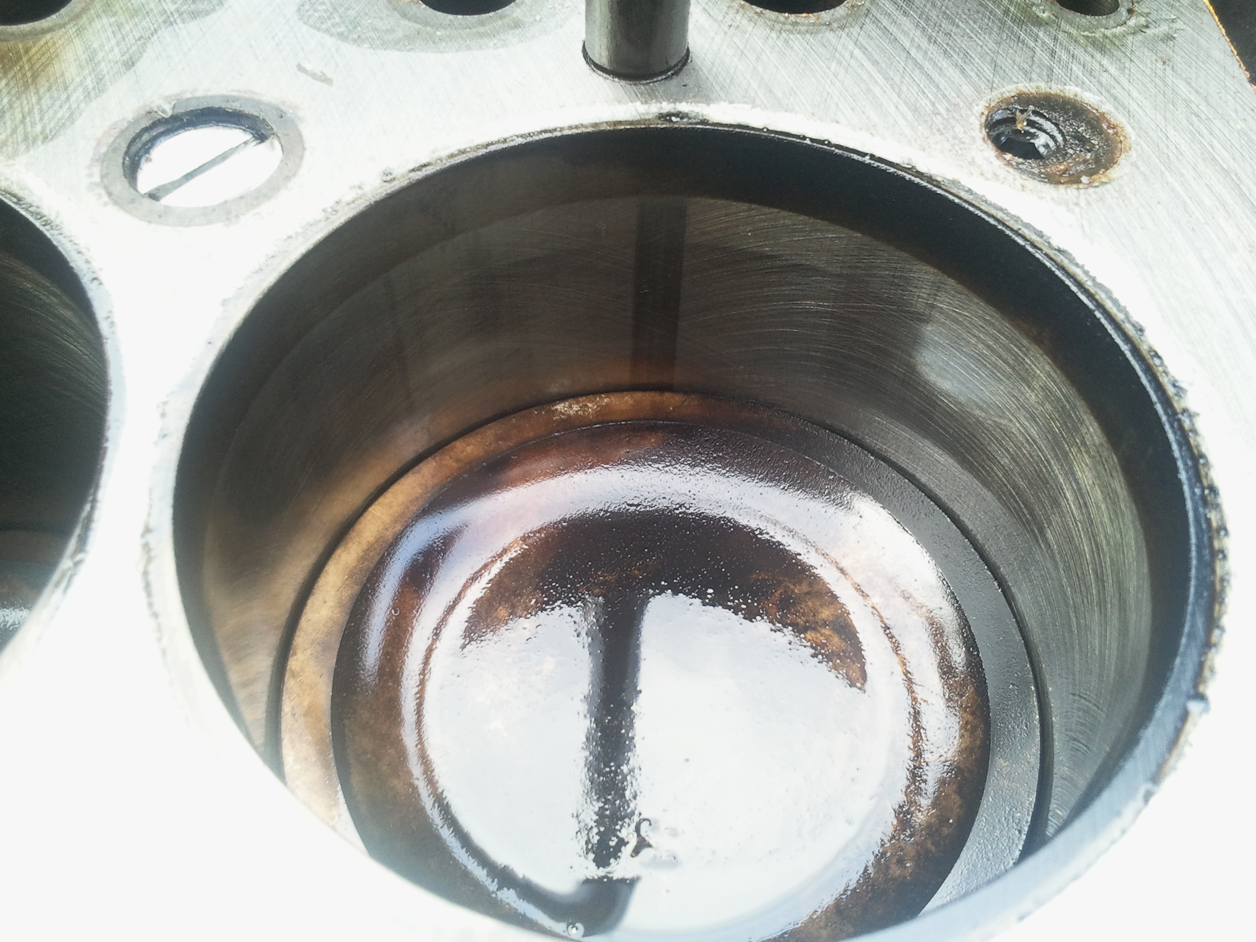

Had the head of today for a few reasons first of all i was very surprised to see the gasket still intact looked almost reusable but i resisted lol all the piston rings on no1 seem to have lined up and its leaving an oily burn mark. but on all the cylinders there is what looks like scouring it only comes half way up the bore and its not grooved its like its super polished its in line with the g-pins and mine are floating with nylon end stoppers so it must be that
