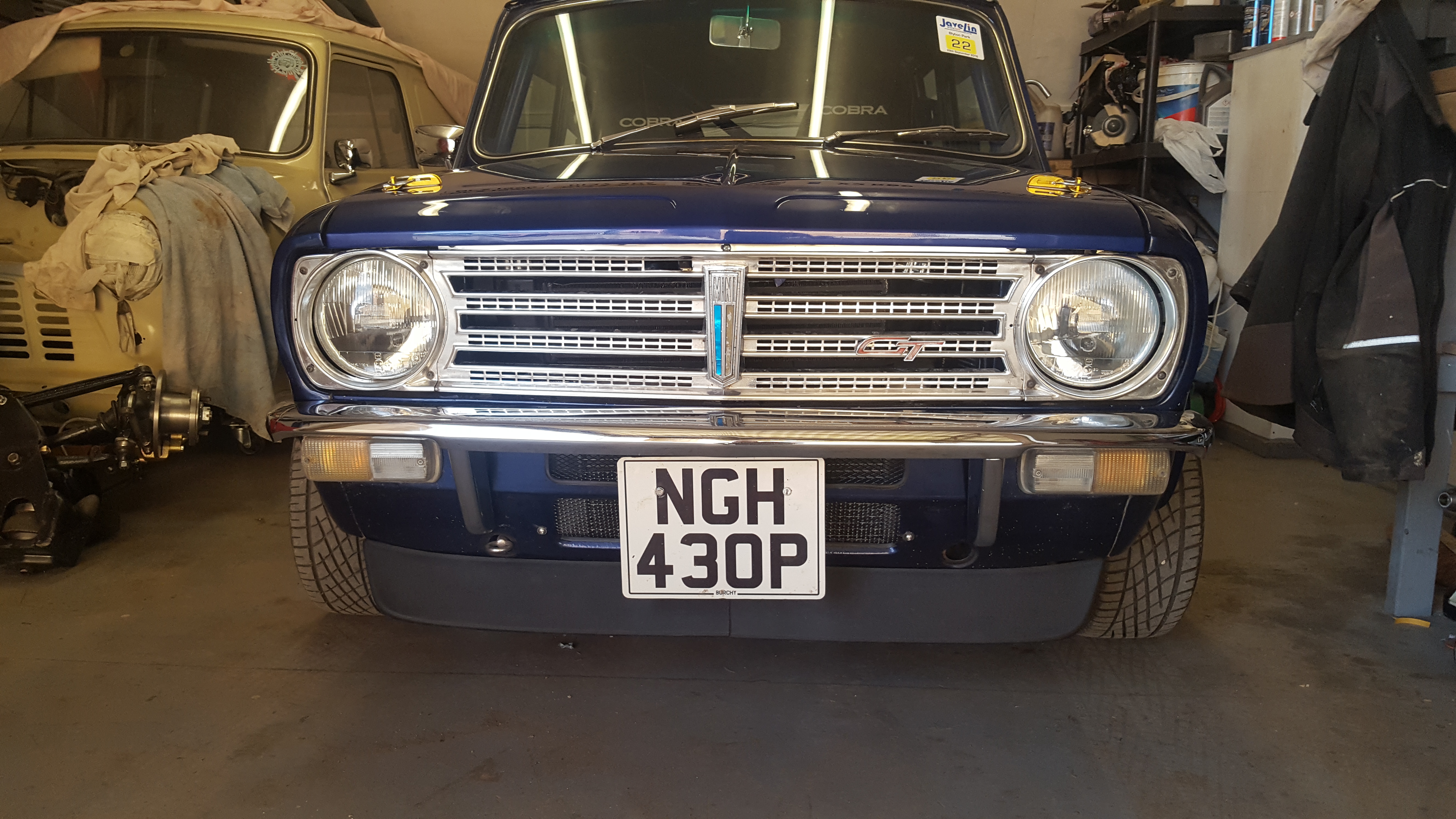

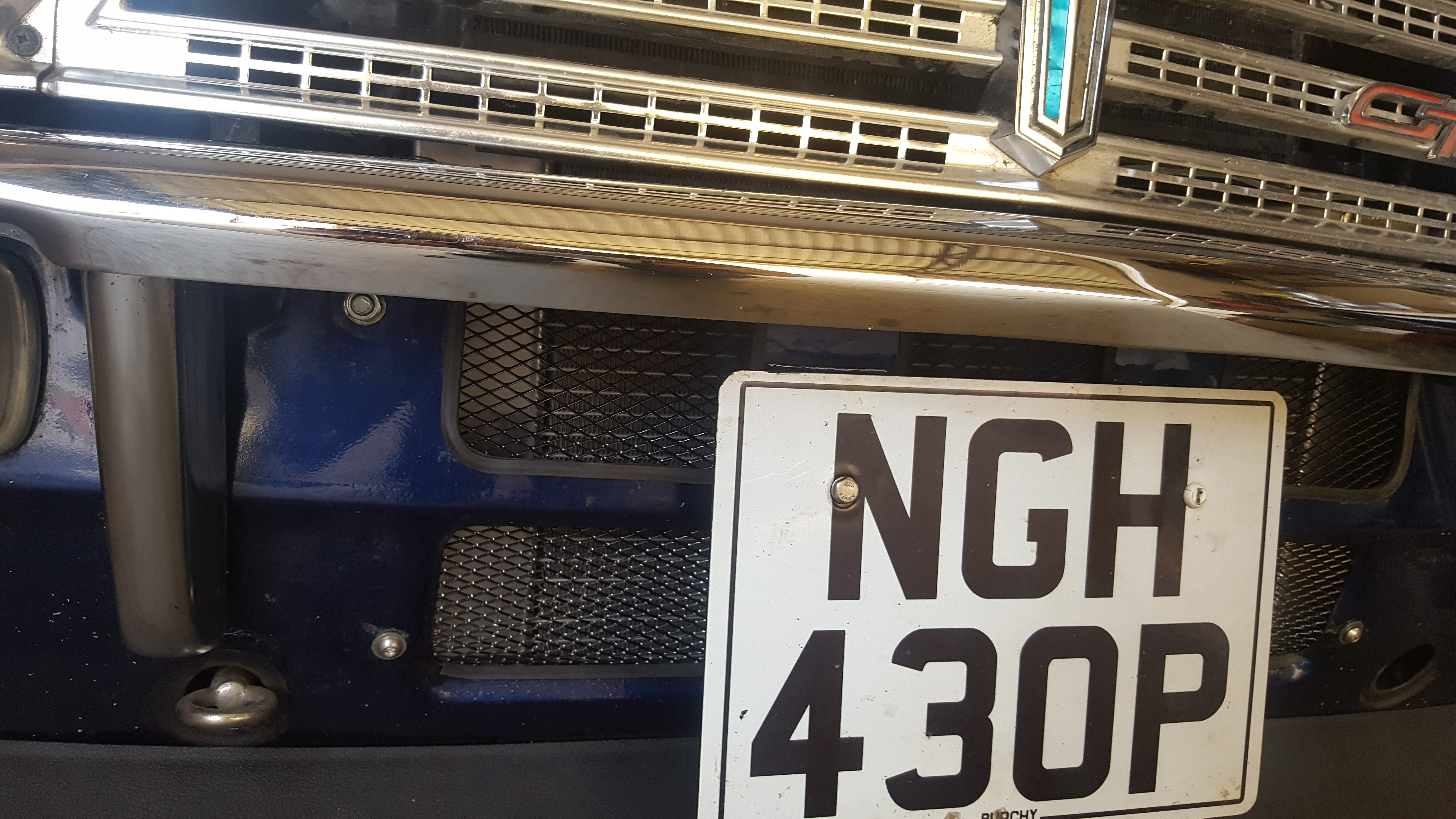

I've got a chinq rad sat on my shelf from ages ago. I'm wondering weather I should try and fit it. Only thing is, I don't want to move the number plate or lose the bumper.
Do you guys reckon I could get it to work without chopping the front about?
My build thread..
Loads of room in a clubman front. I had a metro rad in one years ago. Cut the front panel below the grille to make room. From the outside you can’t tell.
JT
2742 Posts
Member #: 637
Hertfordshire
Cheers Tom. I'll have a look.
I've currently got oil cooler and inter cooler directly behind the grille.
Would be nice to maintain them there, but I suppose I could move things about.
My build thread..

My rad fits lower than your intercooler and oil cooler does Josh. I will try and put a picture up.
burcy35
177 Posts
Member #: 10990
Hornsea
It works a treat but still a squeeze.

That looks smart burcy.
What rad are you using?
I've done a bit more research and am now tempted by a mpi rad and fit it in front of the alternator. I'll have to move the oil cooler but I'm sure I could fit that else where easily enough.
My build thread..
burcy35
177 Posts
Member #: 10990
Hornsea
I had radtec make me one up to the exact size and outlet positions that I asked for. It's really good quality. I wanted the biggest possible rad I could get to fit. I take the number plate off on track and the temps never go above 80°. It's 50mm thick plus a fan attached to the back of it.
It's very close to the starter motor.
