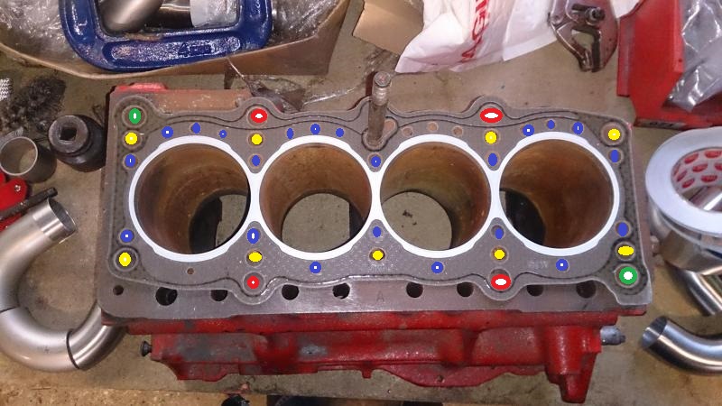

I had a chance to look over the information shared regarding this conversion. I thought I might try and get a few answers to some questions I have. (some stupid I’m sure)
Attached is a pic with the required mods to the Mini block.
Yellow- Stud positions. The center bolt also which looks to like up very conveniently. Good start!
Blue- these are the positions for the waterways to the Fiat head. If these are drilled in the block will they find the Mini water jacket ok?
Red- Oil drains from head to the block. Will using 2 of the 6 be sufficient?
Can the rear 2 be drilled through the block into the oil gallery at the back of block? Or better off running externally to the fuel pump hole.
Robert, how did you run the oil out of the head?
On the front 2 it looks like these will need to be run externally down front of block to the Dizzy hole?
Green- 2 oil drains from head to be blocked and unused.
Robert on your conversion used the Mini gasket. Is there any reason the Fiat gasket couldn’t be used saving the need for modifying the mini gasket?

interestingly , i only know the answer to one question casino , that is how did i drain the oil out , i had it running into a 5 litre oil bottle .
