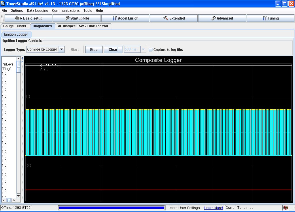

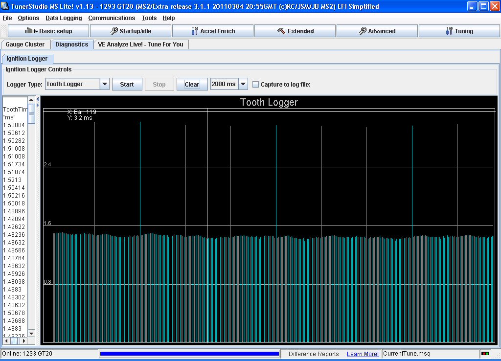

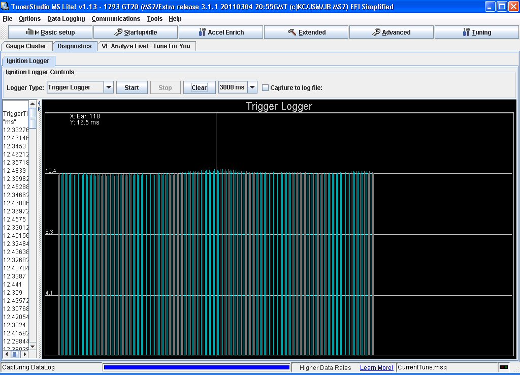

it accelerates soo fast it looses sync and misfires, but i think that is also related to the misfire on a cold start and looking at the logs its always a reason 2 ( missing tooth at wrong time)

Get some logs up on here of the sync loss and missfires!
Edit - Get some tooth logger results up as well, that will show you if there is a problem with the trigger wheel.
Edited by Carl S on 7th Feb, 2012.
trigger logs at idle
