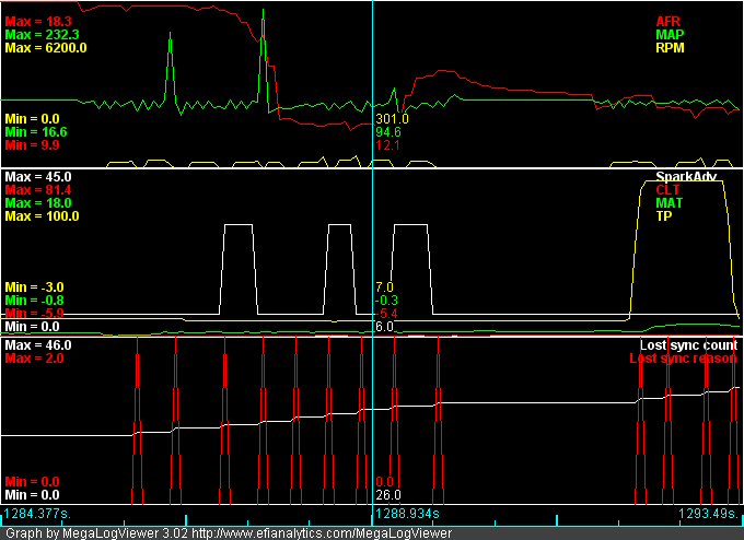

i have counted the gaps and peaks, it is counting every tooth however on he composite log it shows a few of them paired up
i spent almost an hour tweeking the the threshold and hysteresis pots (R52, R56)
made no difference to the logs
sorry for the quality of them tm wouldnt let me upload the jpegs
this is the failed starts
this was a random 4th gear pull
and the other wont upload at all :(
