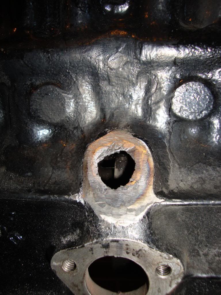

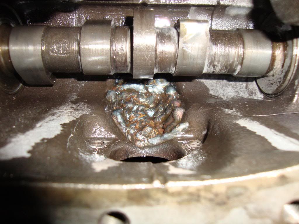

Ok then day 2 got up and before I went out to the cave I put the laptop on and went and made some breakfast and when I came in I sat a pint of coke on the sideboard next to me. Anway the rabbits had another go at the laptop lead and as I went to twat the little d##khead the coke went all over the laptop, arm chair, and the wall. So I sorted it all out and off I went to get started in the shed, and put yesterday behind me and was pissing about with the turbo to make it fit better, as I did not like the look of it. I had the worst idea ever to grind a tad off the fuel pump lump (I had removed lots before) it was all going so well and then I saw a crack so I give it a tap with a hammer and this is what I ended up with!!
So at the min I have welded it up with my mig, a bit at a time with lots of heat
So now I am in 2 minds whether it would work or do I need a new block? Has anyone welded a block before with a Mig? I dont like cutting corners.

i didnt think mig attaches to cast iron, but that looks pretty well stuck on.
I think I would give it som test taps with a hammer and if it stays put i'd go with it,
also its worth a spray of wd 40 on the inside so see if there are any fissures that will leak oil,
one other thing, wheck the cam and followers for weld spatter if they were in when you welded.

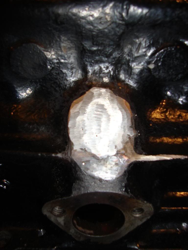

Its been a mad week getting back on track with the eng. I got the block welded up in the end after tracking down the tig welding rods for cast that I needed for the block, which was fun*surprised*.
