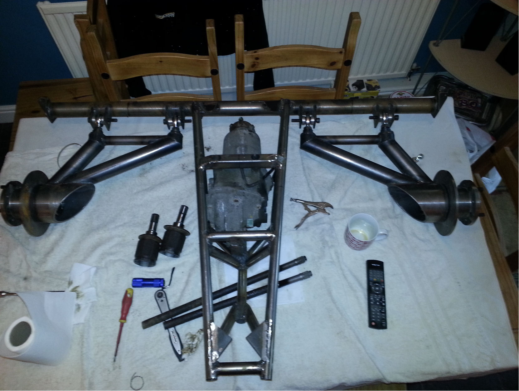

Took around 50kg out of the car today....
Although there's is some to go back in.
4310 Posts
What did that weigh out of interest?
Didn't weigh it. I struggled to move it to be honest.
I did a bit of searching and it apparently weighs around 53kg.
Light stuff will replace it.
Weights are...
Subframe with arms/trunnions etc 28.5kg
Hi lo, cone and knuckle 2kg x2
Hub with bearings/grease 1.6kg x2
That's 35.7kg without brakes.

It was all nice and clean. Fiancé was sat on the sofa next to me while I was putting it together.
She's pretty chilled about stuff like this. Not sure she'd be so relaxed about a complete car in the living room though. Our house is too small for that anyway.

It's fairly light. I've not weighed everything so couldn't give an accurate number.
I have to say, the MS ally beam is not a great fit.
1. The area that is cut out fir the boot floor is about 40mm too narrow.
2. The poor design means that the beam must be fitted to the car before any of the brackets. These are then very fiddly to fit upside down under the car with a built u a hanging off one end.
3. The camber brackets are not great either. The nut which holds the radius arm pin fouls the adjuster. The weld needs dressing back a fair bit.
4. The wheelbase is now 12mm longer as the beam pushes the arms back. This is a fairly large problem on my car, where the wheel arches have been fitted quite far forward to start with.
On a positive note, it's light.
As illustrated here...
you need to take som measurements and get somone to make a better version and then sell it for significantly less than the MS one...
Just saying...
