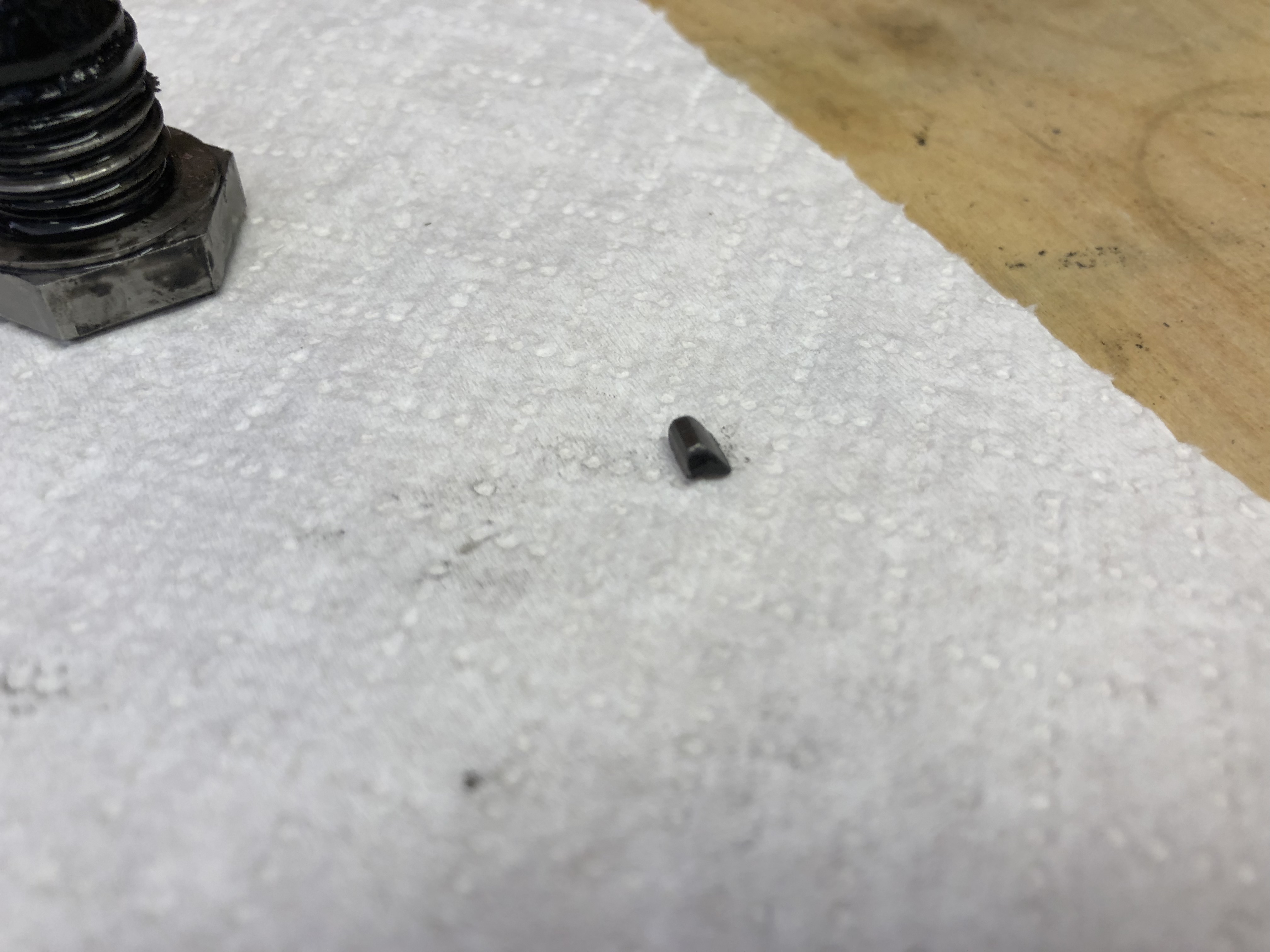

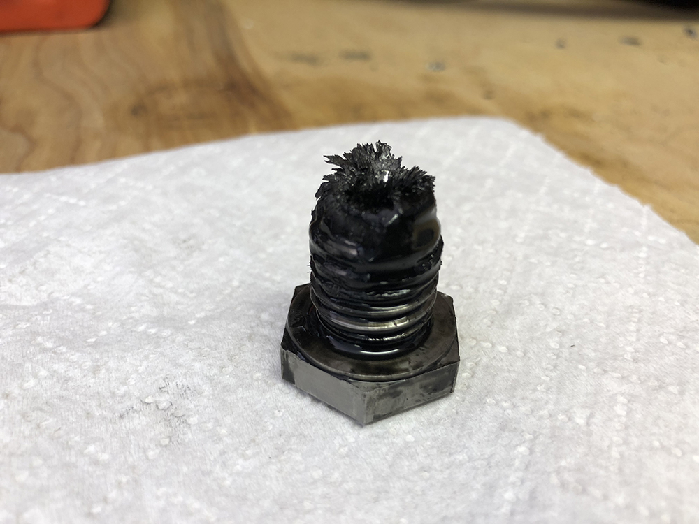

Ok cock, was doing some basic checks and I started the car and it smoked a bit. I warmed it up a little and then changed the oil and found a chunk of tooth and a fury sump plug ☹️
jonny f
2096 Posts
Member #: 9894
Dorking
What’s the tooth? Looks like a synchro one, can’t remember the technical term!
