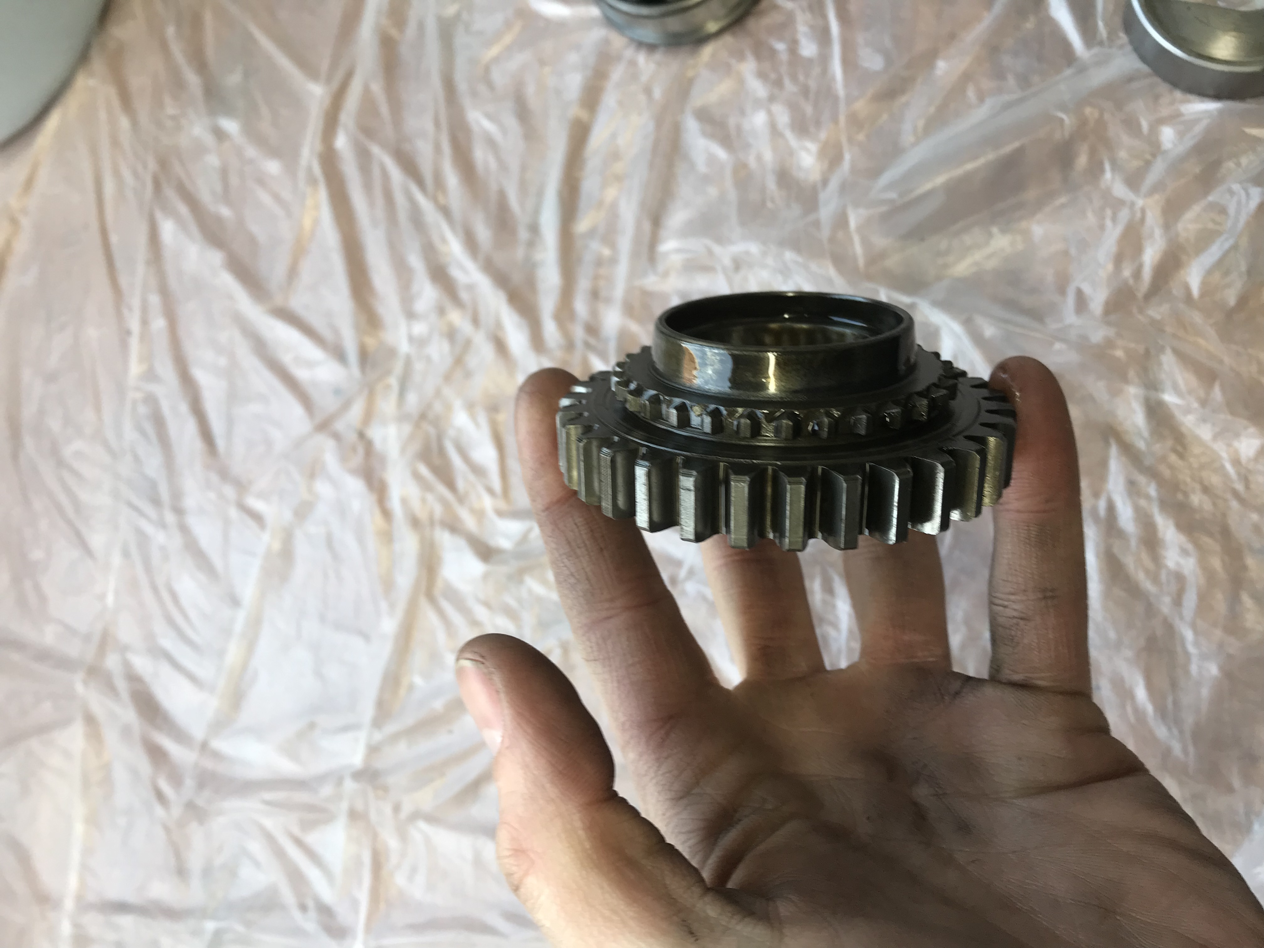

Ok I've almost stripped both my boxes down to rebuild my sc box into the spare casing. Just waiting for my new set of circlip pliers to arrive to remove the main shaft.
Now I've found this...
Not sure if you can see but where my screwdriver is pointing there's 2 teeth missing which I kind of new about from a oil change the other year.
Anyway what part is it? And would I be able to replace it when I have it removed? Bearing in mind it's a jacknight gear set.

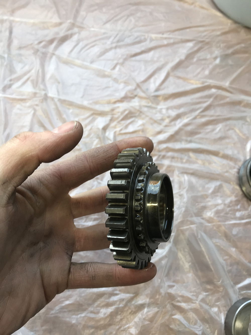

The tooth chipped is one of the first gear synchro Drive dogs, it’s what engages / gives Drive with the first / sencond syncro hub when in 1st gear.
To replace it would be a new/replacement first gear.
Attached image is the gear out of the box.
Shane

I see. I'll just use it as it is then.
Unless I find a jacknight first gear which I doubt I will.

With the Jack Knight gearsets , do they have their specific own first gear or do they utilise a standard first like the minispares clubman kits?
Shane
If you had no engagement issues with first just use it as is.

Think it's a complete different gear as it's longer than standard.
It engages fine to be honest.
I bought it never used second hand already built about 11 years ago! Lol I'll use it till it's completely knackered. Then buy a different gear set that's got spares available.
