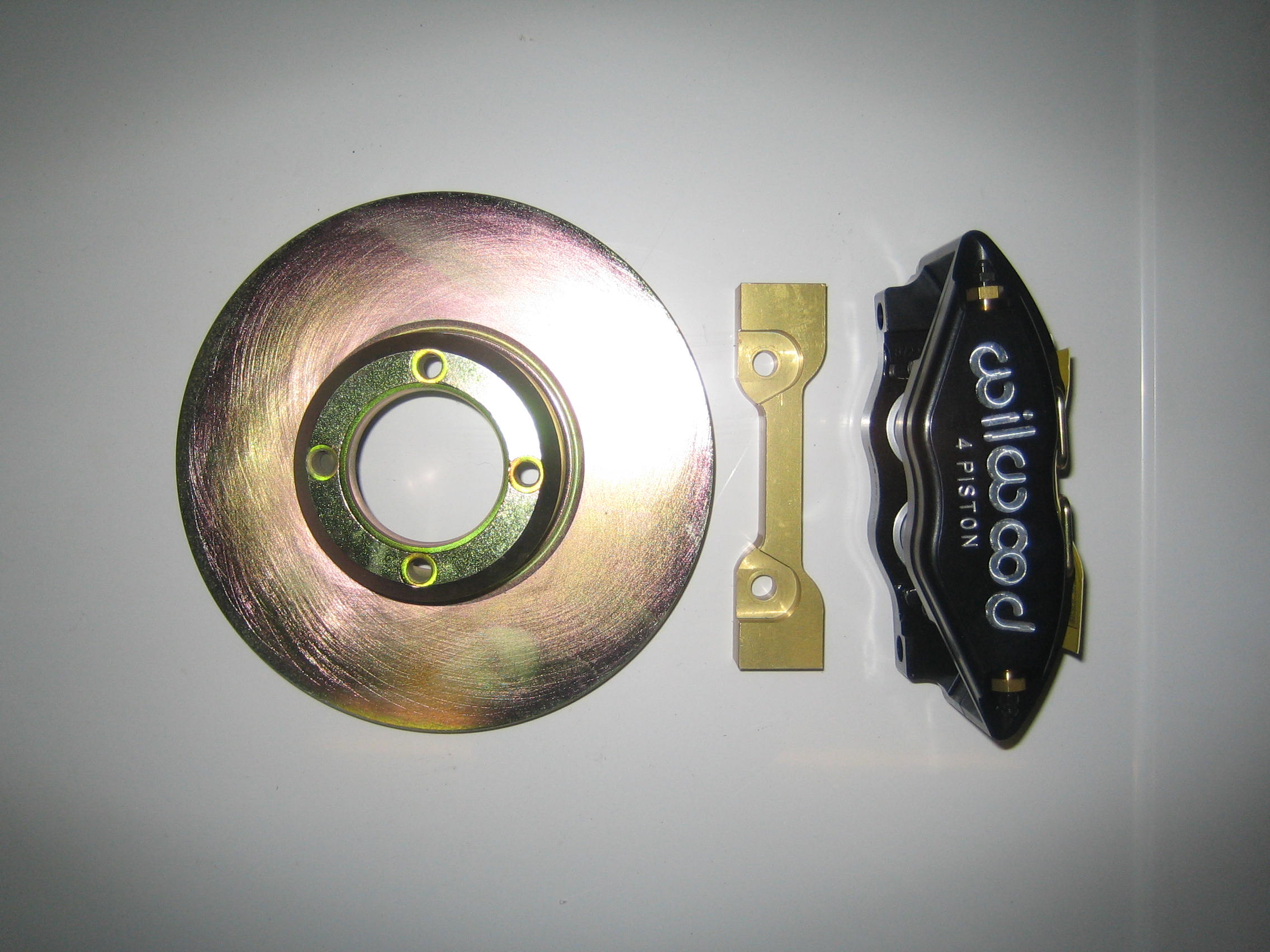

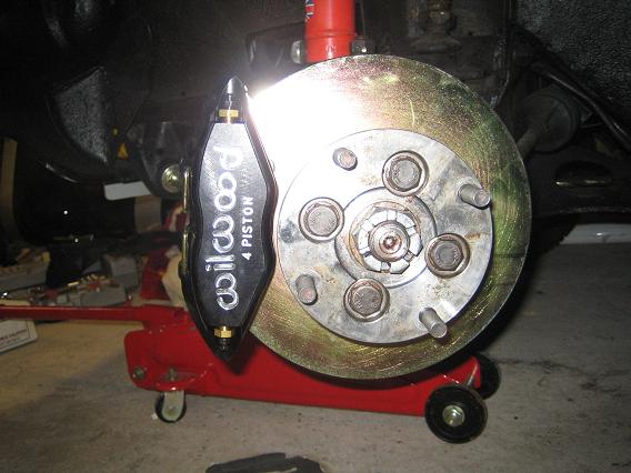

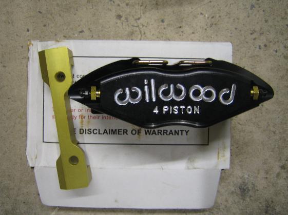

Sorry i forgot to get some pics up earlier. Here are a few i took when i first fitted the Wilwoods. The mounts were supplied by Z-cars.
Reading on from above Mine dont have dust seals though as they are really intended for race use but mine never see any shite weather or salt anyway.
Nice breaks, did they fit under 10" wheels?
Not sure, but i doubt they would, i can borrow a 10" wheel and try it this weekend if your intrested.
thanks Andy,
looks like they are the smaller powerlite caliper, but if Z cars use those they may have brackets to fit mine, i'll get in touch with them and see.

Probably worthwhile as they made mine to suit my hub/caliper/drive flange assembly and they were a perfect fit.
just pooed them an email,
Cheers again Andy, had no idea they did wilwood kits.
Had a measure up and stuff of the wilwoods i have, and started to make the caliper mounts....
there no way they are going under 10's LOL the smallest disc they are going to go on is about 8.7" on the mini hubs so have ordered some 10.5's, (looks like i'll be sticking woth 13's)
anyway, here is one of the mounts, not got the caliper bolt holes in yet, need to double check before drilling them.
