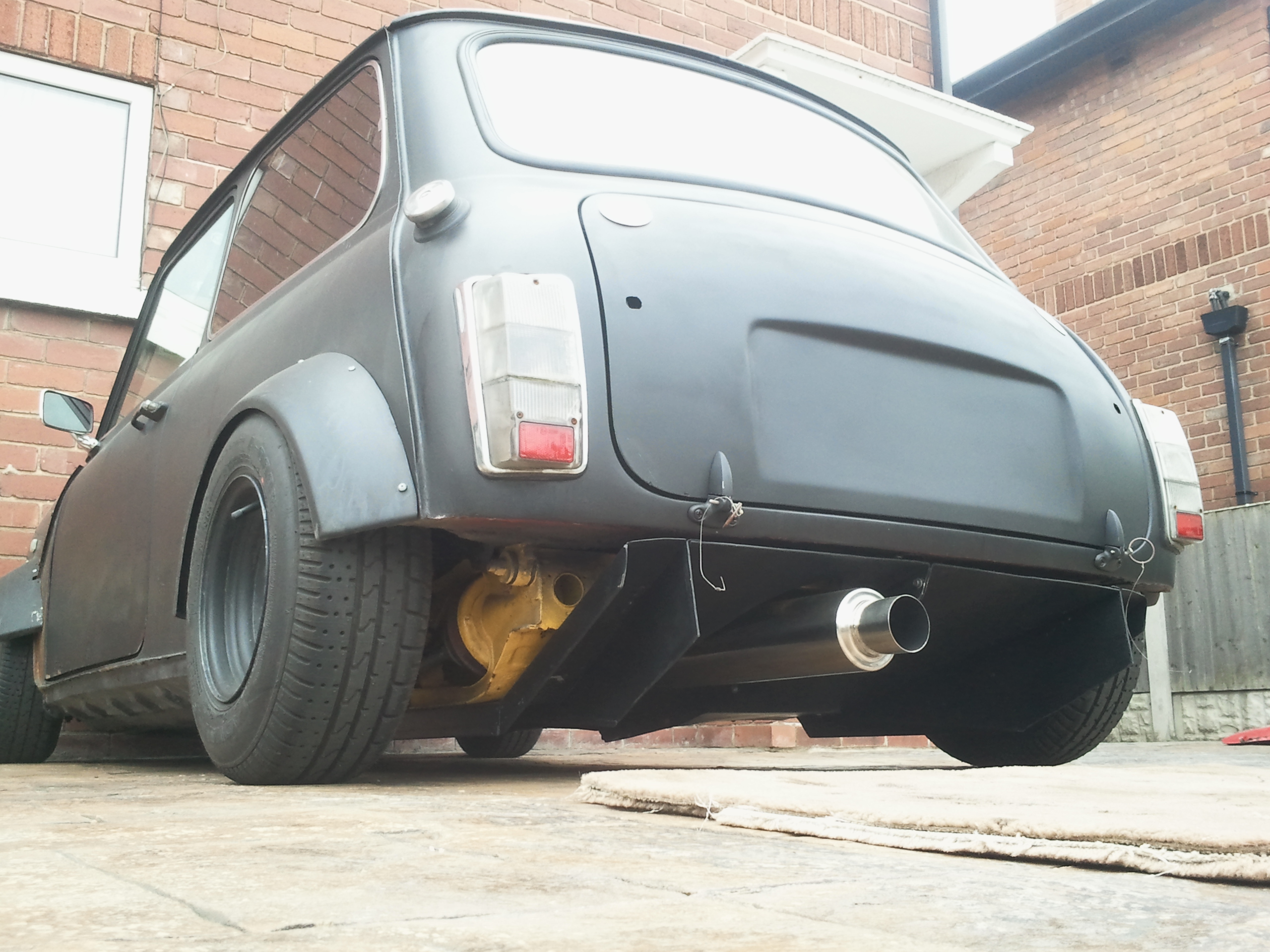

Reminds me of the V8 Interceptor in Madmax.

Stealthy. I'm guessing rust isn't lighter than CF

stealth is the theme im trying hard to keep *happy*
at the speed it was rusting the steel lid will probably be lighter by christmas
looks nice Brett.

You've covered your rear plate but not front. Dodging speed cameras?
its for towing mate, never bothered with front one, cant really see it

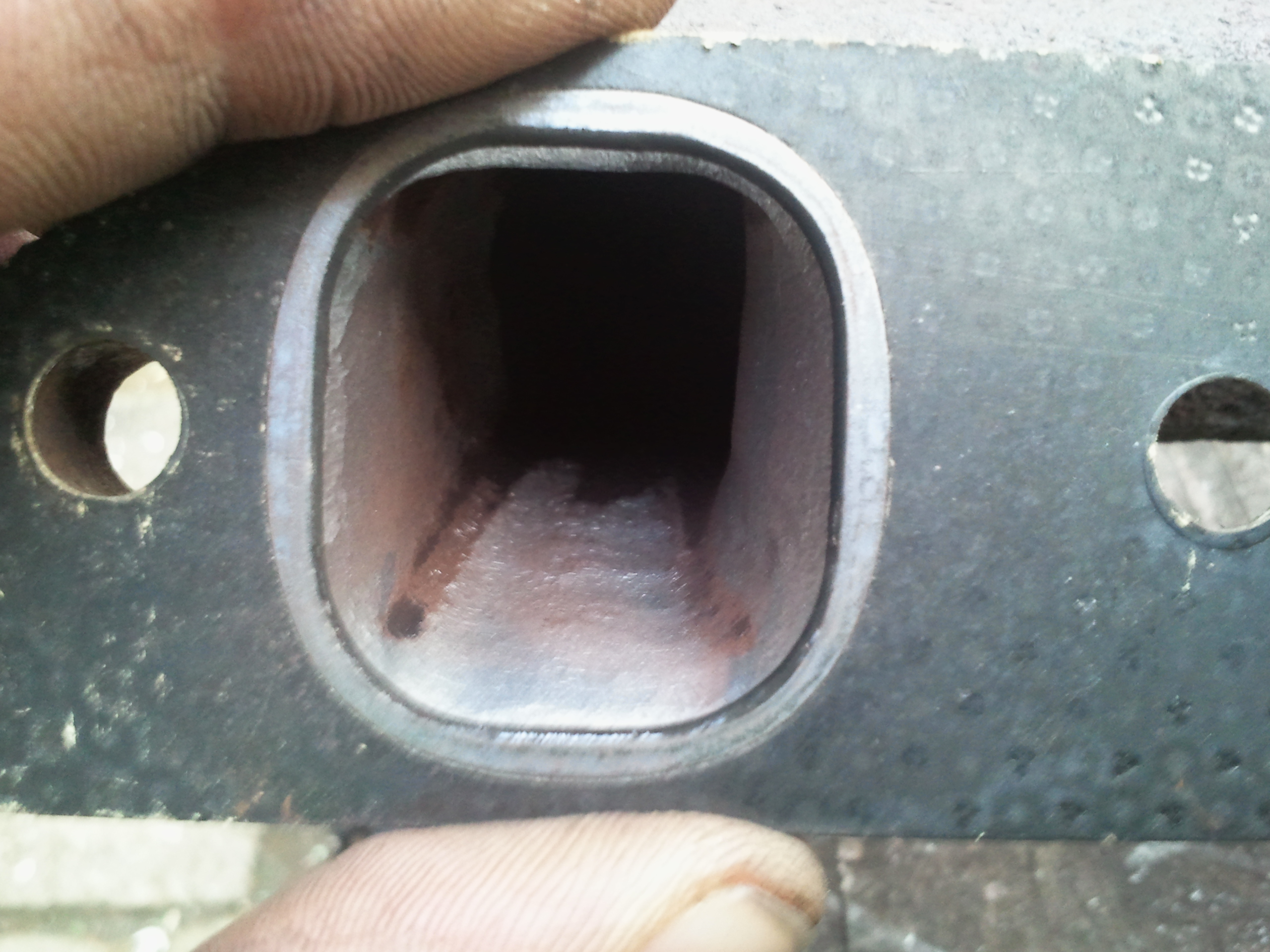

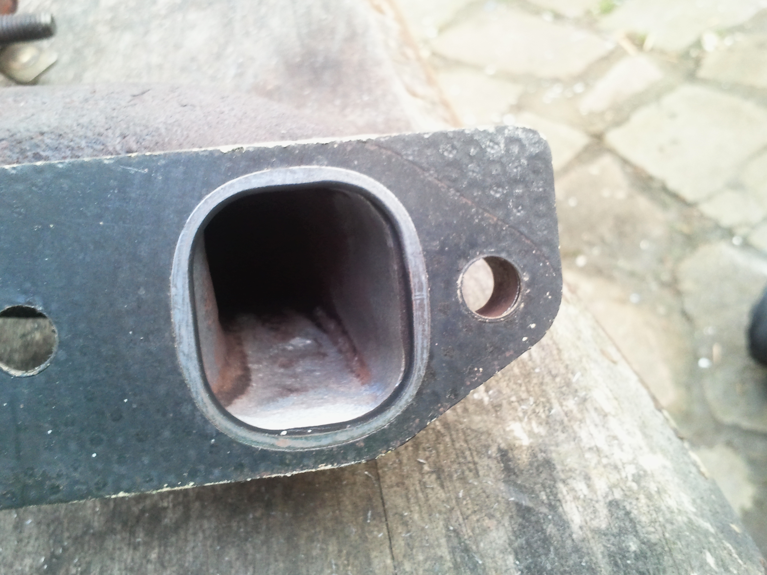

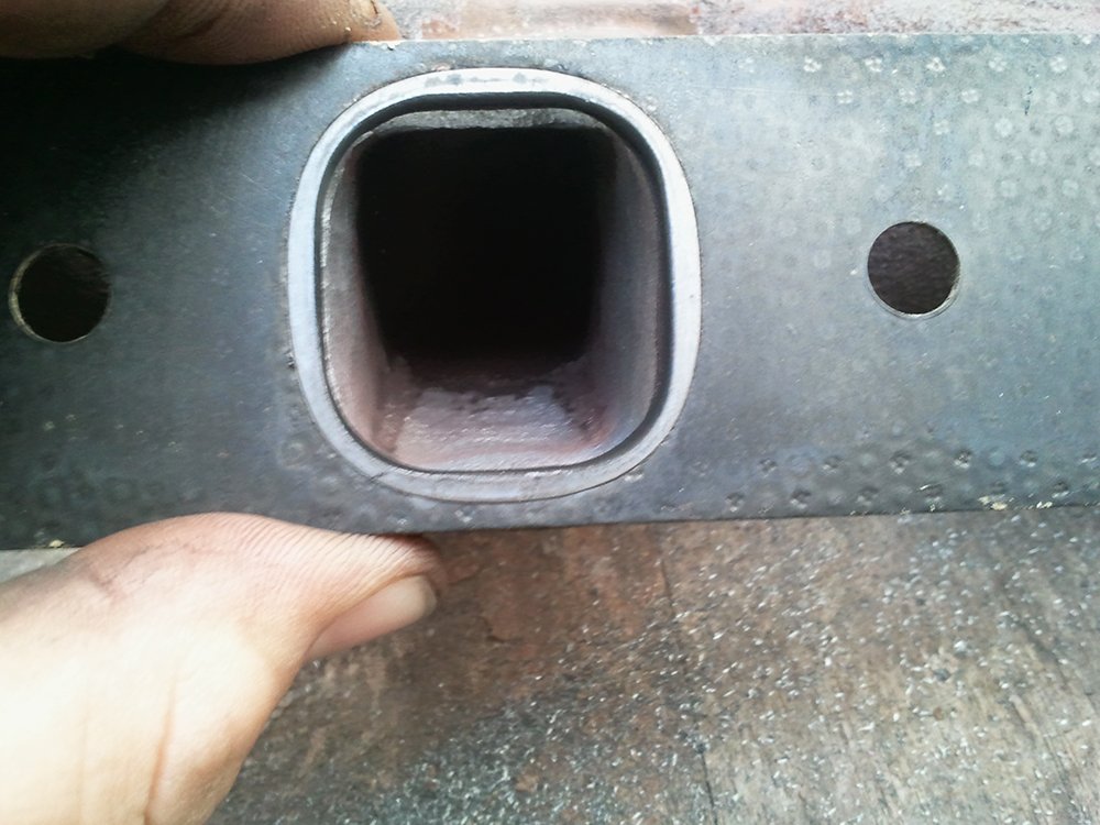

and whilst i was there not a full port job but opened up the manifold to the gasket line and blended it back up the manifold, the collector has already been done and the dividers cut back ages ago

nice porting

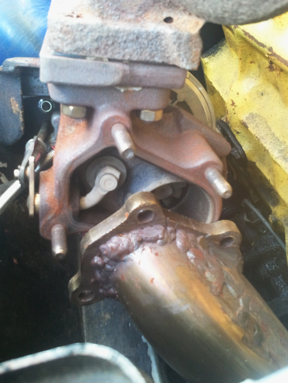

yeah worked better than expected i can hold as little as 3psi up to 6k.. after that is uncharted territory *happy*
