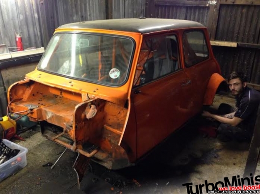

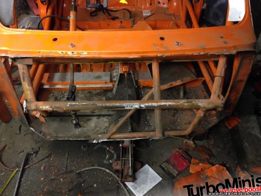

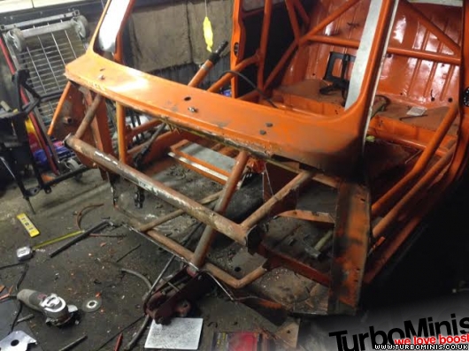

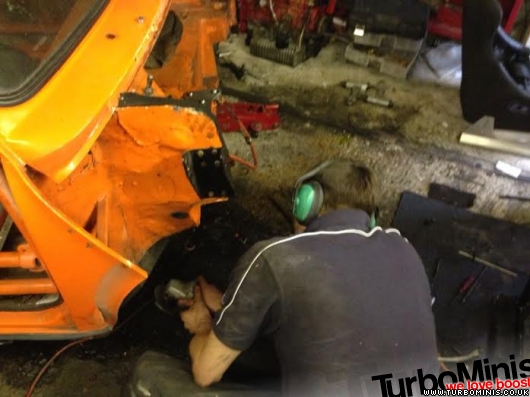

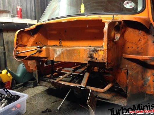

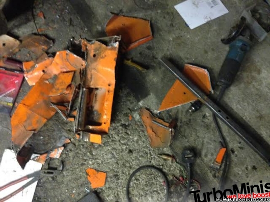

Right, been away for a while, Had my first Kiddy Myles and hes a cracker. But he also requires 24-7 attention haha so its been a bit slow in the tin shed of doom.
However this year Ive decided to take the Tangerine in a different direction and give it major overhaul, the body will stay the same, miglia style same colour, but the underside will be changing massively.
Ill be making some huge changes to the chassis and suspension. Itll also be getting a new heart, something rather interesting and not something thats really been seen before. Those of you who know what it is keep shtum!!!
I tried to keep it quiet from everyone but the engine isnt exactly a packet of peanuts so I could really hide it.
Heres to pics of my current progress. I can already hear Carl and the Fentonator sighing with the thought of the work ill bringing them haha.
