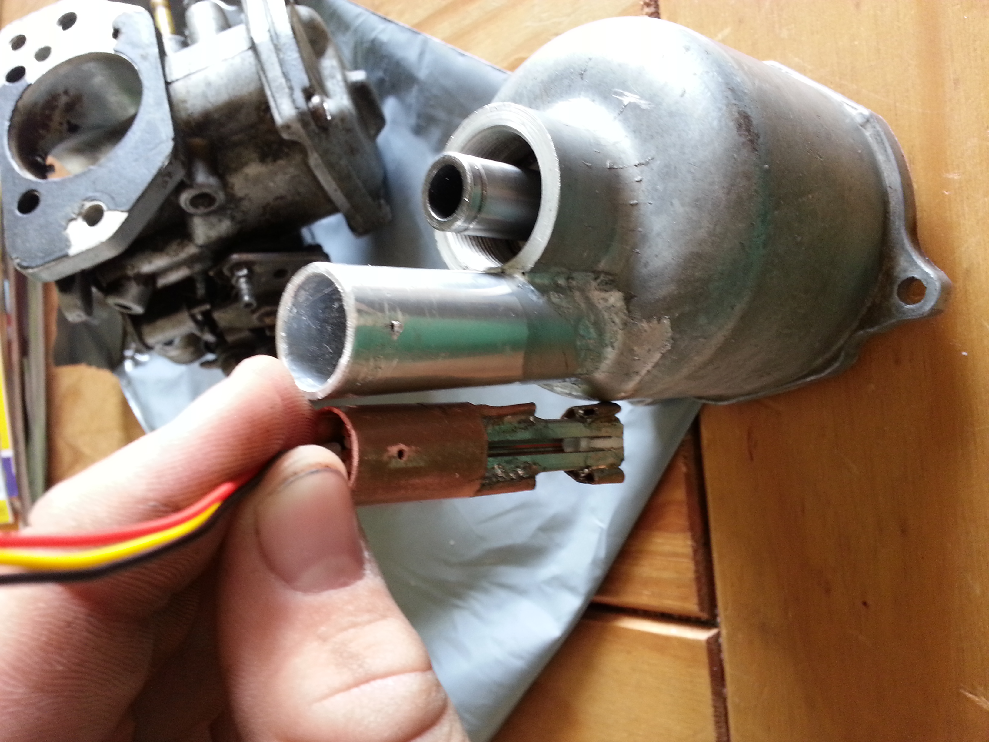

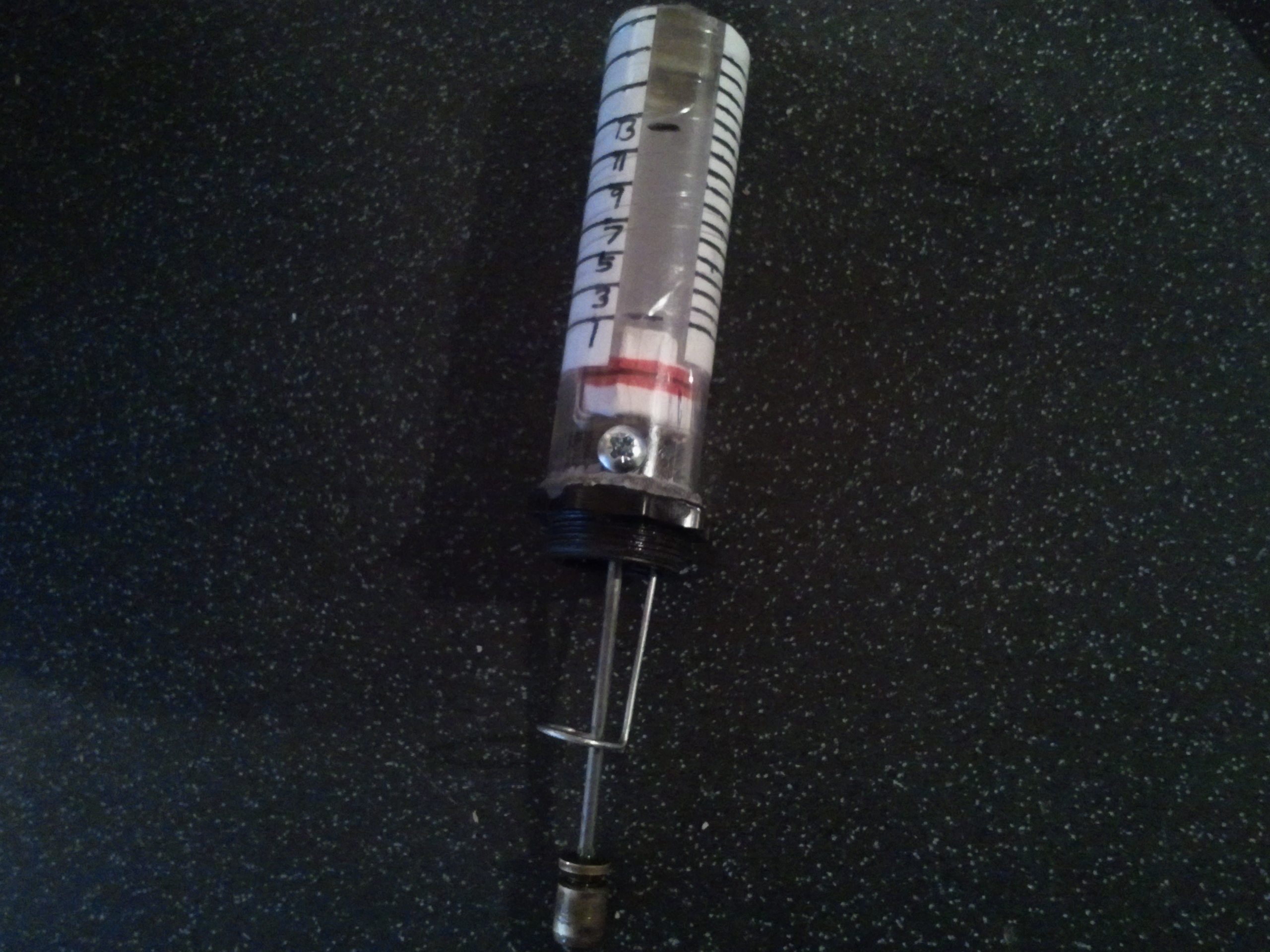

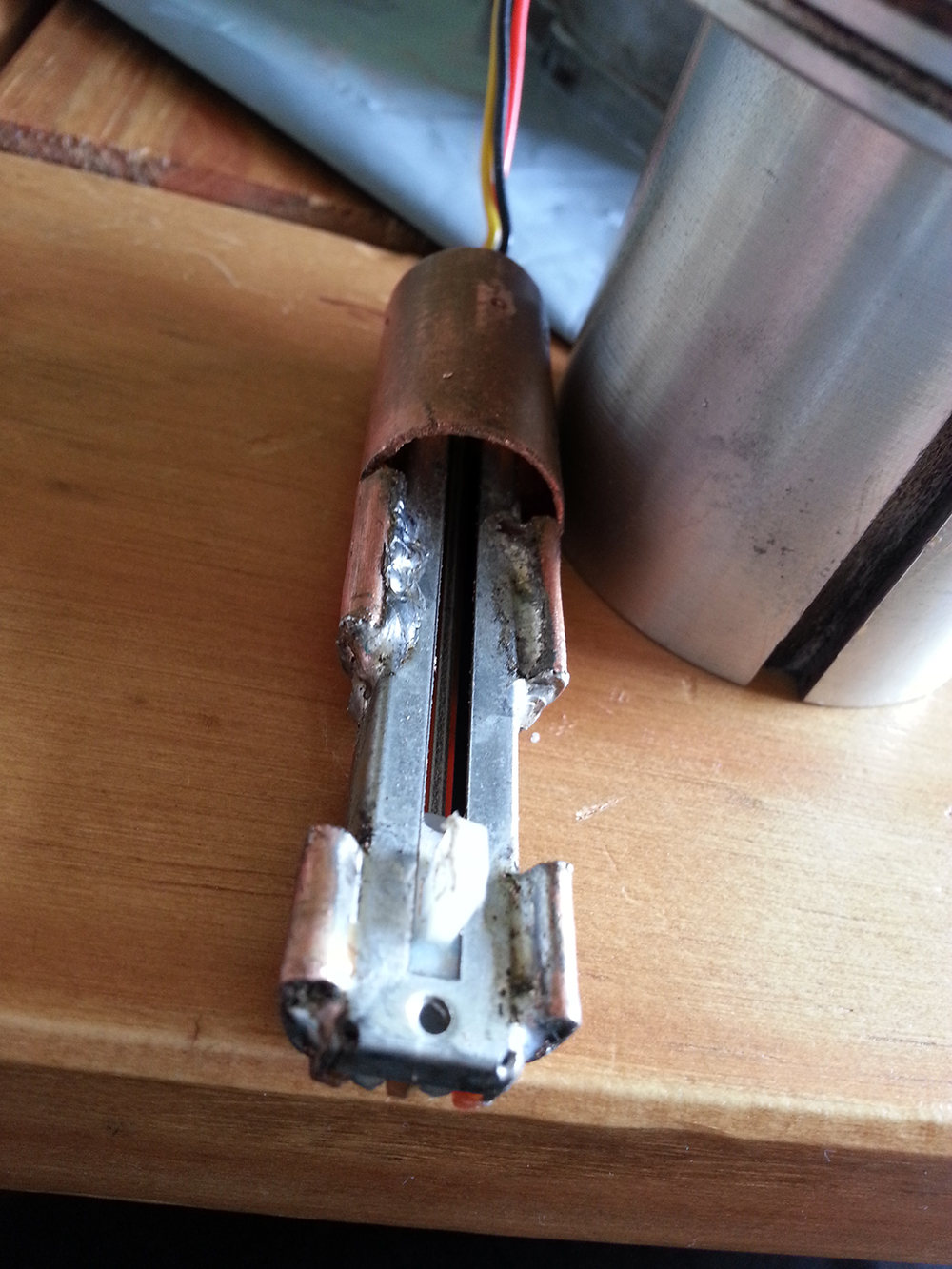

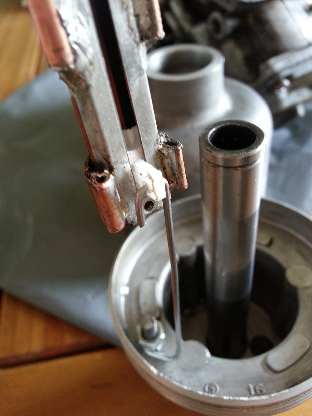

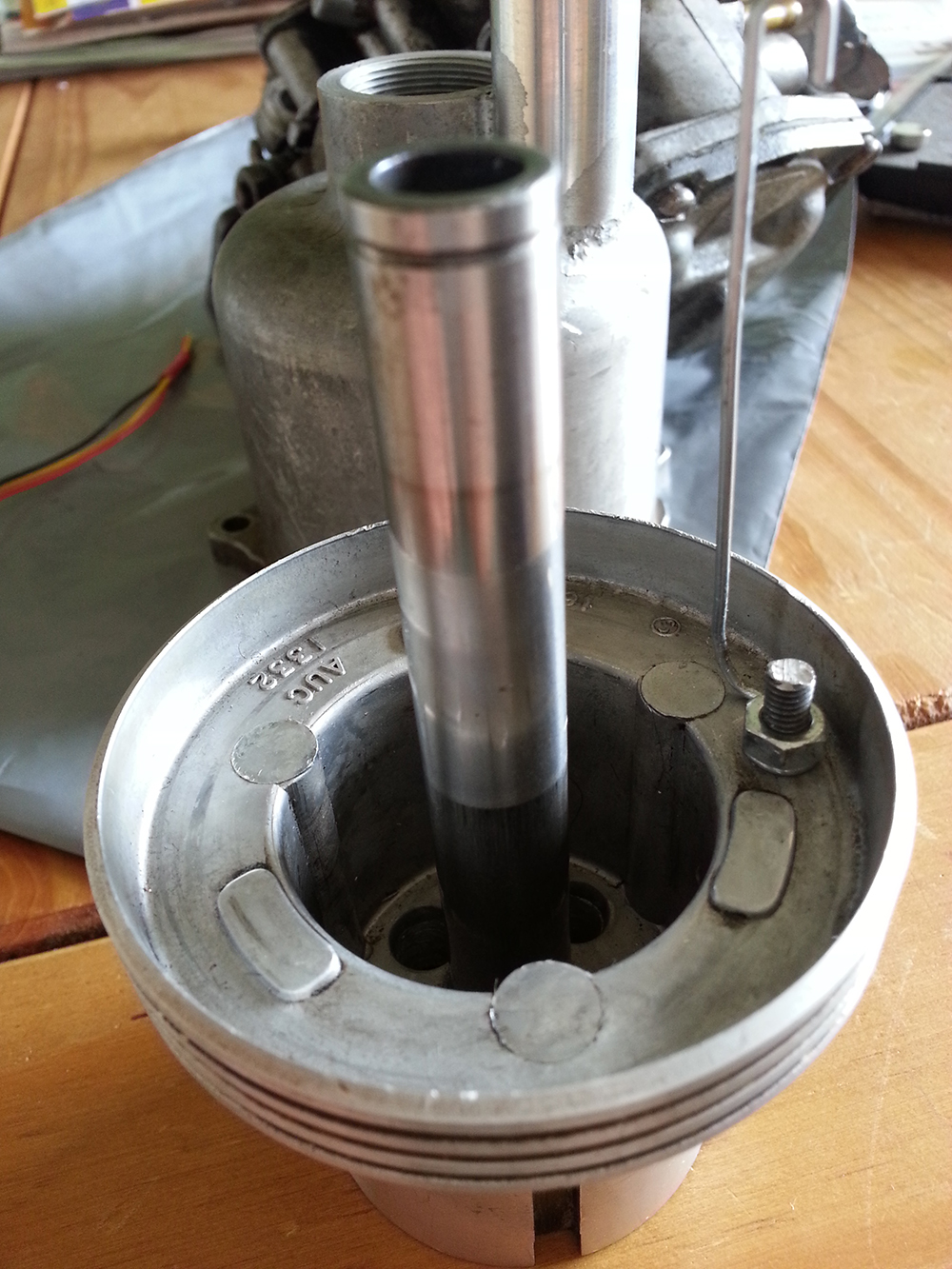

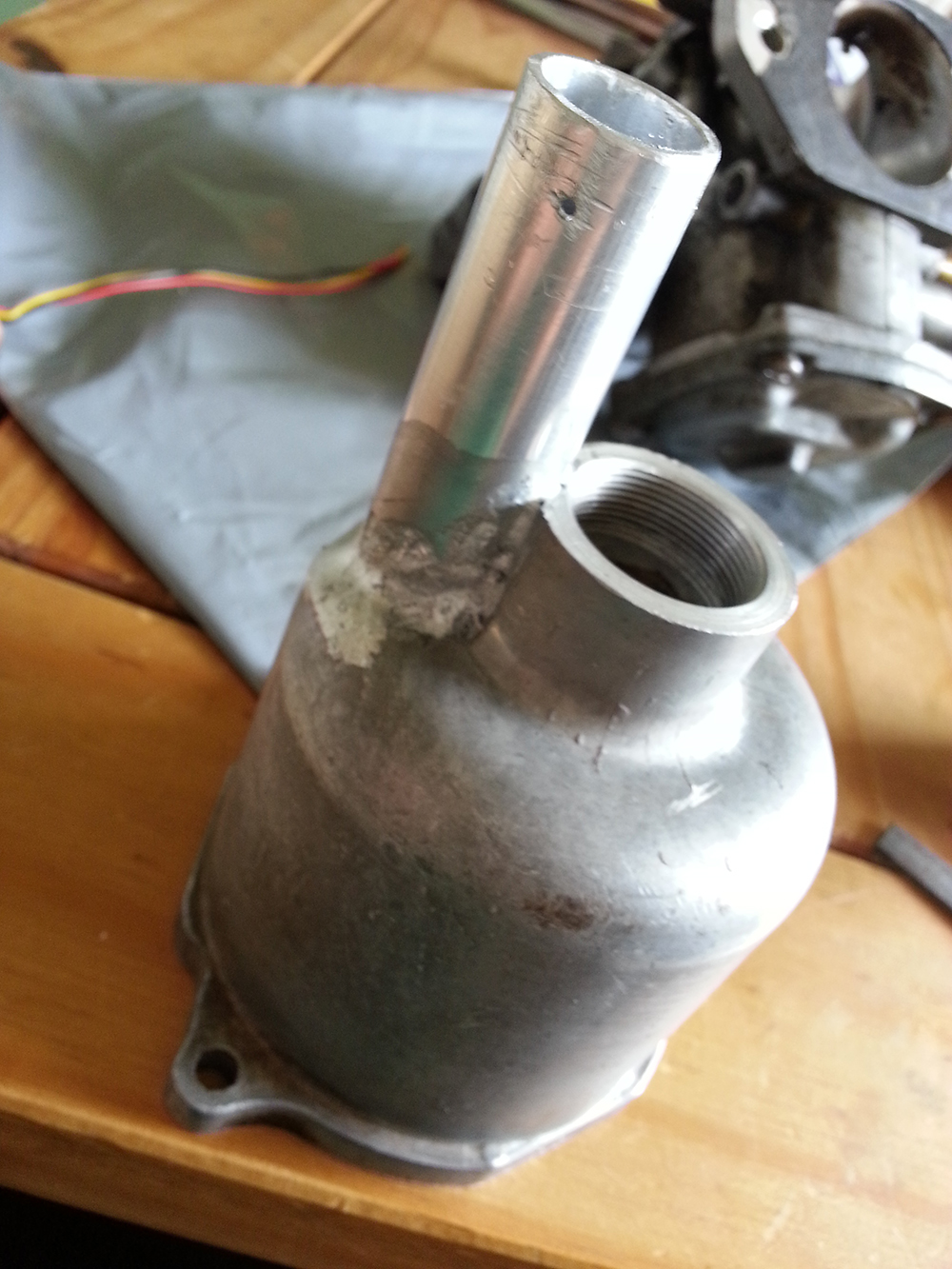

Love your positionometer thing on the tube. Care to share a bit more?
1978 Clubman (soon to be S)
2011 Countryman Cooper

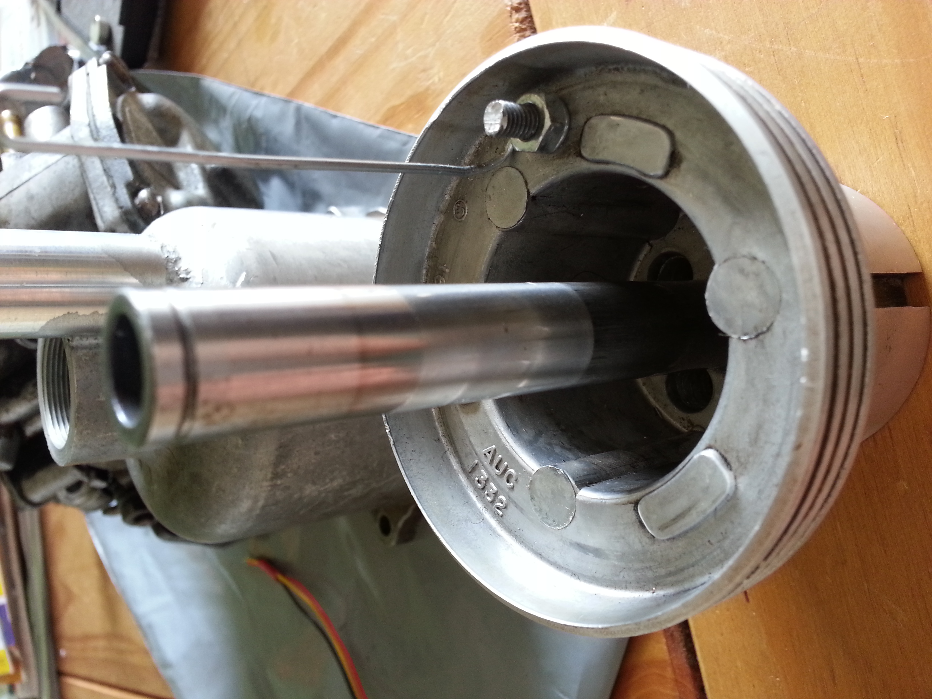

which one mate, the visual one? or the electronic one?
Edited by Brett on 19th Sep, 2013.
i did build a 3rd design
Logtastic!

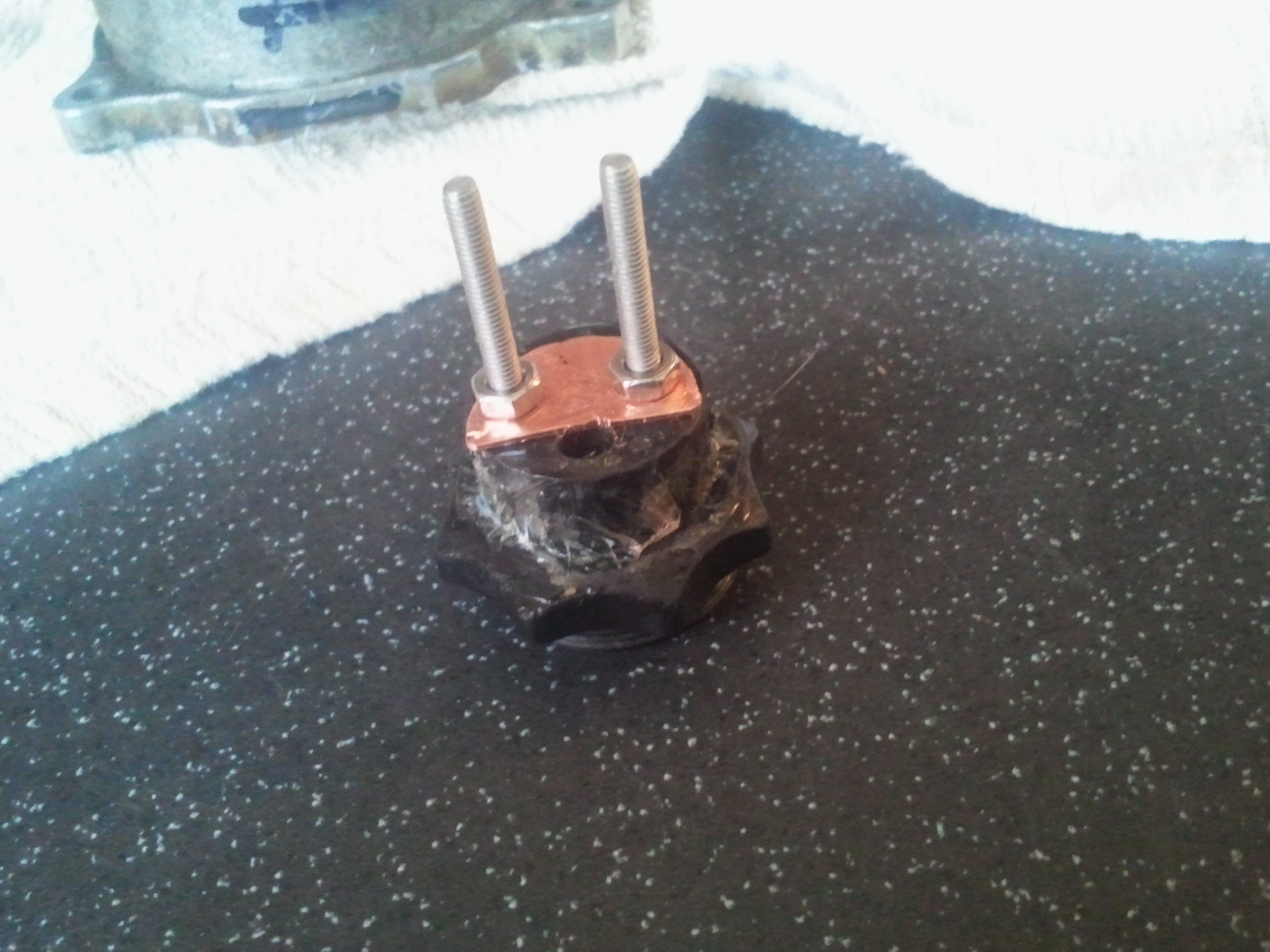

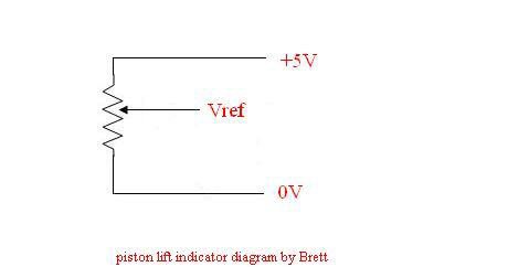

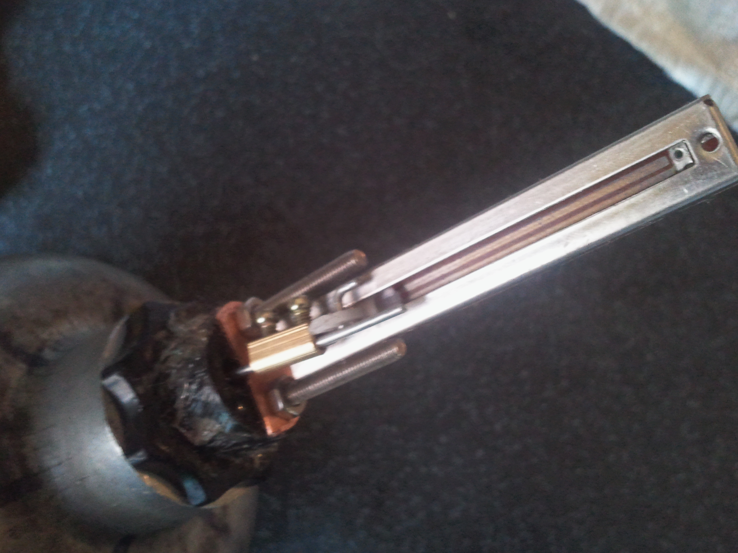

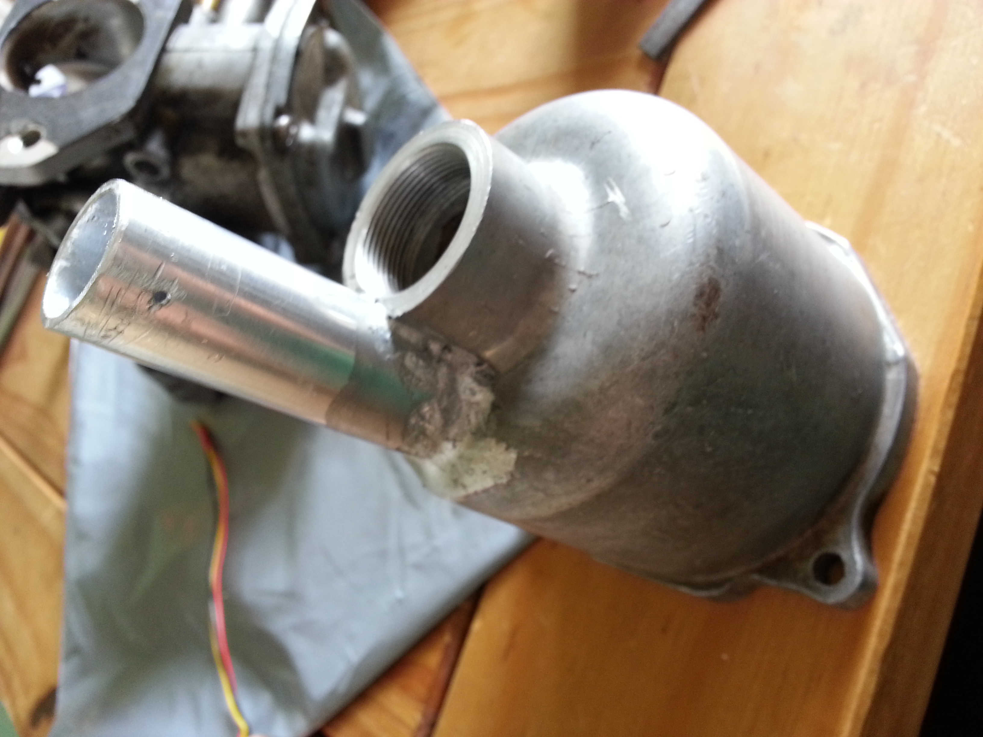

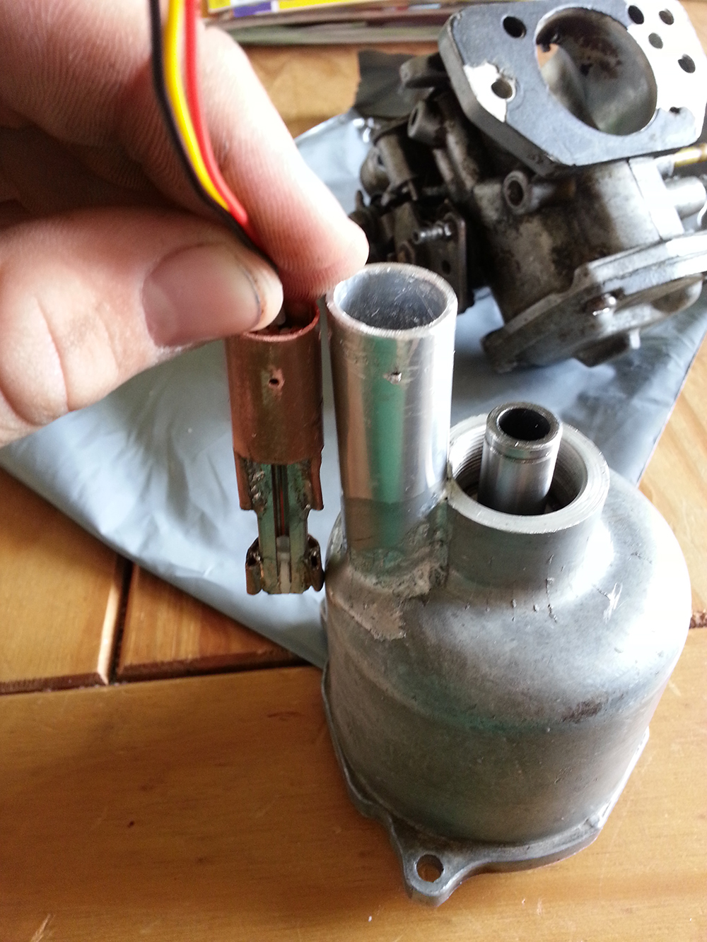

On 11th Apr, 2013 Brett said:

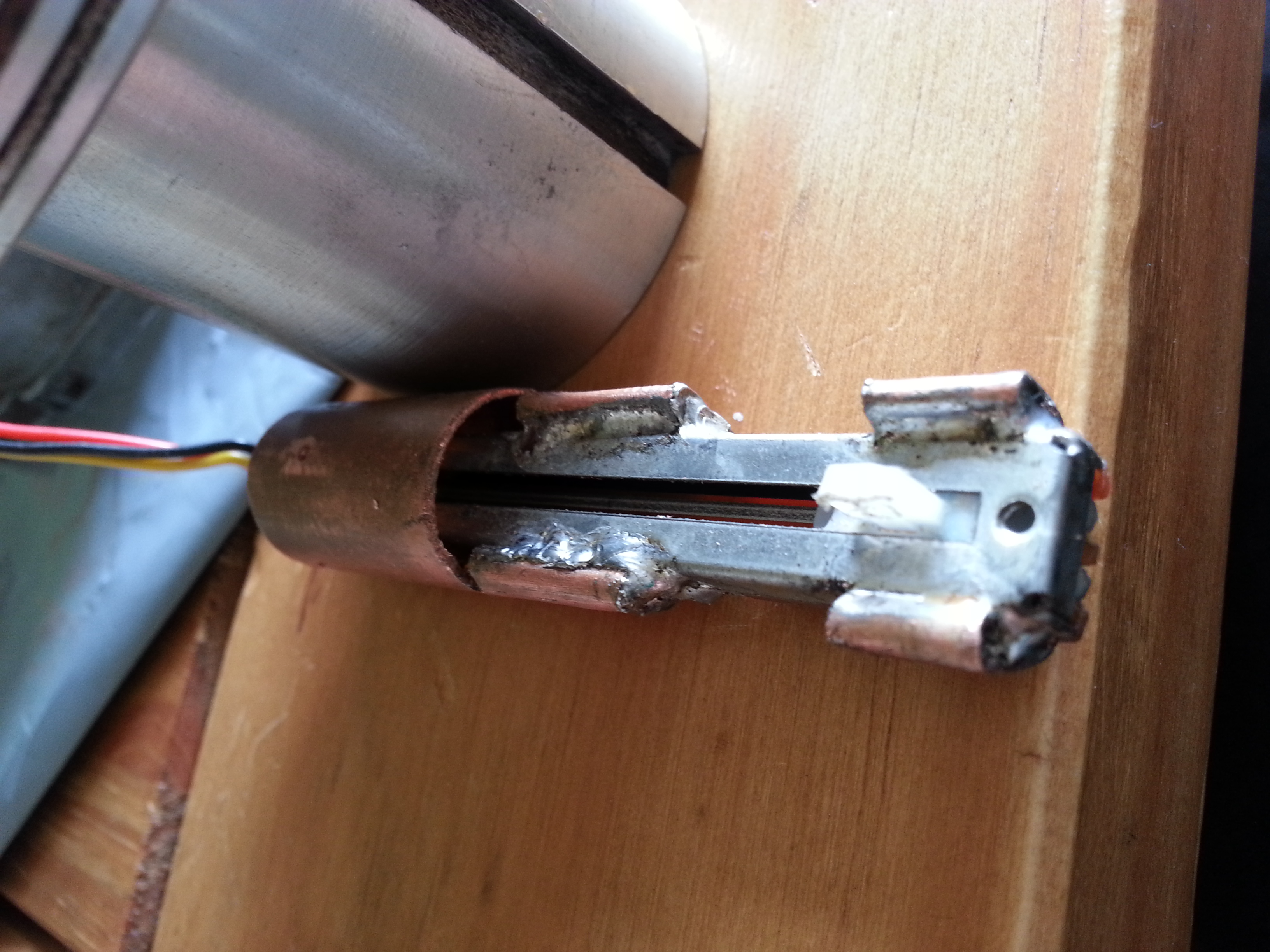

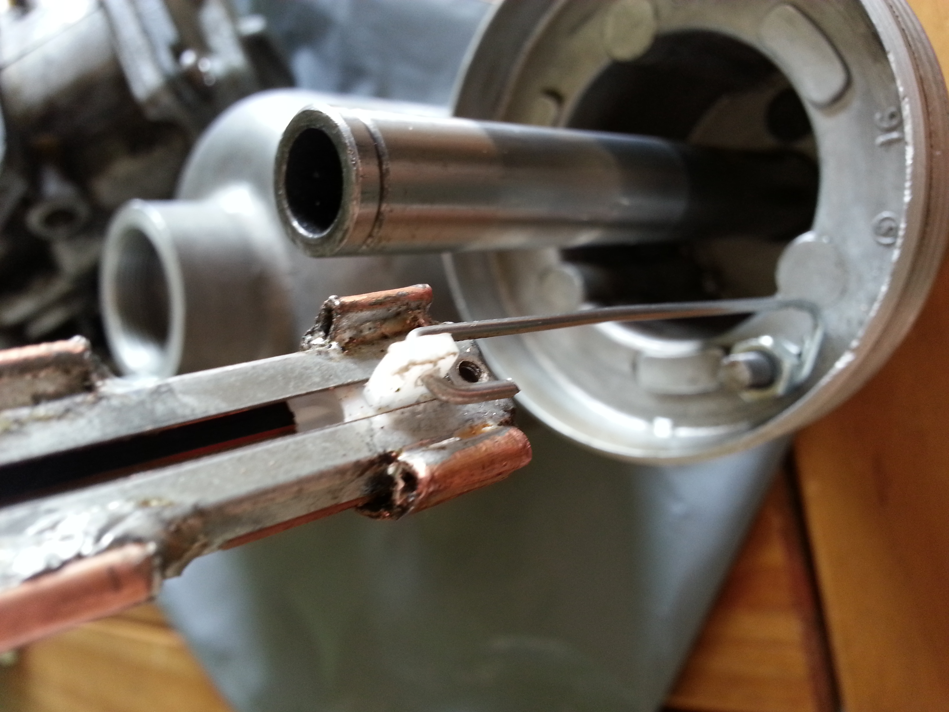

next is the electronic one,
with this 'basically' there is a variable slide resistor that replaces the smaller inner tube so as the dashpot piston ( and needle) move up and down it moves the resistor
hopefully the pictures can do the talking
Willy_sa
41 Posts
Member #: 10084
Pretoria, South Africa
Thanks Mate
I was talking about the electronic one as I would love to use it with my megajolt.
Great work there!

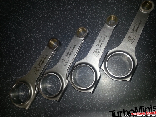

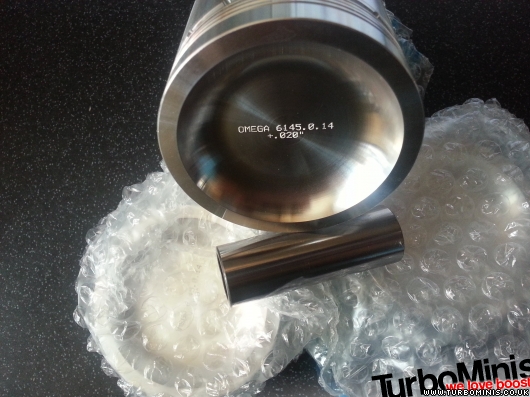

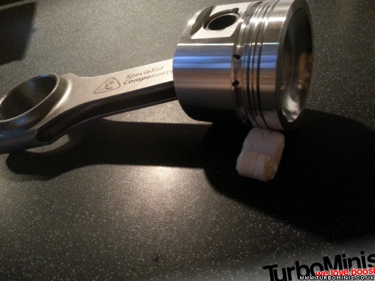

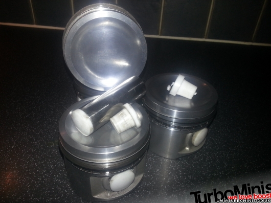

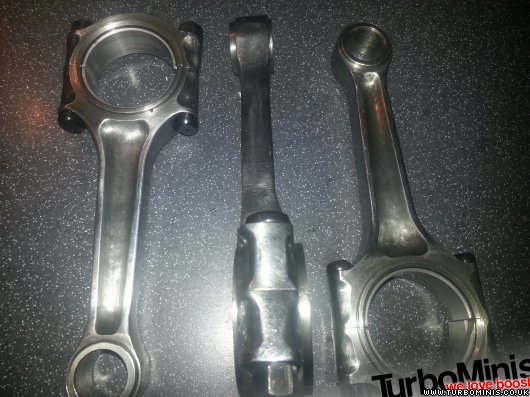

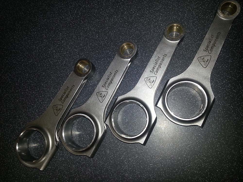

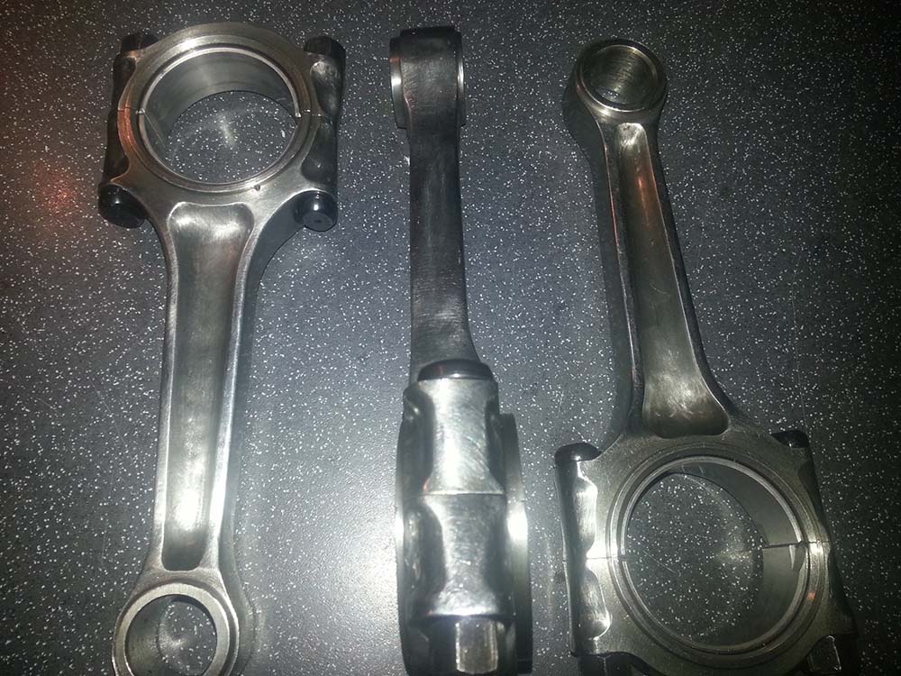

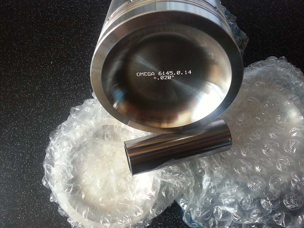

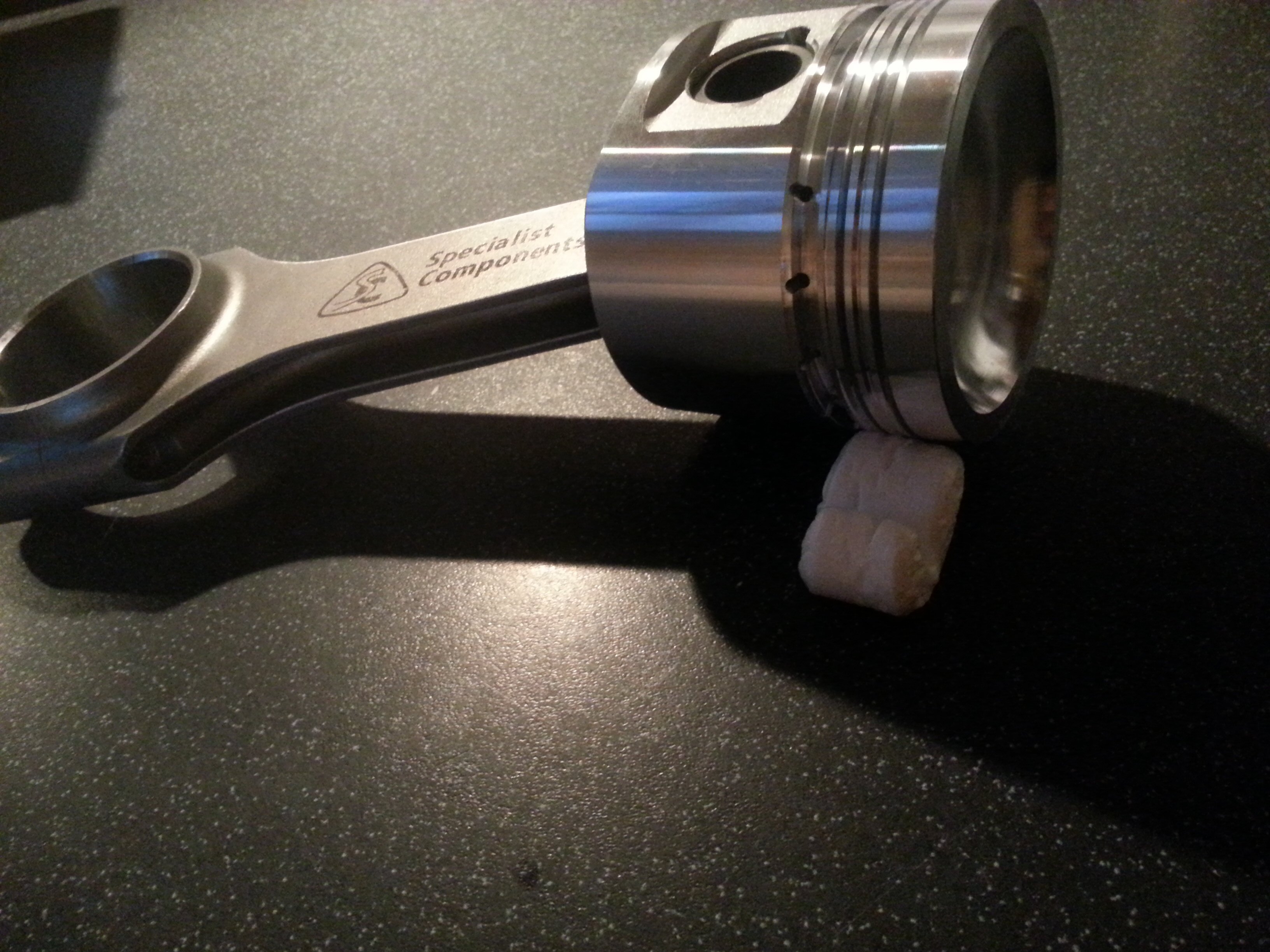

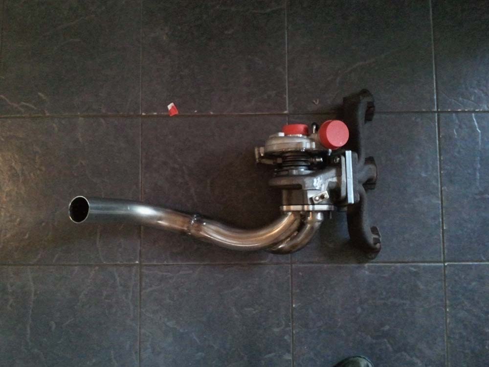

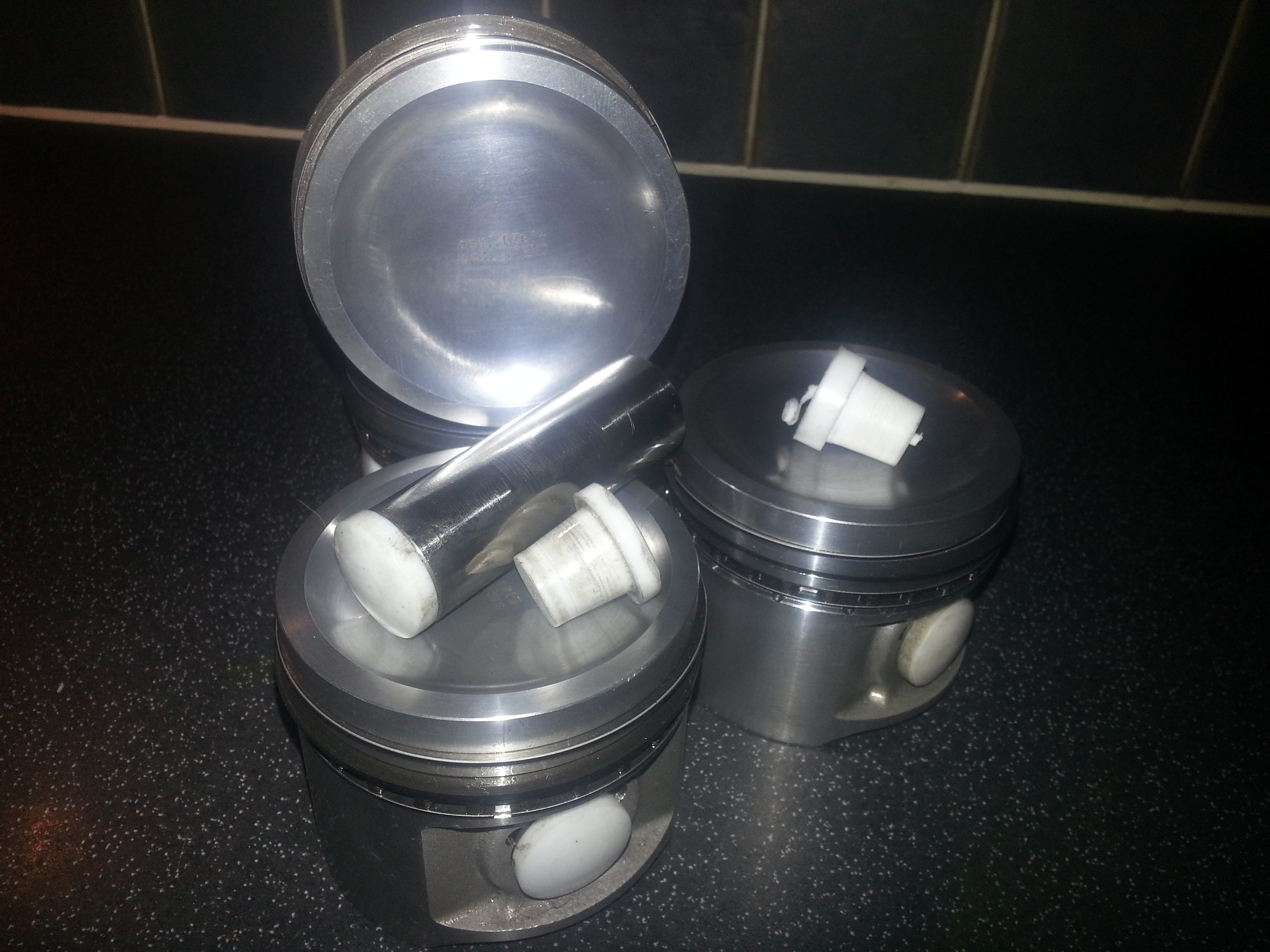

soooo after 4 or 5 months of debating i decided an upgrade was in order
and in 1 bear like movement i went from this
pulled out and sold these
these
and this
and bought these (ouch)
and these ( even oucher)
like this
in prep for fitting this
Edited by Brett on 4th Jun, 2020.
