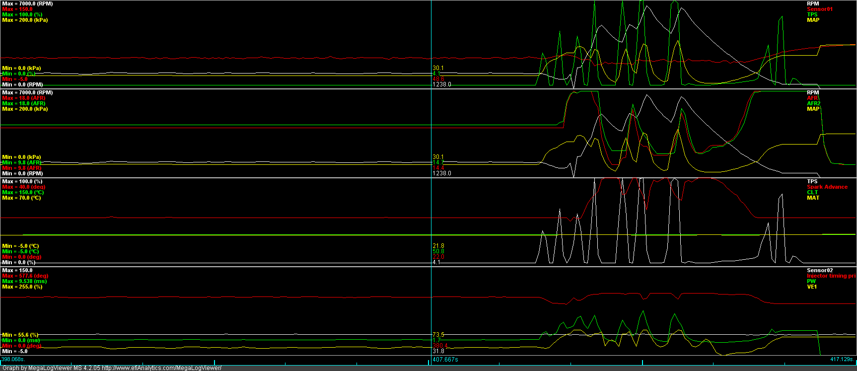

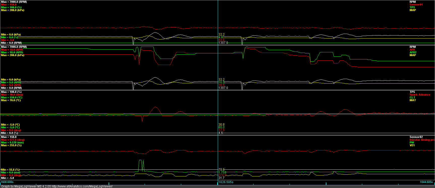

nope it wont take the zip files
theres a couple of points there where the RPM spikes to zero, any idea what that is?

joe thats a good call i forgott to mention that the alternator is not wired up and that im running on a battery alone so after a little while it drops in voltage so to get to the point here the relay that gives power to the ecu fuel pump and coils begins to run out of juice to stay held in and drops out for a millisecond because the load drops off it re gains just enugh to re latch
well thats my thoughts as i can feel the relay going in and out as the rpms dip
at first i thought it was the cam or crank sender not picking up a tooth or something but it looks good on the viewer thing

hmm i dont think its battary voltage thats the cause of the relay dropping out
had a quick look in the log and it drops out at as low as 10.8v that should be enough to keep it held in
eather way i will wire the alternator in when i get a chance
started at 12.4 when down to 11.8 and since you mentioned the injector flow and voltage it makes sence that i had to keep adding fuel as time went on i thought it was a bit weird since normaly you take fuel as it heats up i think this explains it tho
