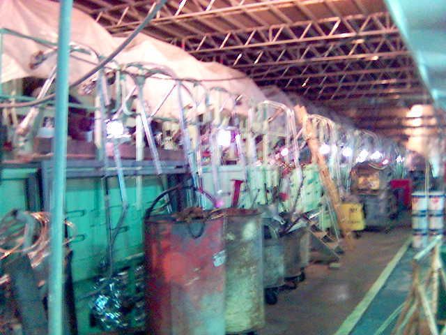

On 18/08/2006 23:01:00 fastcarl said:
Dave , are you sure that crossover thing works on every engine , i read somewhere on the highpower board some viper owner s engine made so much torque from very low down the torque curve was always above the hp curve,
think about these 16 cyl oil tanker engines that make 1,000,000lbs of curly wurlies but only make 100,000 bannanas, how will they ever cross.let alone reach the dizy hights of 5252.rpms
carl
Carl: Funny you should mention those engines. I came back from Denmark this afternoon, where we have had some startup on some equipment on MS "Estelle Maersk", the worlds largest containership. 399 meters in lenght, 13-15000 20 feets container (depends on how you stack them) and 110 000 bhp:cool:
Heres a crappy phonepicture of the 14 heads :)
