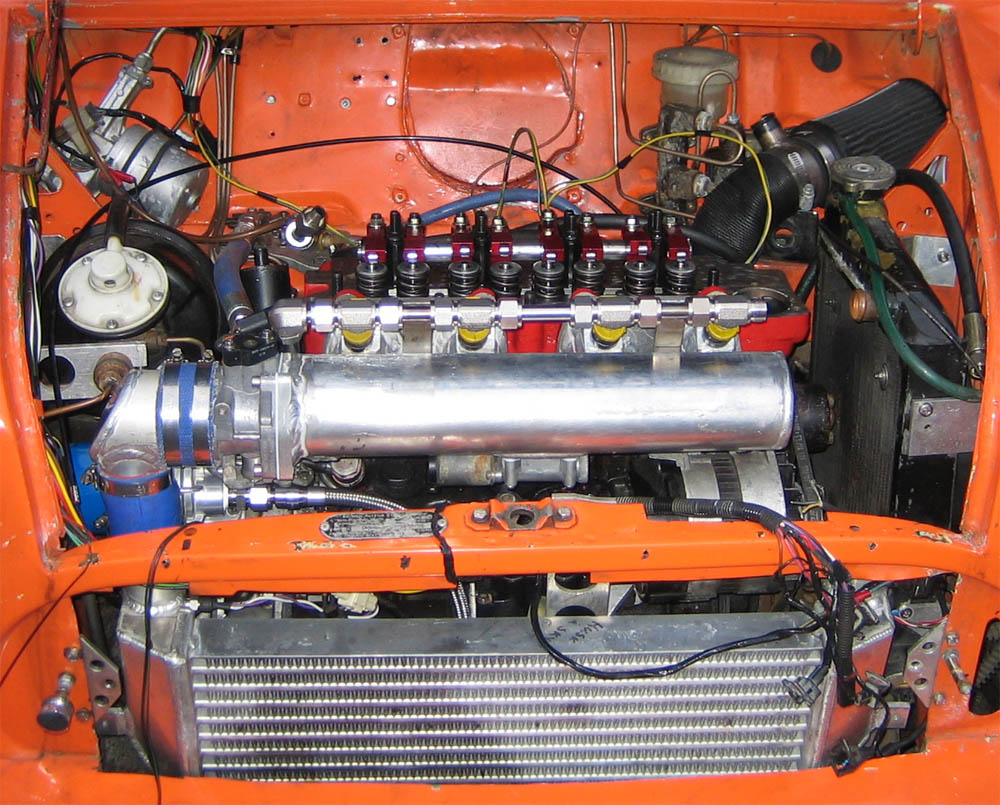

One thing that is going to be a collosal PITA is the intercooler, at the moment i have no F**ing idea where thats going to go! Where most people run the pipes to and from i have a bastard great plenum!!
At the mo i'm toying with the idea of a chargecooler over the flywheel... like i haven't added enough weight already!!
is there not space to pop it under the plenum behind the grill?
you could have really short pipe work then too

Nic there is a fair bit of space under it behind the grille as there will be no dizzy, initially i was thinking i wouldn't be able to get a decent size pipe to and from a cooler there without tight bends like on Dar's setup,
i have just realised that i can use a pre-engaged starter and cut of that sticky out bit on the clutch housing to enable a pipe, that along with relocating the oil filter sould make room for a pretty big intercooler.

Well the plenum will be finished off (apart from a bung for the air temp sensor and the threads in the fuel rail and maybe annodising) at the weekend providing my argon holds out, i'll then have start looking for an intercooler and turbo so i can sort the exhaust plumbing out.
Ok, got a tad more done tonight.
Made a flange for the Vauxhall TB and attatched it via a slight bend and covered in the other end of the plenum. In theory it should now be airtight!!
I'll make up a plate to go on the TB flange and stick the injectors in and pressure test it in the week, I expect it'll need a couple of welds touched up.
Oh also, I have a question for everyone, where shall i put the IAT temp sensor? I'm thinking in the bend just afer the TB, but i could put it before the TB so it's thermally isolated from the plenum. opinions?
I would put the IAT sensor after the throttle/butterfly.
If you are using MS or another speed-density type fuel injection, you should measure the temp after the butterfly if you want accurate part throttle fuel metering.
The throttle cools the air flow down at part throttle.

I'm with Axel on this one.
Delphi (used in a lot of GM vehicles, Hyundi (sp?) and some Fords) use a plastic bodied threaded sensor for exactly the reasons you state .... rated to about 10bar too so shouldn't be a problem.
I think some of the latest Bosch sensors are plastic bodied too.
Excelent guys,
That seemed to be the right thing to do to me, although I hadn't heard about the throttle cooling at part throttle before.
I have heard a lot of people recomend putting them at the far end of the plenum, seems a bit wrong to me, i would expect its best where all the air will flow past it (just after the TB)
Well i'll keep a look out for some of those plackie sensors, failing that i'll make a plackie bung and put an M6 Mpi one in it.
I would personaly put the IAT in the middle of the plenum, thus reading an average temp across the plenum. The air at the throttle is not necissaraly the temp that enters the port, like wise the air at the other end of the plenum is not whats entering the cylinder furthest away from the sensor. Air is a funny thing and when you add in the heat sink that is the aluminium plenum, air temp tends to vary. Anyway, its not going to be much of a difference and MS will compensate with lambda feed back. Its nice though, to get close to the base map as you can in the first instance.
Rover put their IAT in the port runner clossest to the throttle on the T series turbo and NA cars and used a standard IAT sensor mounted in a plastic insulating boss.

Well being the type of person I am i turned up a nice bung for the IAT sensor rather than just stuffing a tap through the plenum, trouble is the plenum is now big enough that it dissipates heat as quick as my tig can put it into it, as i found out trying to weld the bung in......*oh well*
Thought to myself i'll pressure test the plenum anyway, leaks like a fucking sieve!! mostly from the head to plenum joints partially due to not being completly flat, partialy due to gaskets made from a cereal packet... I guess i'll have to get a couple of pig blow torches on it to really preheat it and maybe get hold of some helium to sort the IAT bung the other bits should touch up ok (fingers crossed*indifferent*)
So to take my mind of that faliure.... I started looking at fitting the intercooler, had a bit of a trim of the front pannel and "fettled" the transfer case where the starter fits (I cut about 10mm off so it will be flush with thefront face of the starter)
result is this, enough room for end tanks, and will fit behind the grille.
just continue with that old plenum but use it to mock the stuff up on, and then make/get made a slinky jobbie
im liking that intercooler location
Cheers Nic, should hopefully get some air through it despite the 4 massive spotlights in front of it, although they'll probably only be there in the winter...
Thats what i was thinking of doing, this plenum hasn't cost me much, plus i've learned how to tig on it, there's plenty of stuff i'd change, so i'll get it running on this one and do a better one later on!
