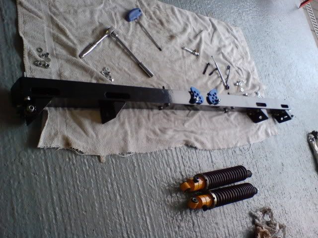

Heres some pics of my Minispares Beam.
http://i169.photobucket.com/albums/u210/sp...on/DSC00006.jpg
http://i169.photobucket.com/albums/u210/sp...on/DSC00003.jpg
http://i169.photobucket.com/albums/u210/sp...on/DSC00155.jpg
http://i169.photobucket.com/albums/u210/sp...on/DSC00002.jpg
http://i169.photobucket.com/albums/u210/sp...on/DSC00160.jpg

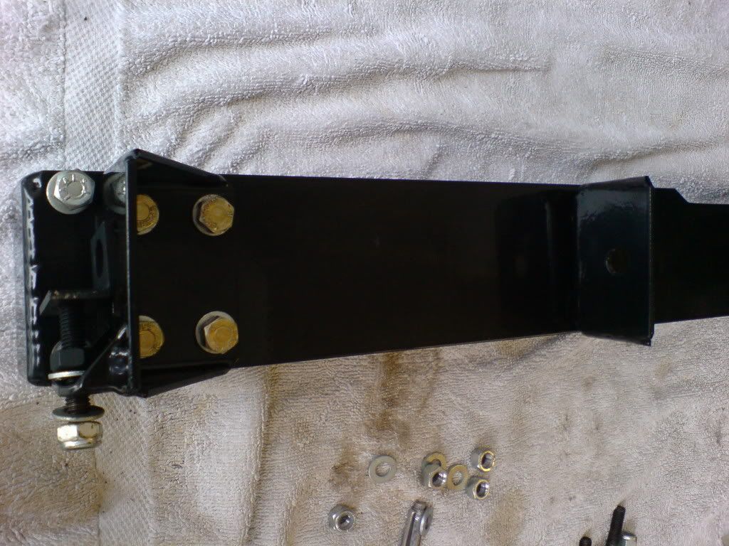

You can see were i had to mod it to fit.
Even on the Minispares website it says "it fits all minis up to 1997." But my mini is a 1991 and it was miles out!
Also you should be able to see the camber adjustment but no track adjustment.
It's been powdercoated as it only comes it plan alloy.
What do you think..?
