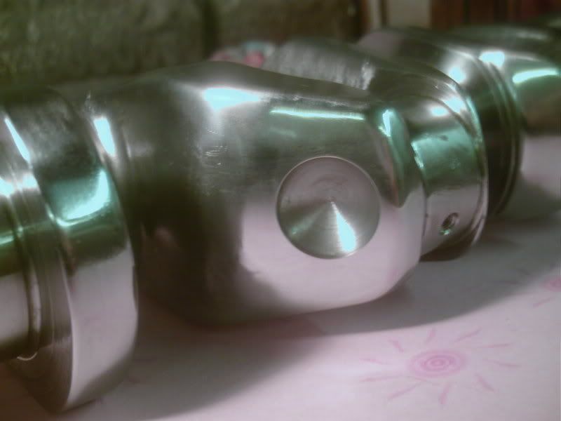

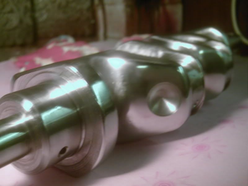

well i'll drag this one back up.
all this talk of the counterbalance less cranks got my old matter going, it has been sat there in the back of my mind for years ,ever since i read about Eslinger engineering in the USA running a form of balanceless crank in there sandrail dragster pinto engines, although i couldn't find a pic at the time i always thought if they can why cannot us A series users,
i was just to cautious to take the plung, but seing as others have it seems they migh be a goer,
so ive had a go,
it just needs a gring now, i'm debating whether to backdrill, they take so long to modify by the time comes to backdrill i'm sick of working on them.
i'm off to get some piccies.
just weighed it at 9.54 kg
carl

Bet it looks too good to put in an engine where all that hard work wont be seen
6966 Posts
which is why you take piccies first,lol then fit a transparent sump. ther's just no substitute for bar HP.

Thats more like Daves one that I saw. You could shave in the reflection.
Paul
As usual beautiful work from MR Austin

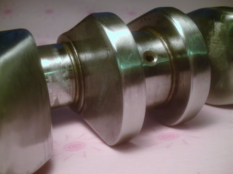

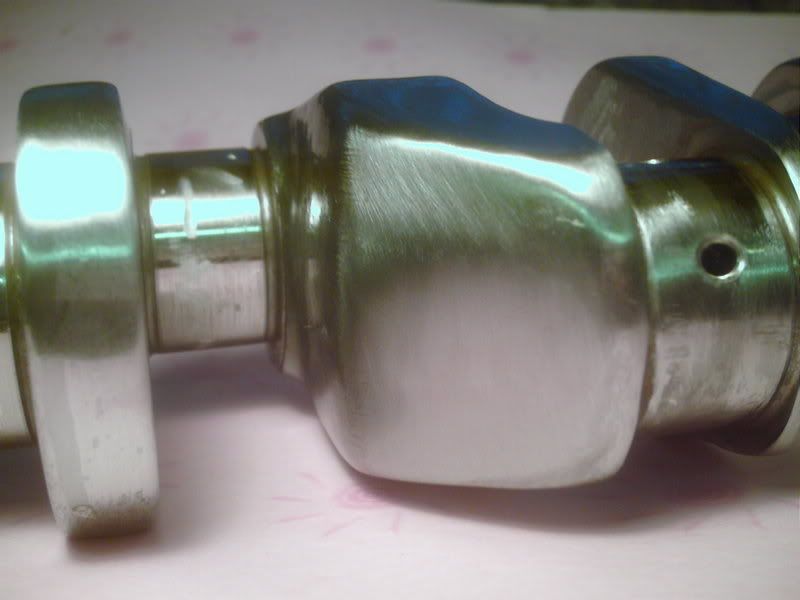

Oh well ,it only took 24 hours to talk myself intpo backdrilling, o at least Vegard will be happier,lol.
http://i24.photobucket.com/albums/c2/carl1964/mmm.jpg
http://i24.photobucket.com/albums/c2/carl1964/bhy.jpg
now with extra polish,lol.
not that you'll see it when its herdened,
http://i24.photobucket.com/albums/c2/carl1964/zzas.jpg

Looks good carl, hope it does the business for you

looks really nice!

A herdened crank, that would be something for Sheepspeed! BAAAH!
For yuor use, I guess counterweights mean fuck all Carl. Looks great.
My backdrills are 3/8" deep, you can lose some more weight.
Paul
