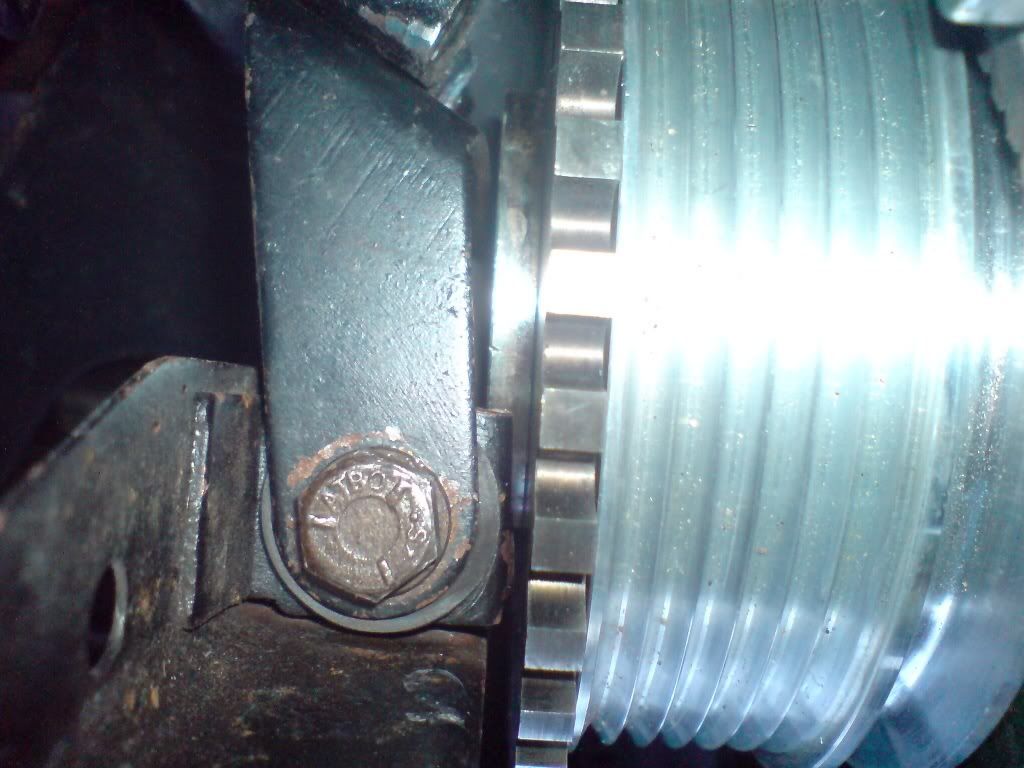

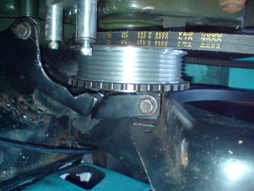

heres a couple of pics showing how tight the clearance is down there.
i am thinking that i may be able to get a bit more on the bottom of the fan cowling where the mounting bolt goes through, as this is the tightest part.

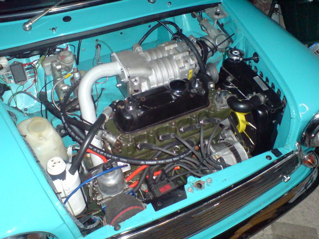

almost everything is now bolted up, except the carb needs to come out again, because it leaking fuel from the base plate all over the place :( i am guessing it needs a rebuild. hey ho, that will teach me a lesson for not doing it.
need to sort a few hoses and tidy the engine bay up but its basically there now, it will be done in time for castle combe for sure :)
some things in the pic are not properly sorted so it looks a bit rough but you get the idea :)
