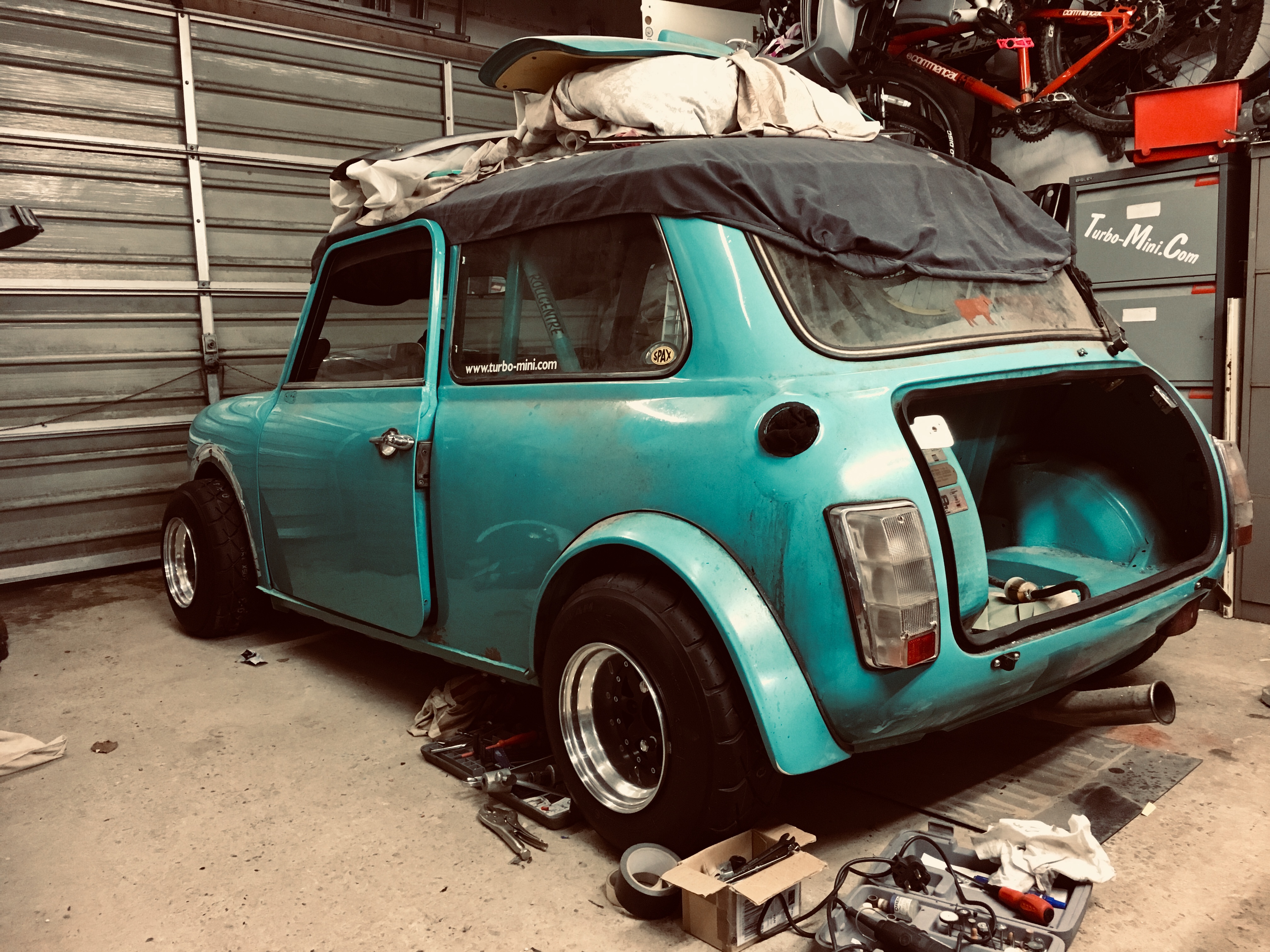

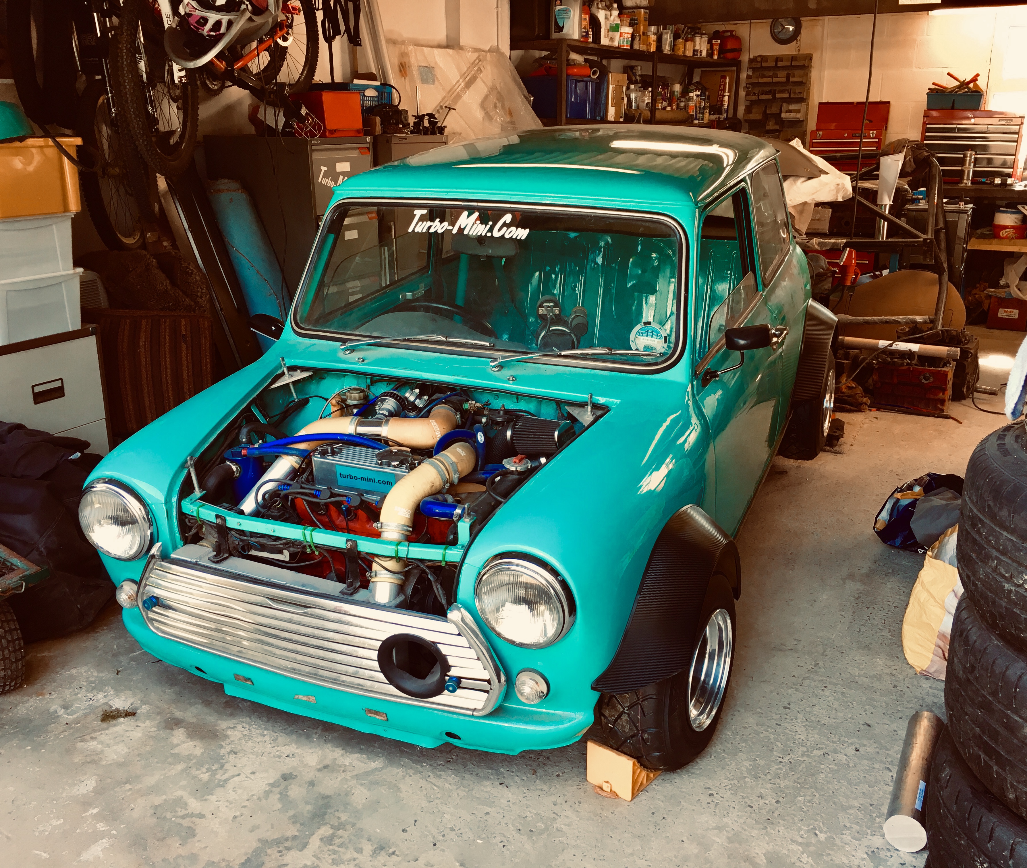

Don’t make me change my mind! I was really torn in swapping the wheels as it is what made the car different from the rest and I will miss that, but I need to improve the handling as it’s a real handful and the overall weight saving was a whopping 22kg.
Phil.
no split rim super lightweight 14'' s out there with enough inset to handle well phil ?
4642 Posts
Not in my Budget Robert. Plus I picked these 10’s up about 7 years ago at a good price so it was about time I used them.
Phil.

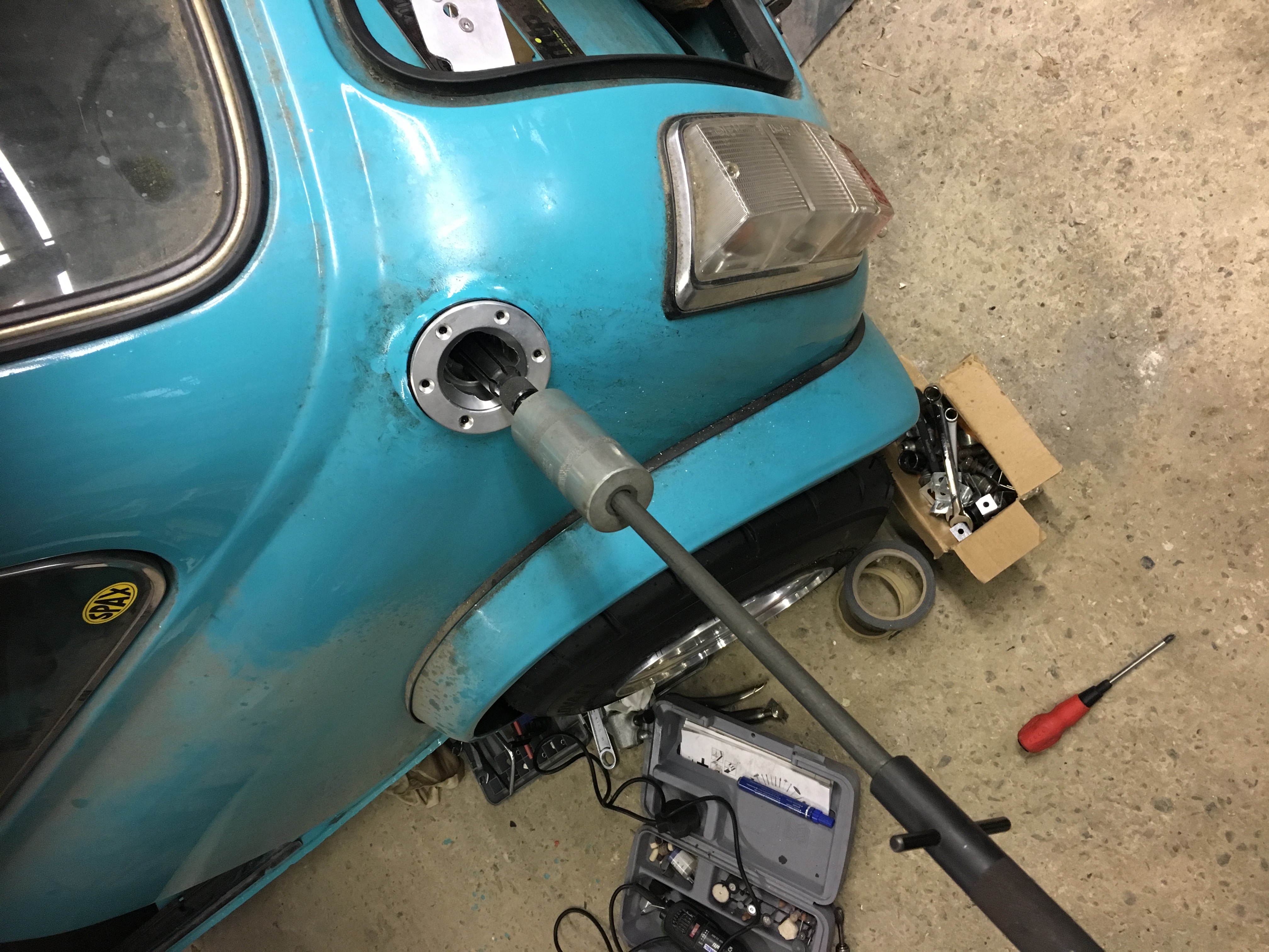

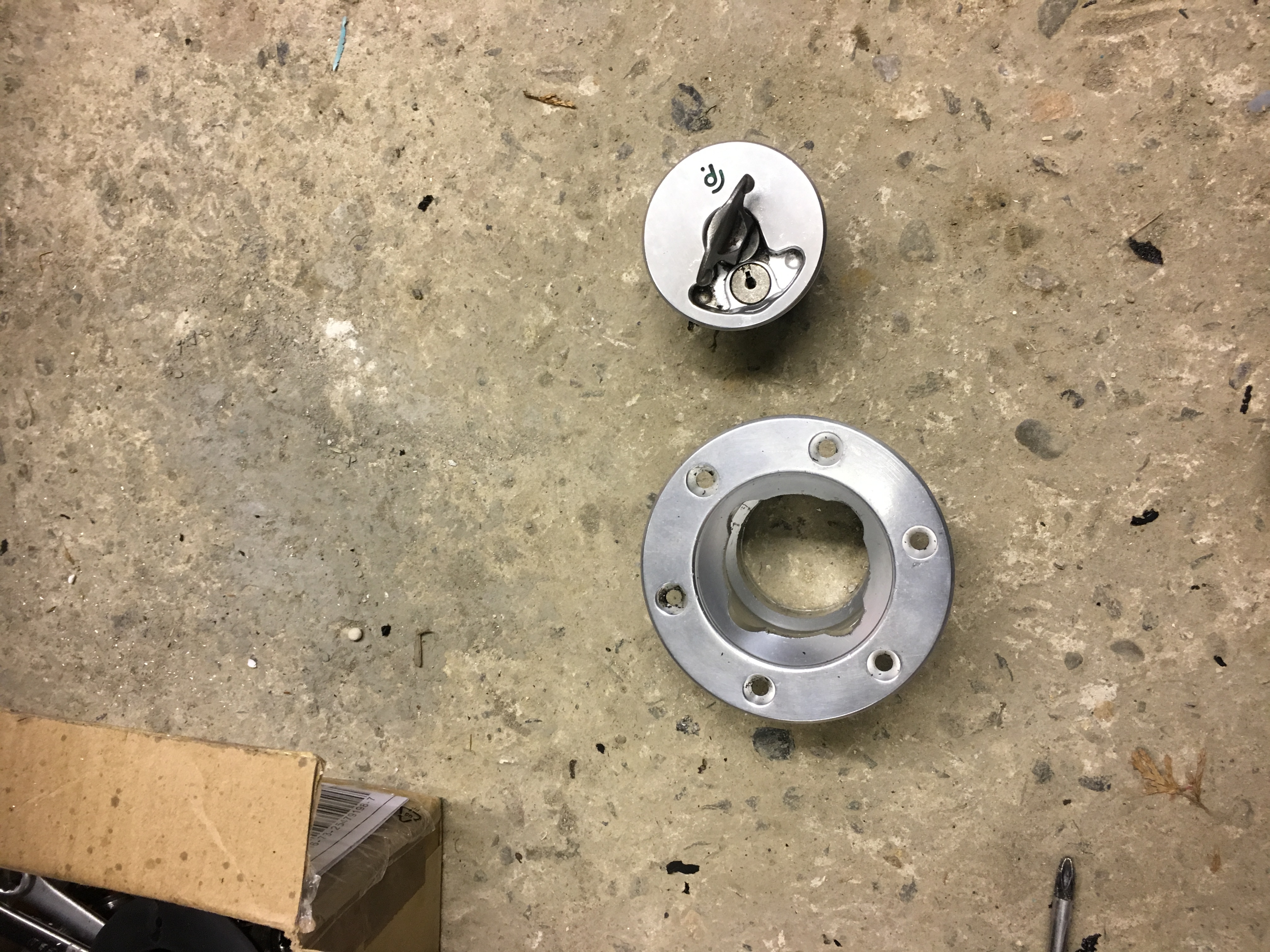

I had a real nightmare removing the custom filler cap from the tank. This was probably last removed about 20 years ago, thankfully the slide hammer came to the rescue.
I’ve got an alloy fuel cell from Iain’s old Miglia that’s going in now instead.
Phil.

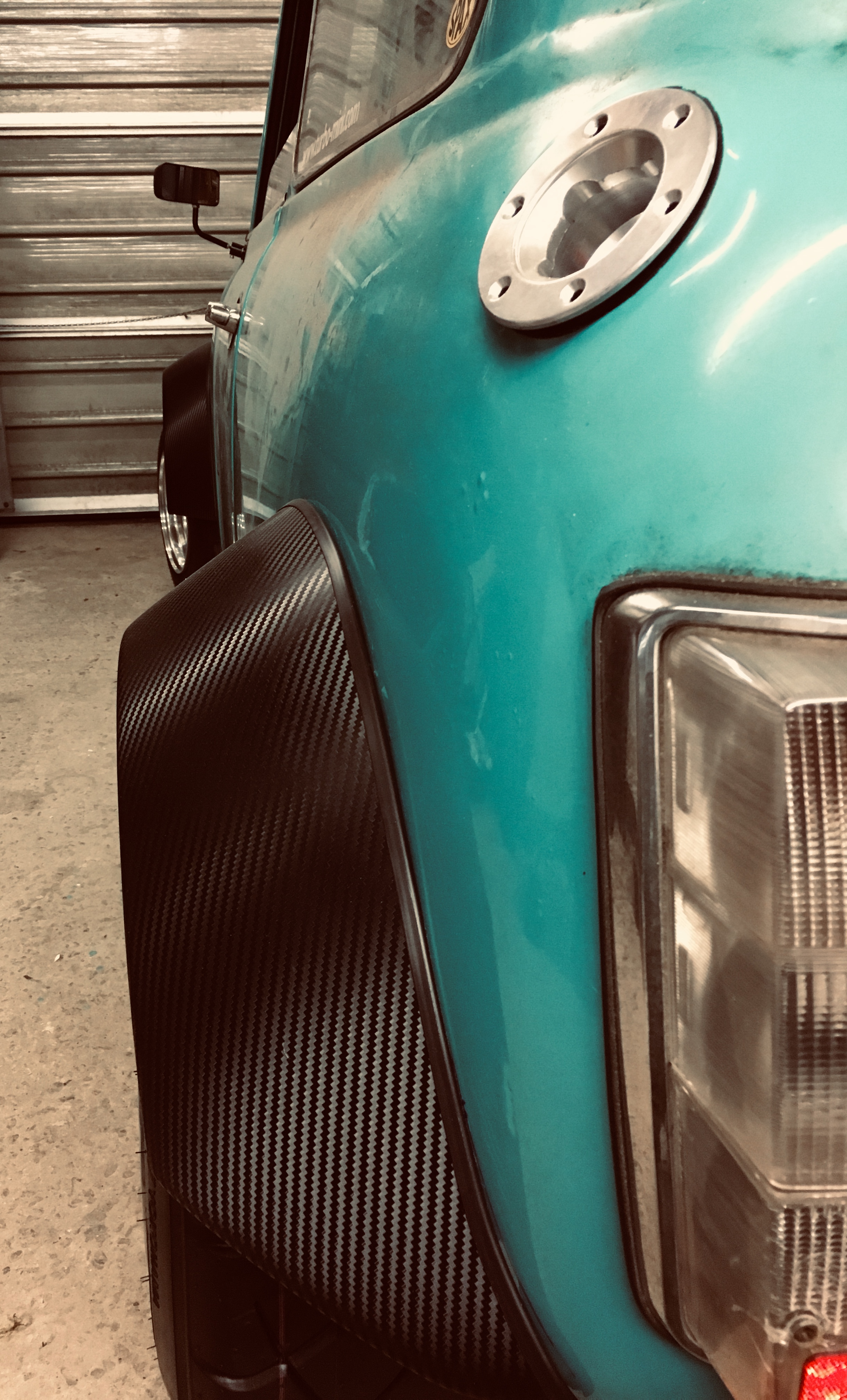

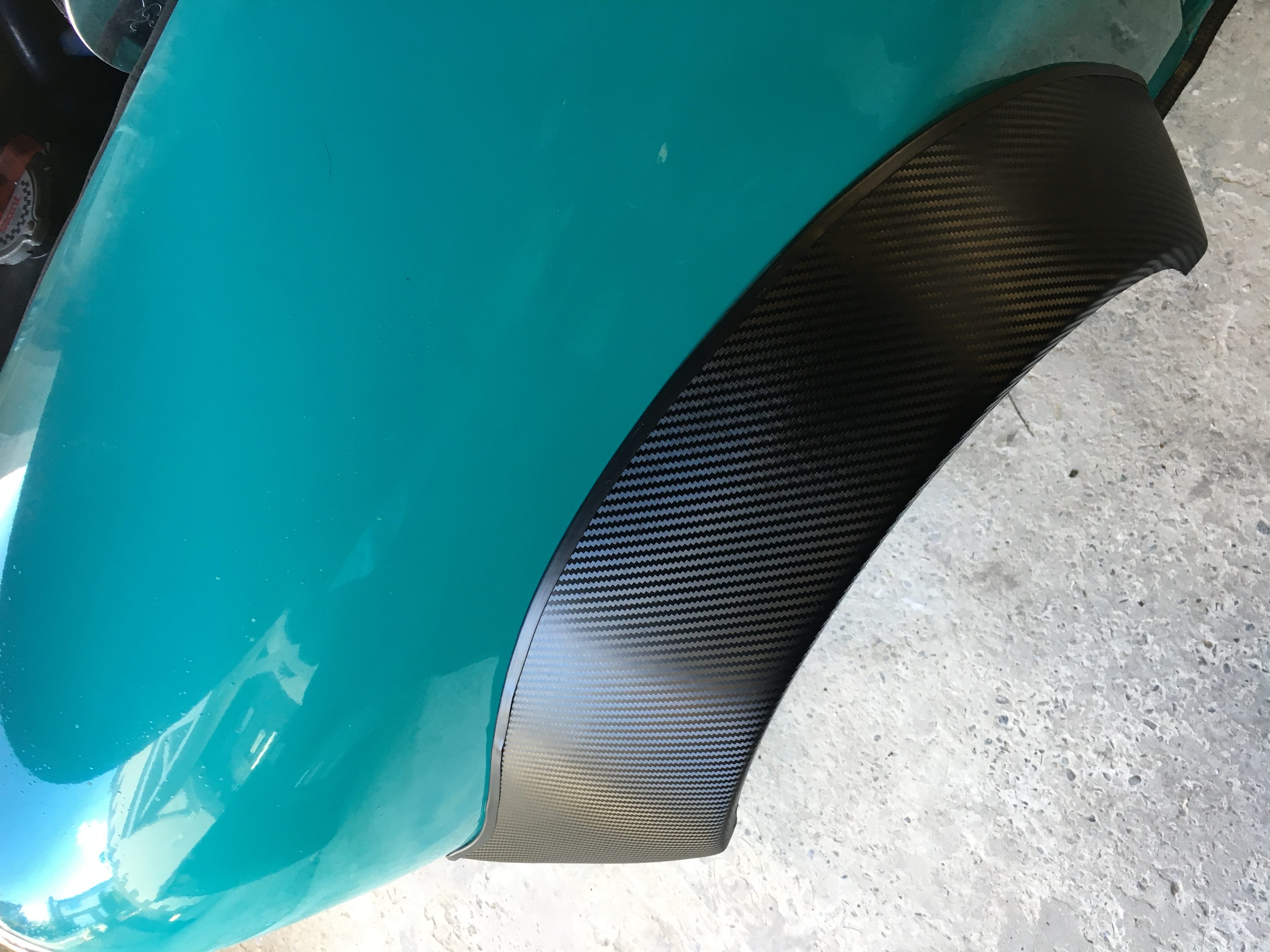

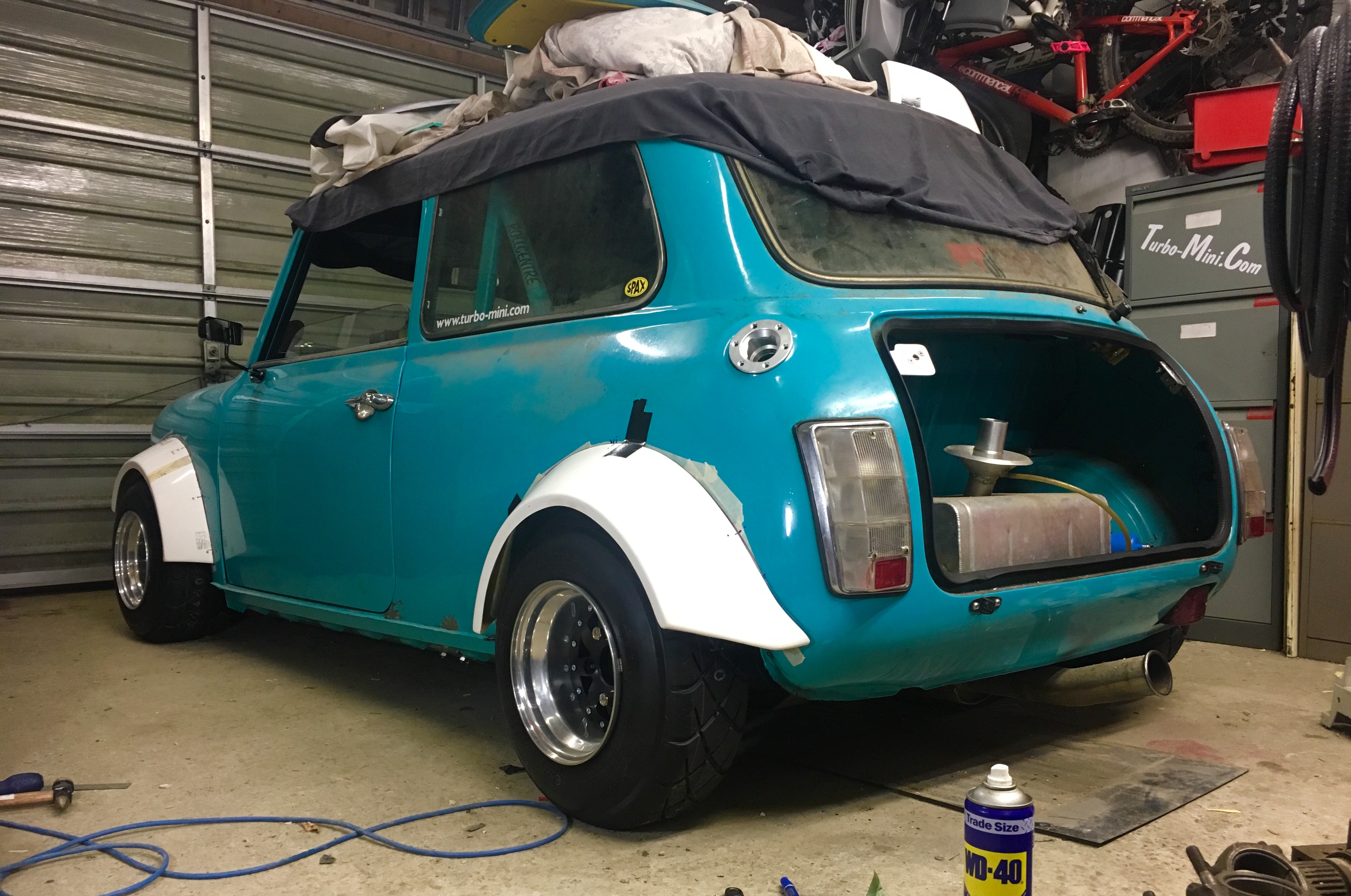

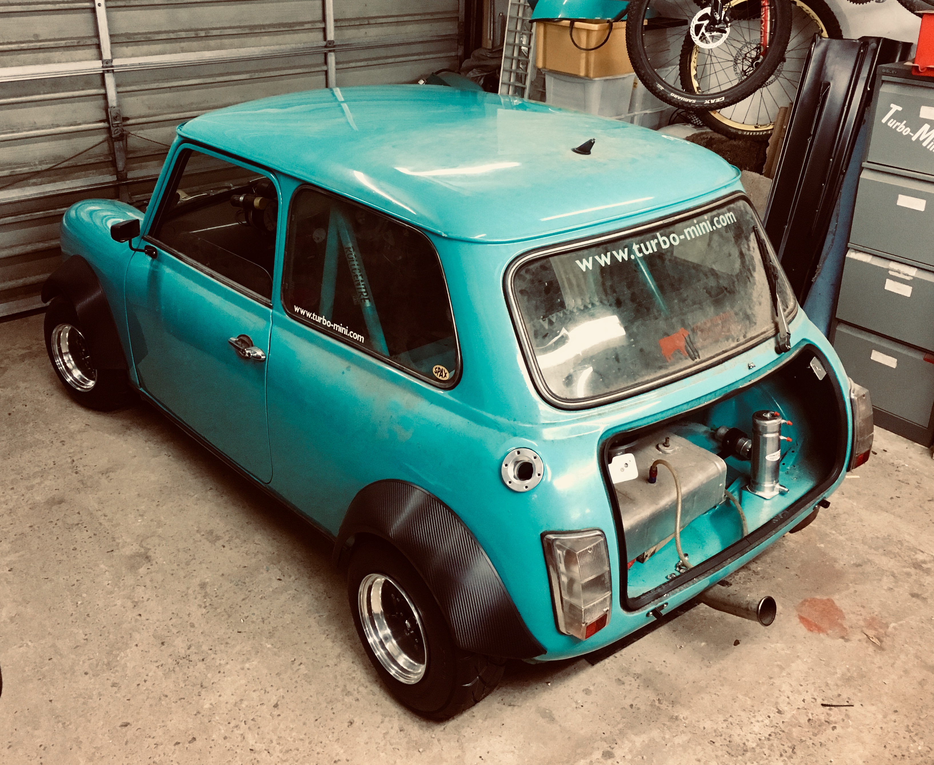

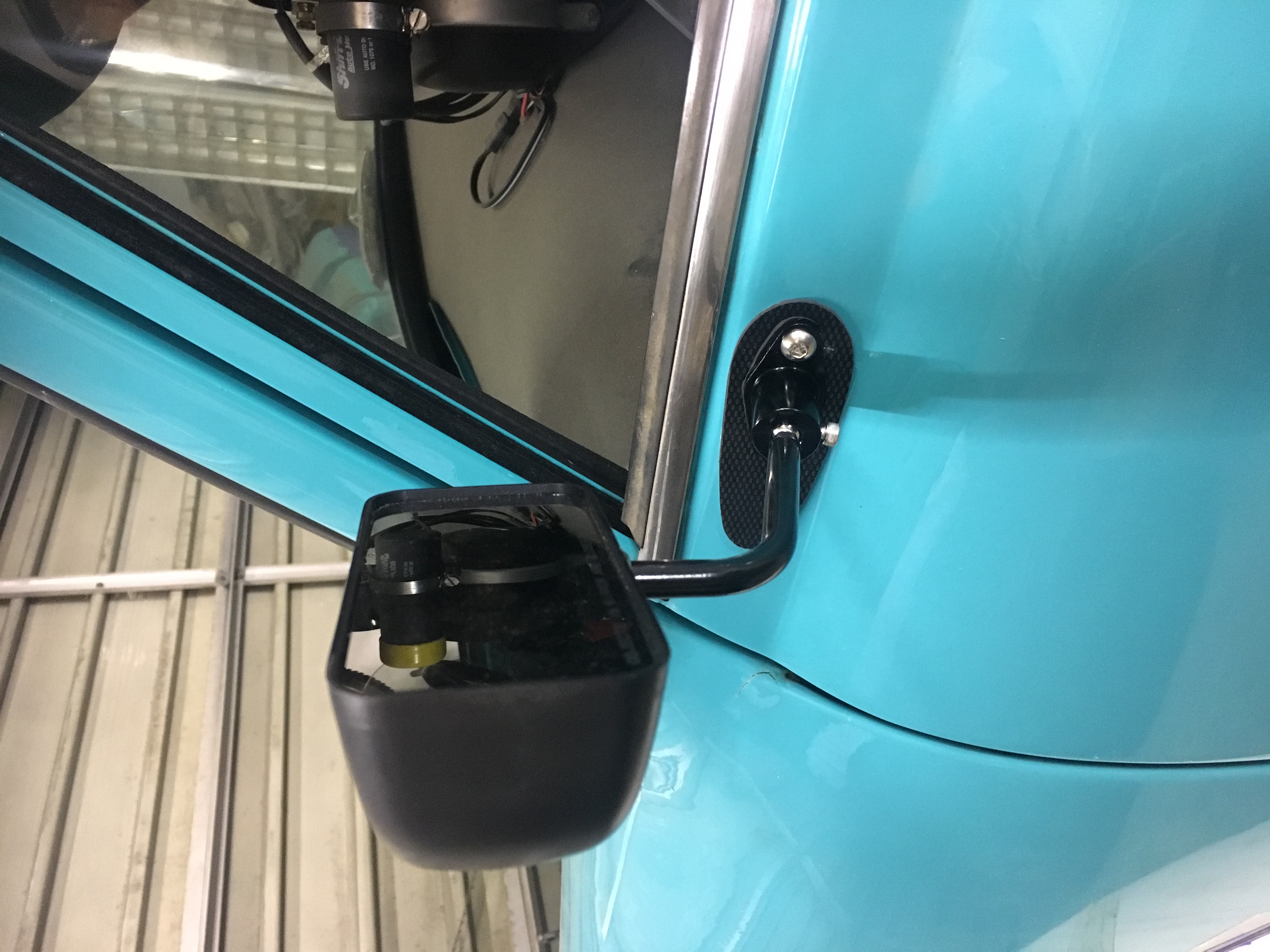

So I’ve made some progress. Changed the 90’s style mirrors and got all the Miglia arches trimmed to fit properly. I also made all the brackets to mount them from stainless as the aftermarket ones I’d originally bought were crap. With all the trimming, making brackets, bonding them to the arches, trial fitting on and off the car it’s taken me the best part of a couple of weeks.
My target is to get it road legal by the end of the month. I’ve also been weighing bits as I’ve swopped them and with a whopping 57kg removed so far the car is just a little over 650kg now. I know that’s not light compared to some but my budget is tight and I’ve not gone mad. If I can get it under 650 I’ll be happy.

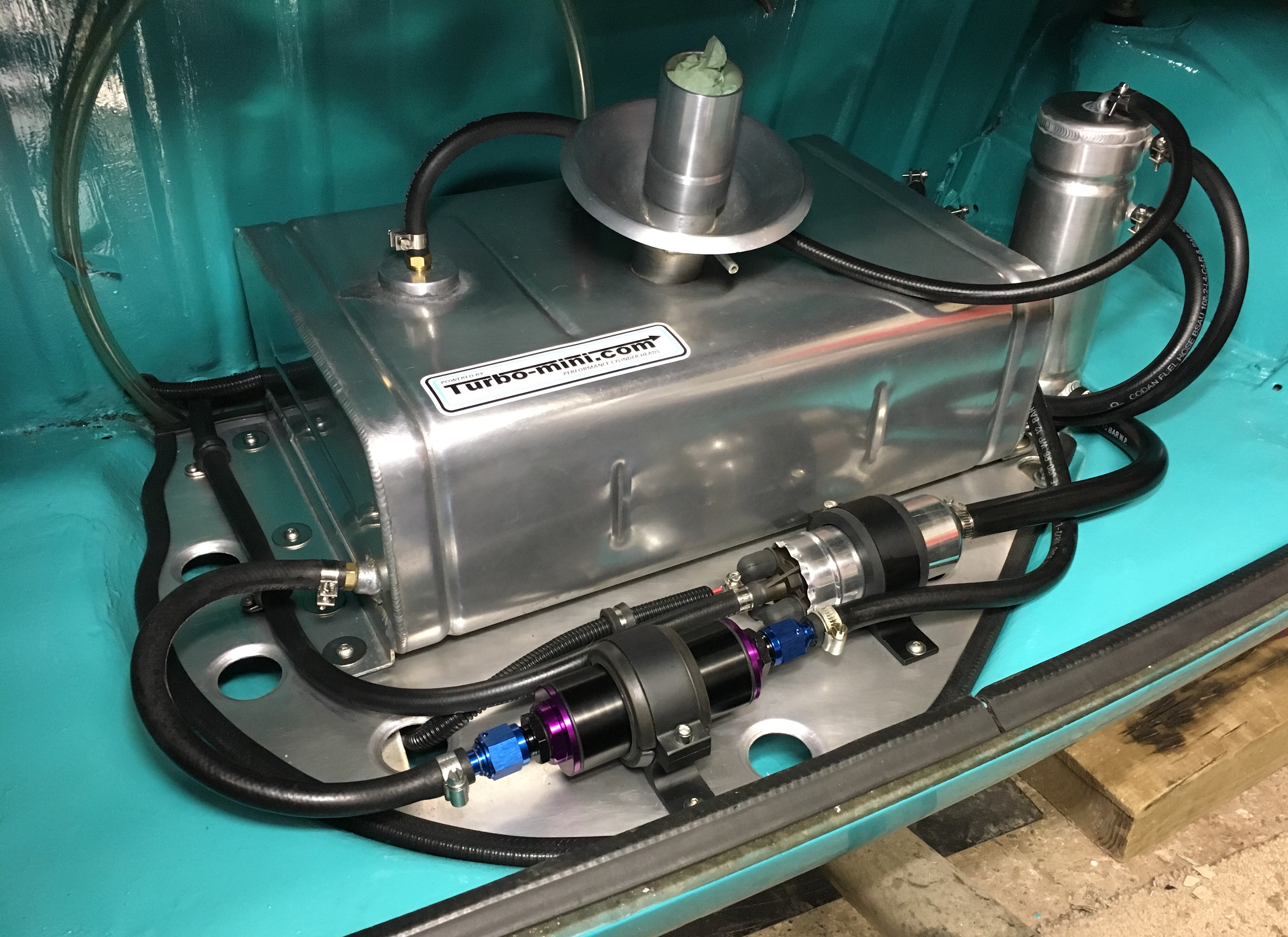

Getting closer. Just the fuel cell, swirl pot and pumps to finish mounting, the seats to fit and a few minor jobs. Not far off now.
Phil.
4642 Posts
Fuel pumps, tank and swirl pot install finished.
Phil.

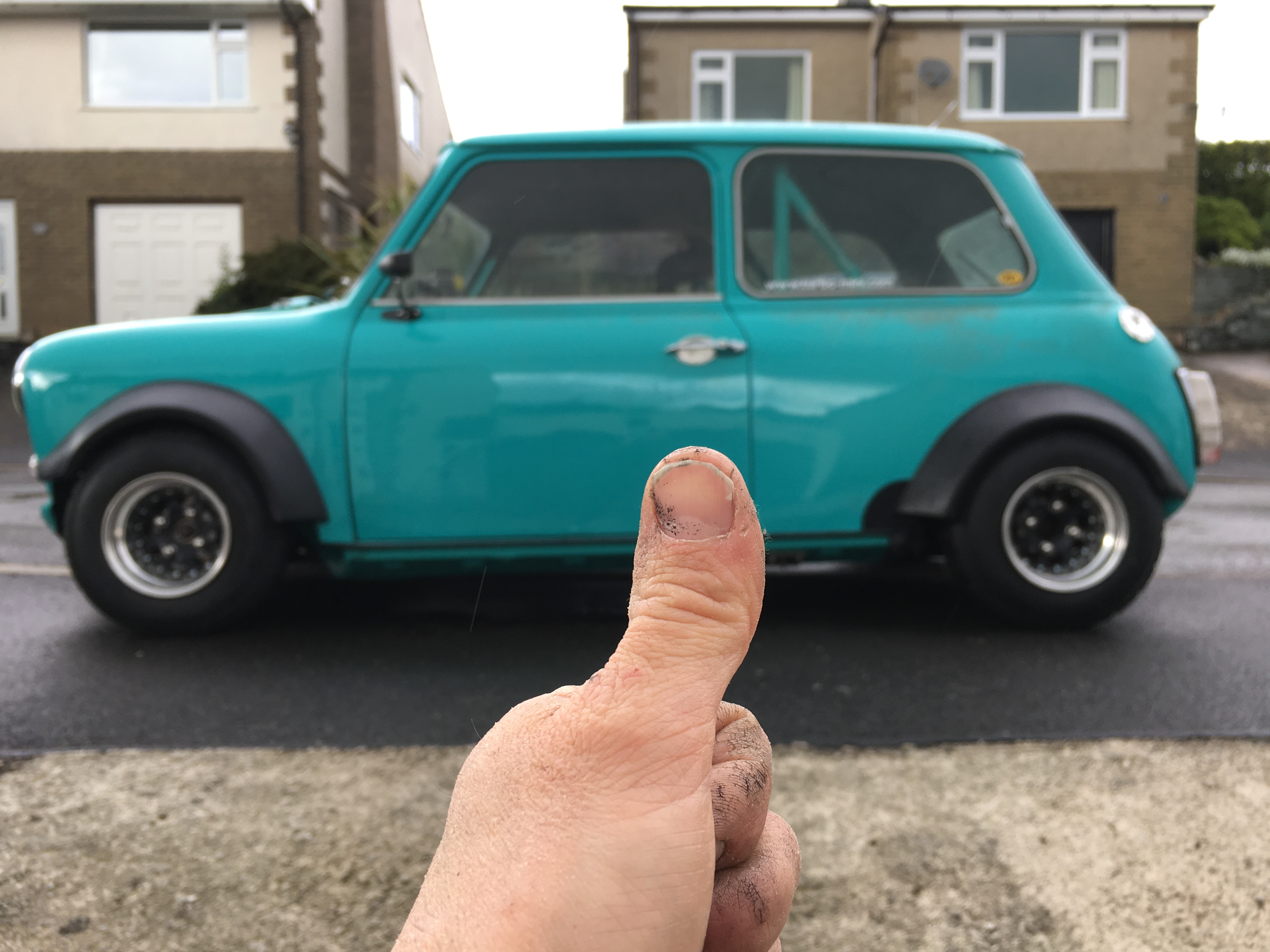

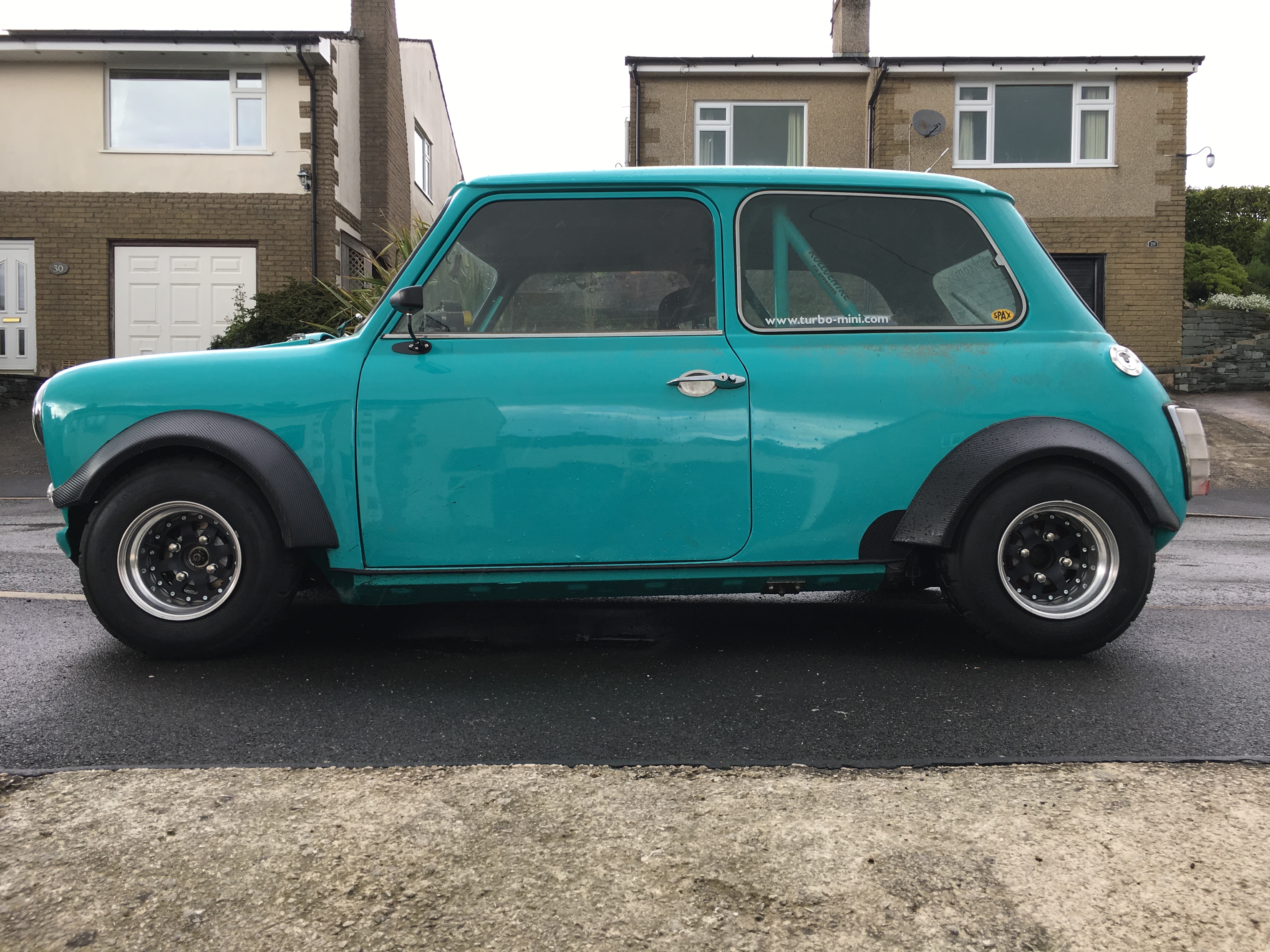

Worked on it until 1.30am Friday, 1.30am Saturday, 12.00 Sunday, 12.30 Monday, 1am Tuesday and Wednesday and it passed the MOT today!!
Phil.
Great news Phil!
When do I get to have a shotgun ride? :)
jonny f
2096 Posts
Member #: 9894
Dorking
Congrats!
