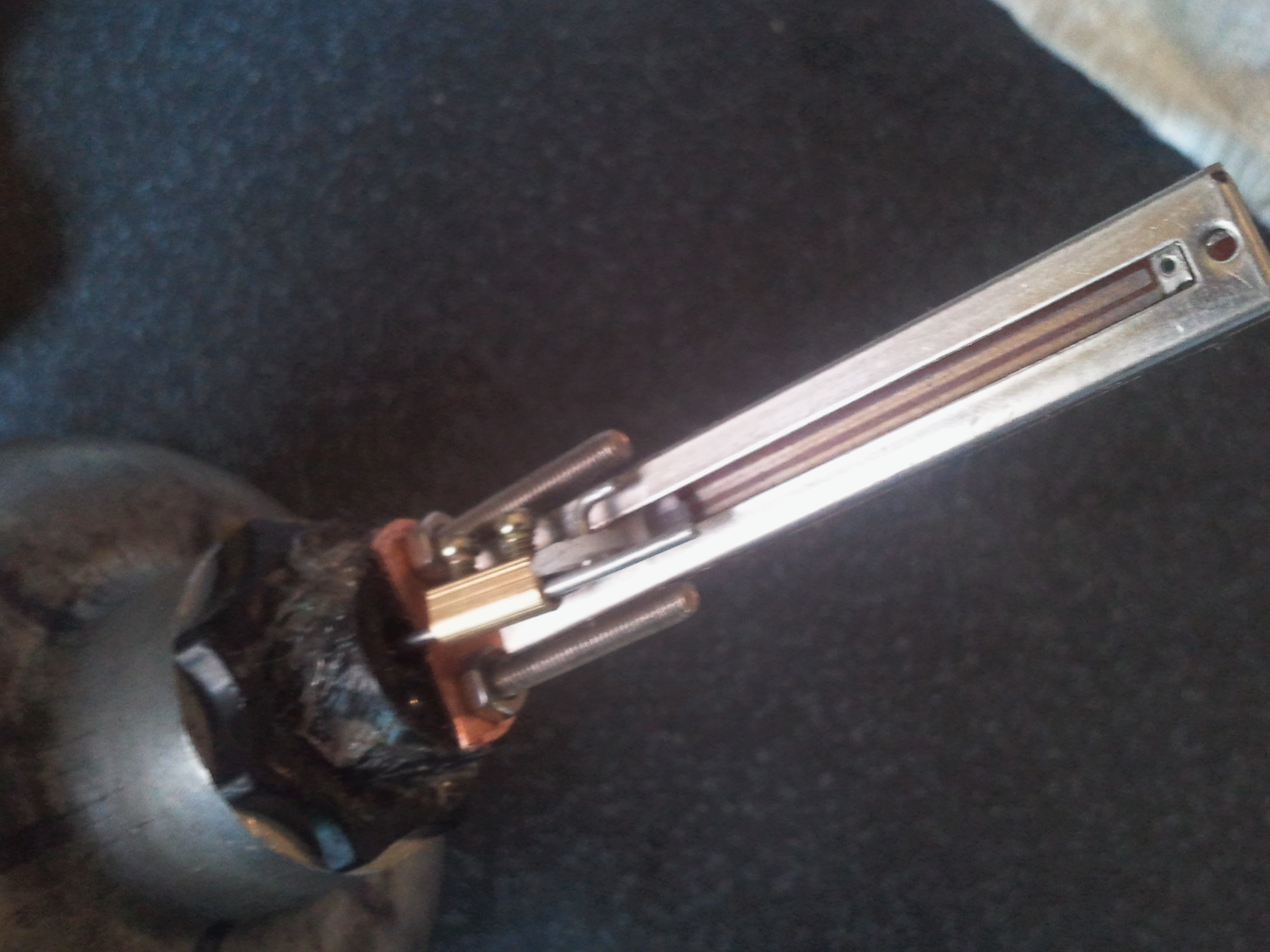

a little something i have been working on, http://www.youtube.com/watch?v=9vsc05-D_cU this one is removable and sits on the piston damper much like my old one, but i can log this in megasquirt *wink*
there is a v2 i am working on aswell where i wont need a hole in the bonnet but i will need a little tig work i think
really good idea brett.
cheers robert although i take no credit for the idea its more an evolution of the original by Turbo Tel
its on and working had a tad of bother with the coding for the gauge to read in stations but i think im on top of that now, it has thrown up some very interesting results however, im going to a club meet tonight in it and will be data logging all the way
how ever the fueling issue i was having and that lead me to build this... has not reared its ugly ass :(
Edited by Brett on 10th Jun, 2012.
It worked very well indeed but its not eactly practical to have it on all the time because for 1it sticks up 6 inch out the bonnet and for 2 at 25psi it pops the clear cover off the damper and it shoots of like a rocket so im working on v4 this is how far i have got atm.. run out of electrical supplies
The ally 'welding' sticks from the likes of ebay are actually really good
Here is a sneak preview
Forum doesnt like 8meg photos :(
Edited by Brett on 21st Jun, 2012.
