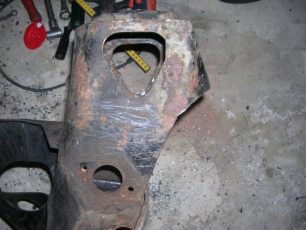

This is what I mean:
currently my subframe looks like this:
and since I dont need the bump stop on the frame, I could remove that area completely (like I have already).

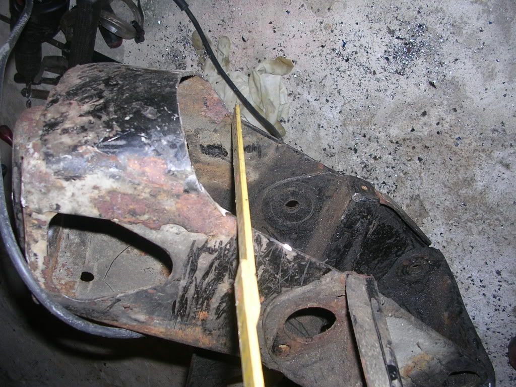

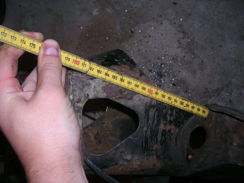

my question is then, would it weaken anything if I cut it like this instead?
(along the line of the measure stick).
And of course give it some strength back by welding in a thin strenghtening rib across here (along the stick)
looks good to me,
chop away...

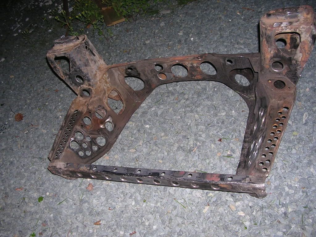

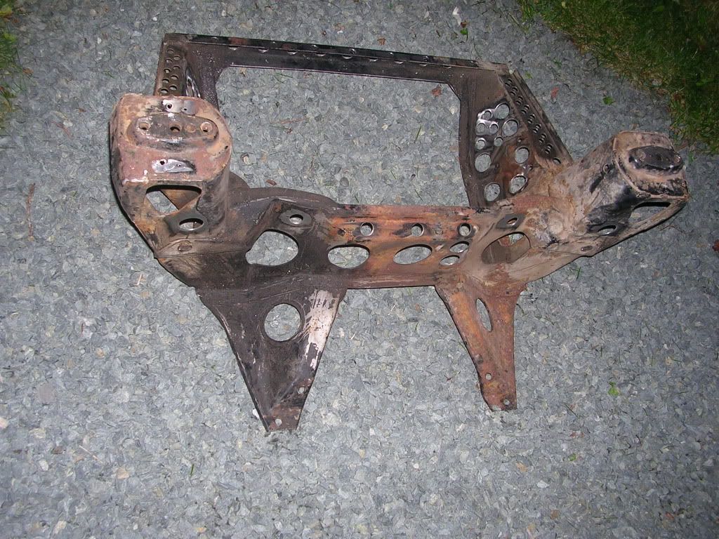

well, its done now. The frame is about 1 kg lighter than it started out now, and I have not yet used the holesaws:)
That will be tomorrow.

well, I have now removed an honest 1750 grams. The larger pieces have been on the scales, the rest is calculated using steel density and volumes calculations.
That looks good.
