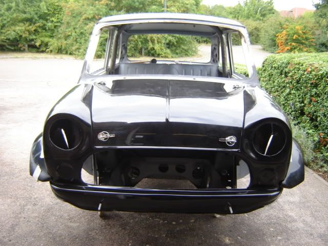

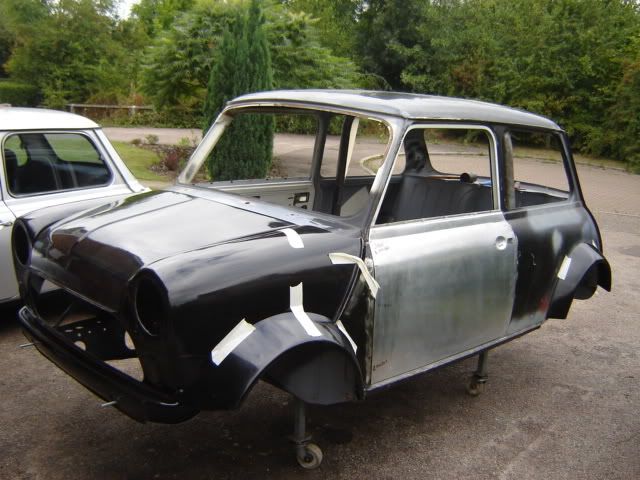

well progress is slow and steady now. i have both doors and a panels fitted now and my attension is turning to the front end tommorrow.
here are a few pictures of how it looks, i was excited to see something a bit more mini shaped!
the tape isnt a permenant fixture!
[IMG]http://i70.photobucket.com/albums/i93/andrew_waller86/DSC01611.jpg[IMG/]

bodgeit
82 Posts
Member #: 939
looking good!
especially liking the brace bars, very trick and look alot nicer than the normal ones IMO

Lovley jublies. I looooooooove miglia shaped minis and so love the car upto now.
The bulkhead looks like the iceing on the cake.

Liking your work man.
Not seen bracing from the tower to subframe before. Is it tube or bar you used.?
Also is it for strength of roll stiffness?
Si

the bulkhaed is going to be a bit empty with the K! i planned it when i was thinking of using a 5 port with a weber!
si its tube i have used, and i did it for strength. its going to see a lot of track use so want to keep everything strong yet light!

On 19th Jan, 2010 wil_h said:
nutter driver
969 Posts
Member #: 47
Not very sunny swanage
what arches are those???? looks fantastic btw.....

On 15th of Jul, 2007 at 11:52am andywaller said:
carbon miglia arches

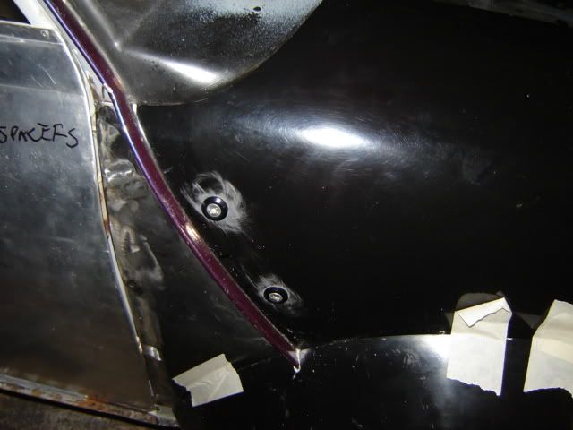

can i ask where you got the bolts holding your front on?
or have you machined them yourself?
cheers

cheers for the comments everyone, the bolts are just normal stainles contersunk ones, and im using alluminium cup washers from demon tweeks with them.

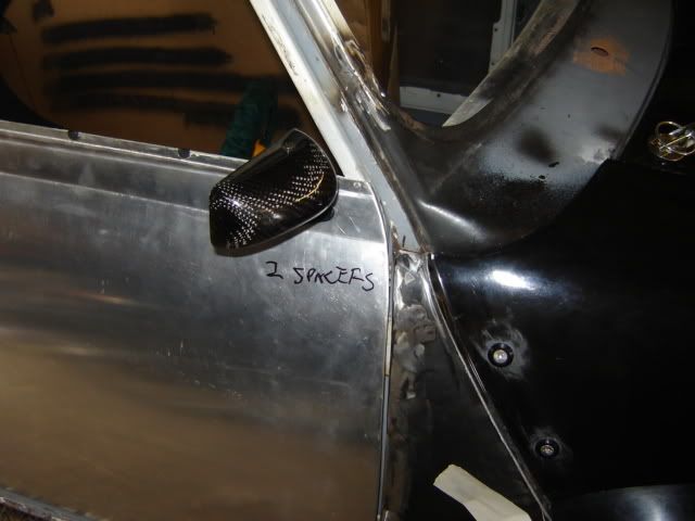

mirrors are on, and i have mocked it up with the wheels, it makes all the work worth while!

A tip with those mirrors is to get them set where you want them and then use an epoxy resin to bond them in place. If you don't they will keep moving. I had to do this on my kit car as it would litterly be loose in a mile!!!
They do suit the car well though.
