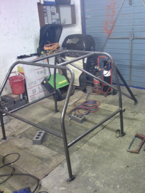

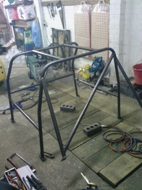

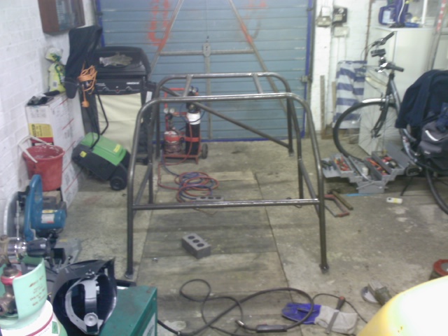

I now have a smug grin on my face!, cage is pretty much all done, all I have left to make or buy are some gussets for the door bars (would rather buy than mess around making) and I need some 25mm tube to let into the fron legs to allow the dash bar to be sleeved then bolted (having to do this as the is now way the front frame can be fitted into the car with it on, so bolt or weld in once fitted is the only options) Here are the latest pics, none of it fitted tho as I was on my own and needed another pair of hands.
Shane.
