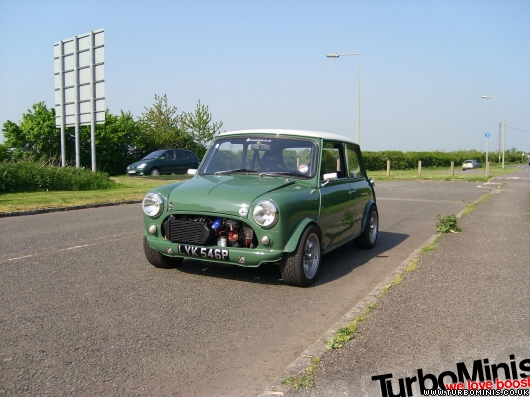

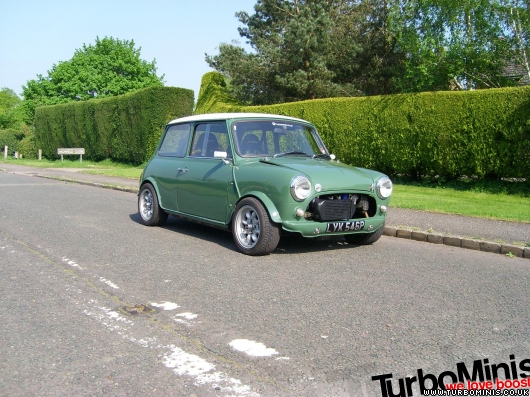

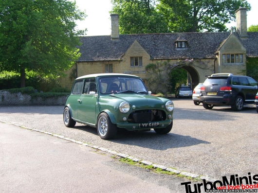

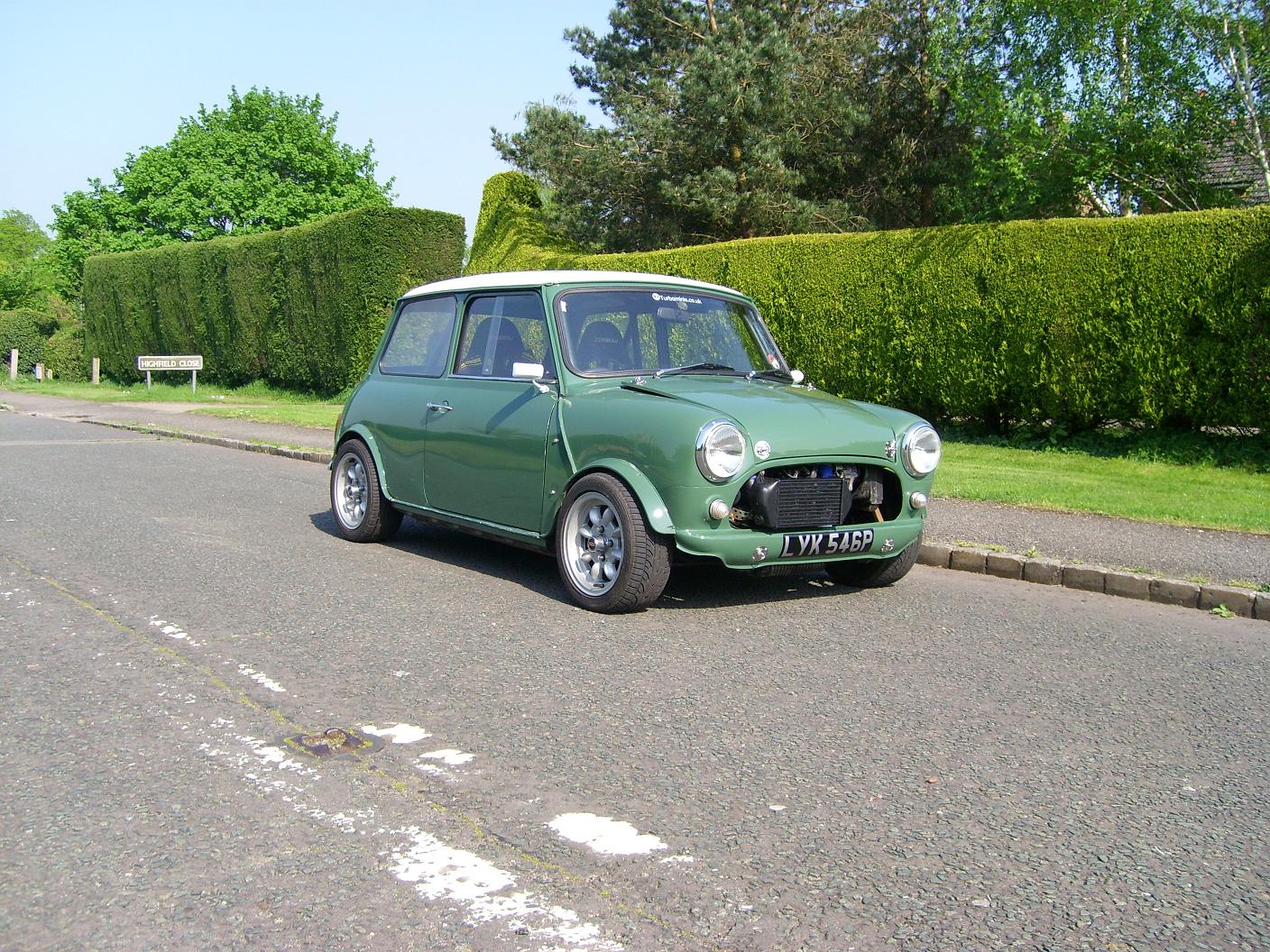

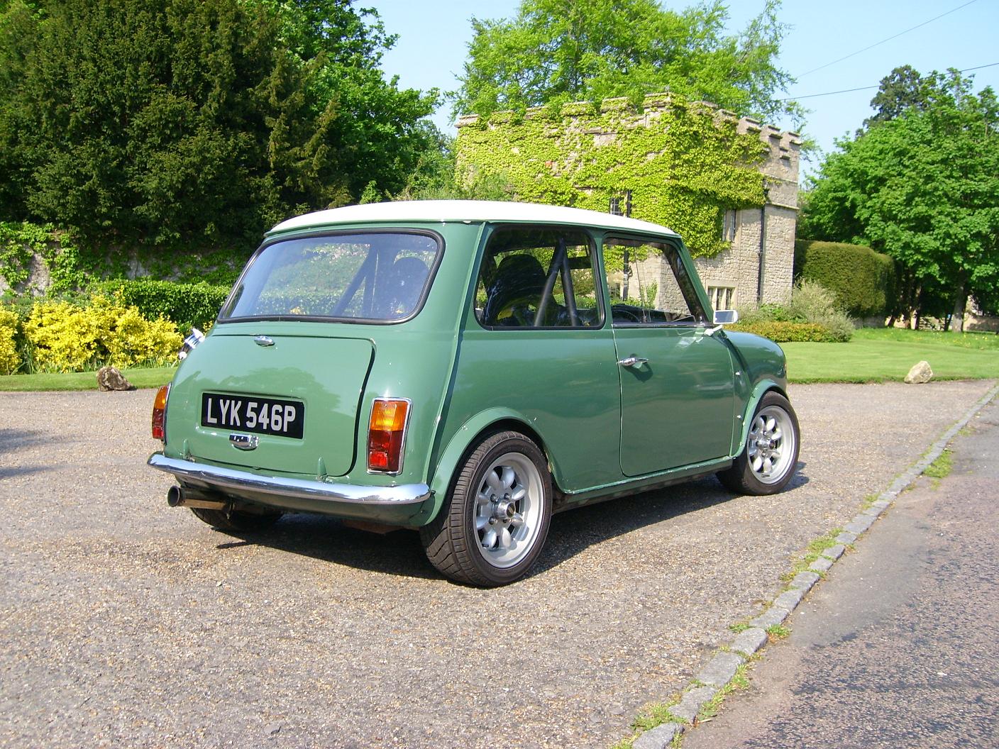

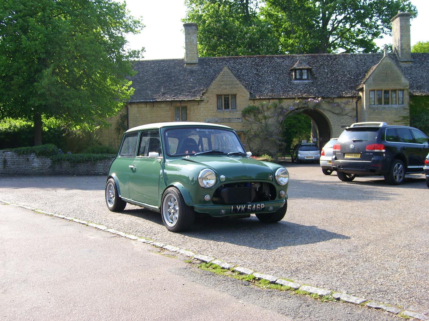

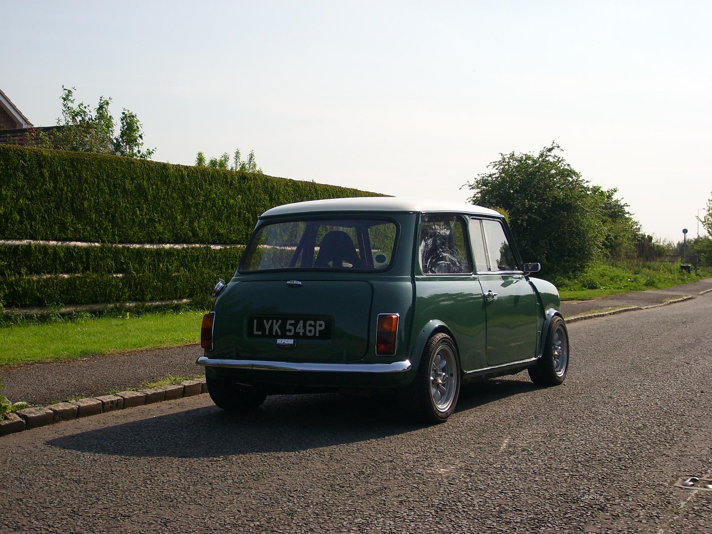

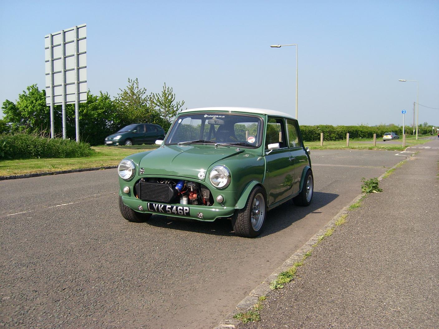

OK a bit of an update on my thread from last year where i was trying to lose some weight of the car for MITP.
a few people saw the car last weekend at the riviera run but for those that didnt i have been out and taken some photos of what the car looks like now.
i'd just like to say a massive thank you to Nic for all his time, effort and expertise in getting the mini back all one colour and looking the best it ever has done. you helped me out no end and i hope the pic of matty's sister goes some way to saying thanks! (haha sorry matt! *laughing* )
other than the paint work the only other mods since the last update is the loss of the heater (4kg without the additional water loss) and a little jap alternator from matt (2.5kg instead of the 4kg of the original).
next plans before avon park are to change the intercooler to one that fits abit better and to lose the brake servo to save a few extra kgs.

Looks wicked, as always. *happy*

Any idea on weight now?:)
edit just re-read it all, around 620kg then? not bad!!

Nice motor Ian. *wink*
On 19th Jan, 2010 wil_h said:
i dont know what it is about this car but it looks fooking awsome, that green with the wheels looks perfect :)

luvvley. nice shade of green as well.
uuhm you forgot to add the weight of the paint :)

very nice ian

top looking car ian, was getting loads of attention at the riv run. Given me something to aim for for next year.
Have you tried putting a bit more boost through it yet?

thanks for the comments guys!
yeah i tried putting abit more boost through it yesterday and the clutch started slipping... grrrrr
ive also got an oil leak that looks suspiciously like it may be coming from the crank seal so that would explain the slippage.
oh well, have got a couple of months before avon to sort it *smiley*

Whats the engine specs if you dont mind me asking? really like this car :)
its a 1293 using a few nice bits like omega pistons, t3 from a series one RS turbo using metro manifolds etc, standard-ish head just with big chambers, Lancia intercooler, SC box and drops. last time i had it on the rollers it made 157 nana's on 12psi. so not quite up there with the likes of nic at the moment but certainly enough to make it a lot of fun! once i get my new intercooler and clutch sorted i should be able to run abit more boost and see what it will do this year at avon!
