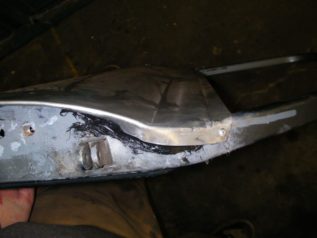

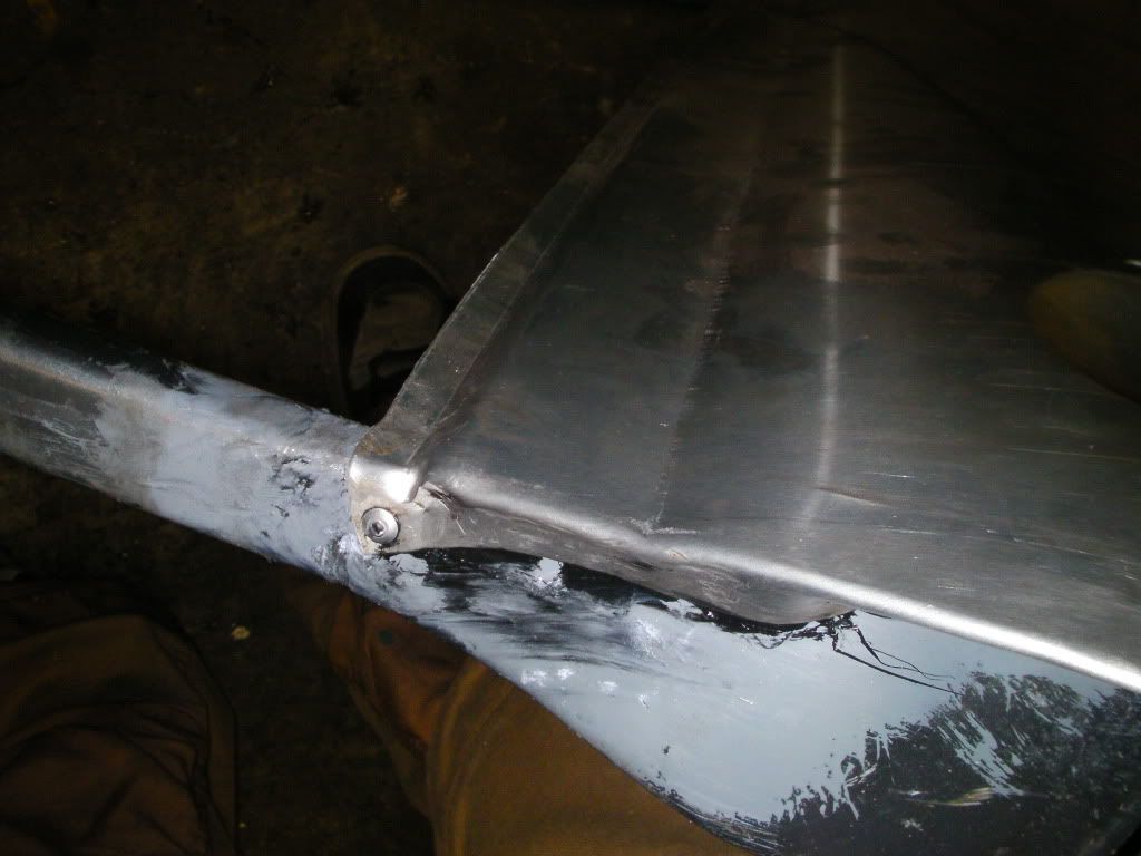

Bit more progress
finished skinning the freshly repaired door frames with the alloy panels, looks really well (miles better than i thought they would turn out), also finally got a perfect mil spec amphenol 7 pin plug for the flip front lights, been putting that off for ages hoping something would turn up as didnt really fancy the trailer plug set up.
So will wire that tomorrow, and take some pics
ordered some stainless 1/4 UNF csk screws for the door hinges just now, so hopefully have them on for trial fitting early next week. Will have to figure out how to fit the poly windows and lighten a bit further now!
off to Tenerife diving again for 2 weeks this thurs though so my dreadfully slow progress can continue then lol, shame as im experiencing a surge in enthusiasm at the moment, hopefully will still be there when i get back
Where did you get your alloy skins and how much did they cost if you don't mind me asking?

Some pics of the doors

Cool ! Any idea on the weight saving ?
"Try to take over the world!"
For comparison, I just weighed a bare steel door with hinges and a catch at 10.4KG
best buy some scales then eh? lol
