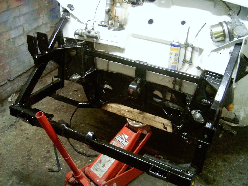

welll finally making some progress.
had a bit of a nightmare with me engine really. when i bought the half cut toyota i knew the engine was knocking and the fella gave me a spare good block. anyway it turned out that this was also knackered, doh. luckily i had bought a n/a version of the engine on ebay for £20, lol i dont know why i even bidded on it but luckily i did. now the blocks on the turbo and n/a are different everything is in the same place but there is a few differences anyway i managed to have the holes which were needed drilled/tapped. the oil pumps are different and not interchangable so ive got my fingures crossed the n/a one will be upto the job. the conrods and pistons are different but the bore and stroke are the same and the crankshaft is the same so i managed to build a complete engine to turbo spec hopefully.lol completely rebuilt with new bearings gaskets rings etc .
heres a few pics
finally got my subby finished
then got brake/clutch pipes fitted
then got engine fitted
got lots to do yet but getting there i think.*smiley*

hubba hubba carl. like the bottom pic.
subby looks good as well when its all painted up.

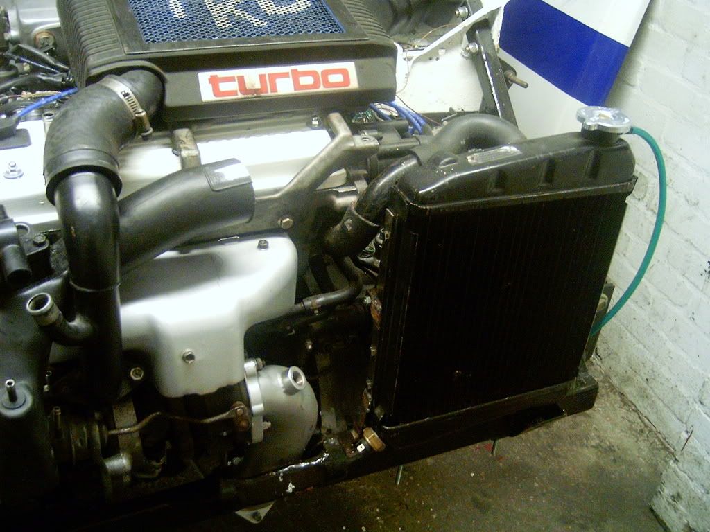

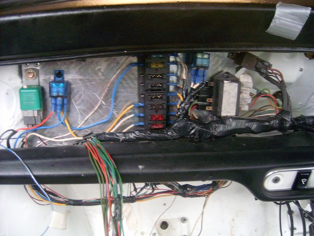

hi not updated for a while due to the fact ive bin to busy to work on mini anyways theres been a bit of progress since last time. exhaust is done (no pics) not that much to do really but the wiring is being a bit of a bugger.

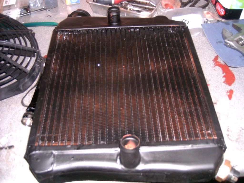

hopefully sorted the radiator out got the inlet and outlet pipes move fitted a spal fan and hoping itll cool enough.

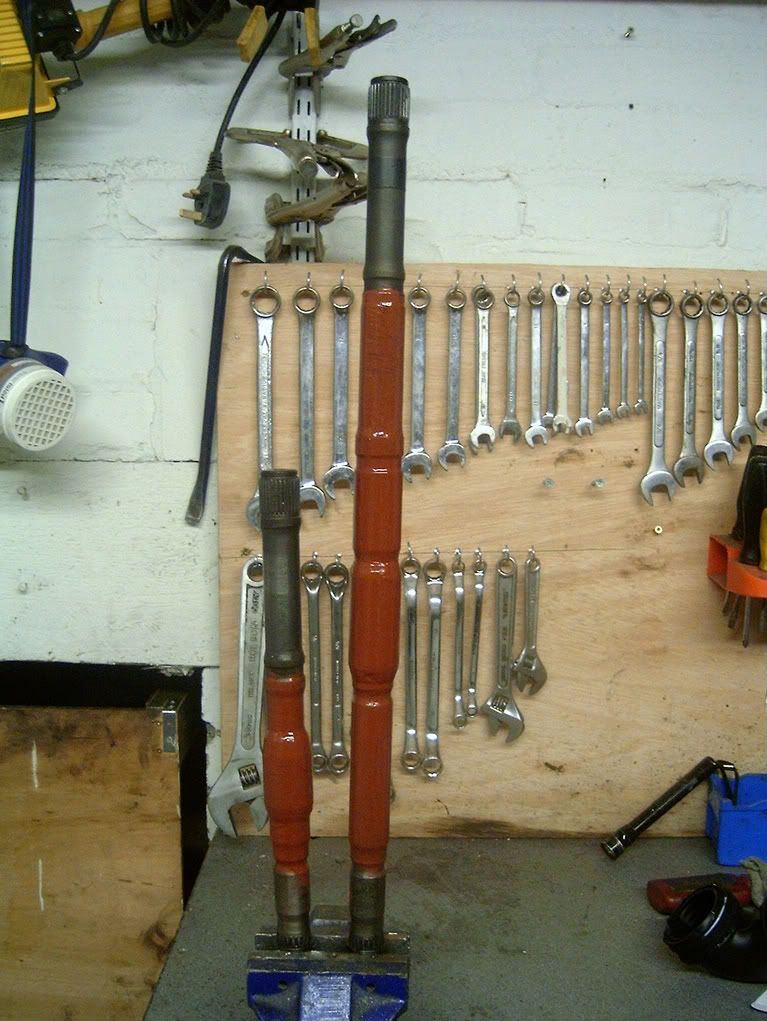

and ive got jordan to thank for these;-

how were they welded? filleted?
look very tidy

Ooo shouldn't you have some soft jaws in that vice! *surprised*

soft jaws what are they lol. jordan did the shafts so ill let him explain how he did them if he doesnt mind.

Quiksteel is a marvelous thing. LOL
Well, what carl did was cut his shafts to about the right sizes length wise, and his attempts to weld them were far from......strong.
Any way, turned a large chamfer on both shafts clocked em up and doweled em. welded the recess, machined that back and for good measure sleeved it as well.
I think i got em running better than the BL original. But i think carls having them as a temporary solution until he can afford billet ones.

well had it running for about an hour today, had dirty oil squirting out of the turbo (not put pipes on yet) at first but it stopped after a while and the engine oils new so i think it was just old oil in turbo. radiator only just seems to be coping so ill have to just suck it and see the fan cuts very often but temps staying in middle so im crossing fingures. wirings mostly done got hubs shfts in so not that far off really.

good job carl. The alternator looks well close to the wheel.
