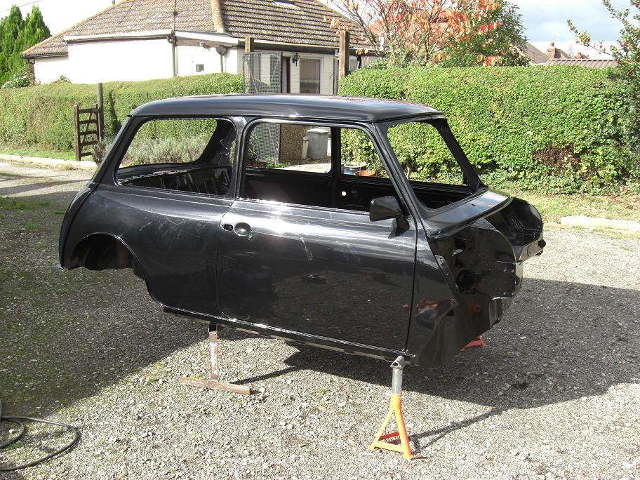

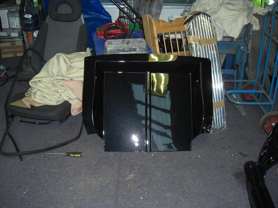

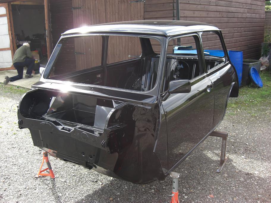

Righty, well i've managed to spend a fair bit of time cracking on with stuff. so much so that she went into Altered image coachworks for a dash of paint 2 weeks ago.
She was finished this morning so she's now home and i've started to build her back up again.
The paint is absolutely amazing its Ford Panther Black. in the sunlight it just sparkles.
then i went and got her all dirty by pouring a load of waxoyl into her. Still it has to be done.

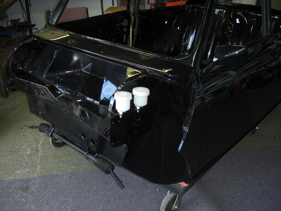

Then i got on with fitting some stuff, steering rack went in. The headlining went in loose which enabled me to put the rear section of the cage in.
But mostly i was just sitting in the garage drinking tea staring at the paint.
Anyway pics say a thousand words so enjoy:

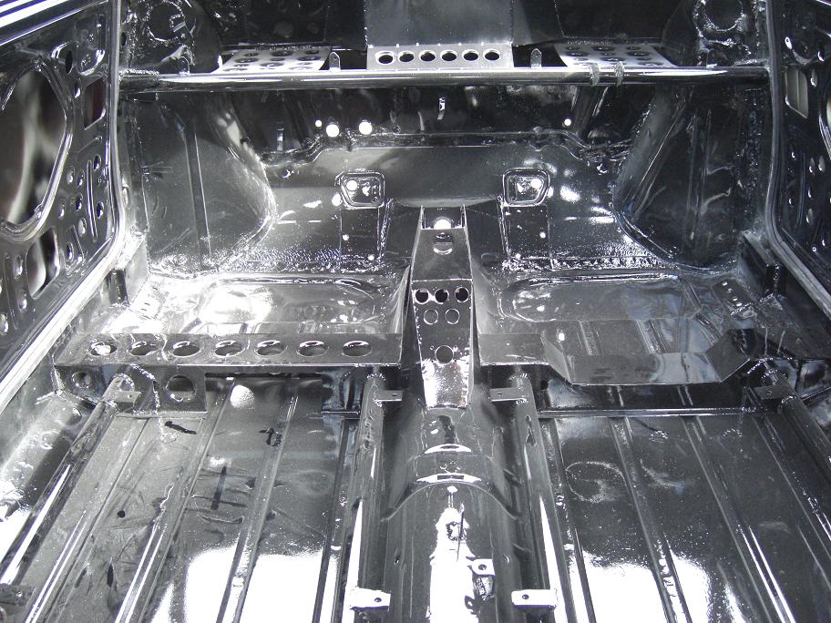

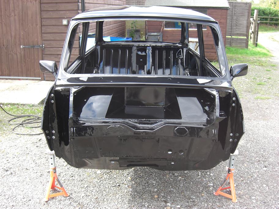

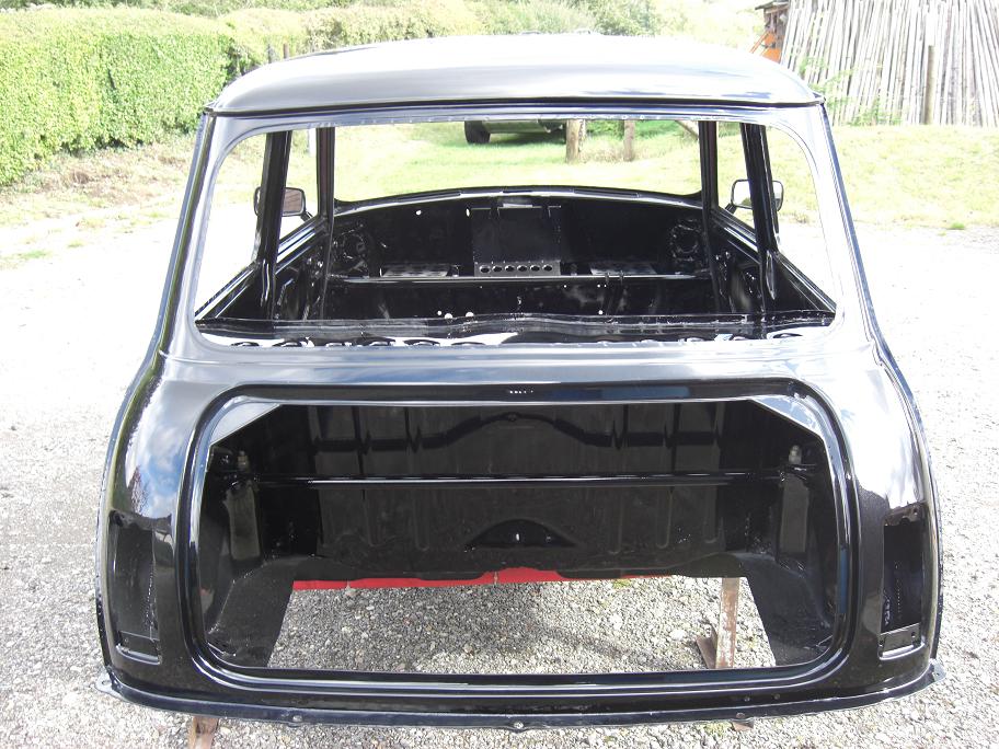

More pics

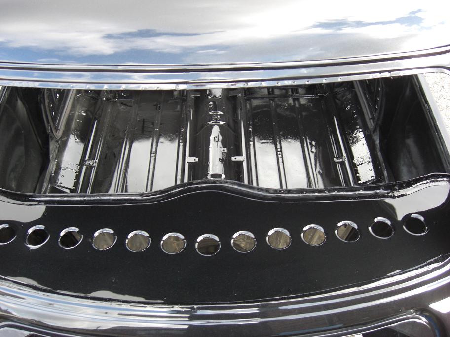

Nice!
I love the liberal use of swaged holes.

It beaks my heart a bit to have to drill holes to mount stuff, for a lot of it i've planed ahead and mounted them before paint so all the holes are predrilled, but where do you stop, i could nearly have built the entire car only to have to take it to pieces again to get it painted.
The boot floor went in and i started with the wiring, the actuators for the central locking were put in and i fitted the wiper motor.
The wiper motor is a bit of a custom job as its mounted inside the cabin behind the dash so it keeps the bulkhead free of any unnecessary clutter. A bit anal i know but hell why not i'm doing it because i can.

I don't get this though
http://www.turbominis.co.uk/forums/attachments/319362-2.jpg
The bulkheads needs to be sealed.
Lookes great though!!

it would to pass msa regs for racing Veg, but from the title, I guess this is a road car?
good stuff tim, You still finding popcorn?
Well, in my book, racing regulations aren't there for fun. I wouldn't like to have my jeans soeaked with fuel if I ever went offroading in a Mini.

At the end of the day its a road car,he isnt building it to race.Really its no worse than a stripped out standard shell with the standard pressed holes in the shelf.
Timinichelsea
203 Posts
Member #: 479
Relax guys, it will be sealed.
I'm just not using metal, there will be something showing through from underneath.
off road......jeans covered in petrol...thought you were into dit bikes? lol

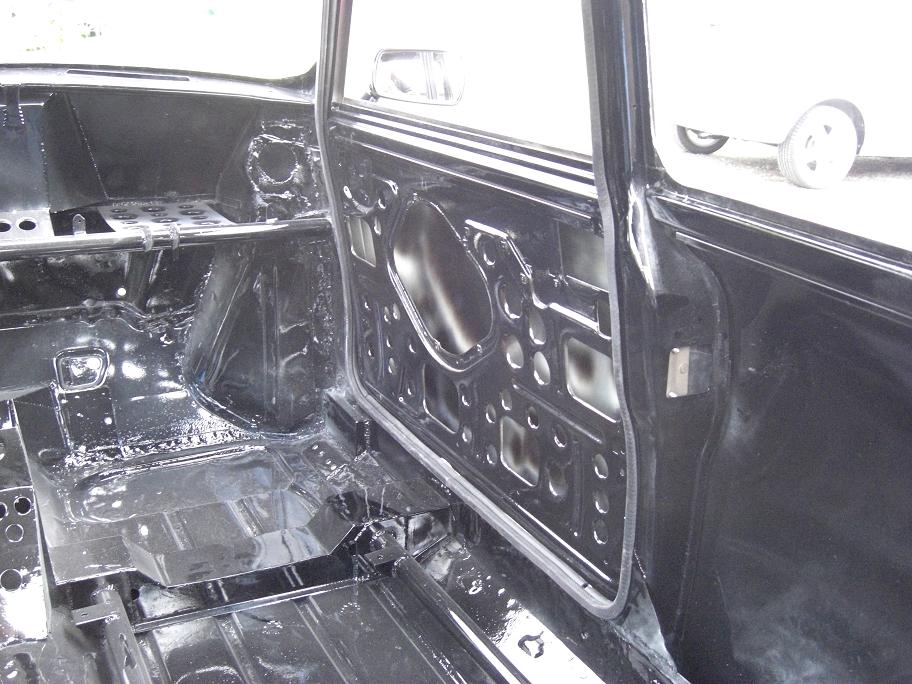

Couple more pics.
Did choping holes in the doors save much weight??

It saved a bit of weight, dont know how much some day i'll take all the holes i cut out to work and weigh them, but i dont want anybody to see me as they may think i'm a bit (even more) tragic - but mostly i just like cutting and swaging holes.
Yep headlining went in loose and all the bits of the cage will be put in then i'll tighten it all up and stick it down.
Last time i put a cage in with the headlining i ripped it in a few places, so i wont make that mistake again.
