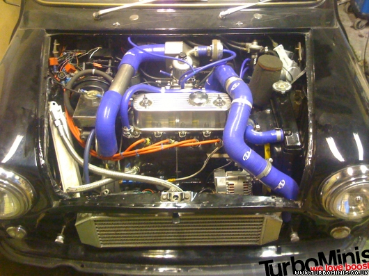

Just a bit of welding to the intercooler (Cheers Joe mini13), calipers (Cheers Andy W), then it should be pretty much done.

The spec so far is...
Engine:
A+ over bored 20 thou fitted with Avonbar Accralite 18cc dished pistons. cam 5851 (or whatever it is lol) crank with center main strap. Phase2 camshaft. powerflow oil pump. Duplex timing chain with vernier adjustable gears. Benross Full race head, 26cc Chambers Fully ported. 1.3 roller rockers. T3 turbo. In-car adjustable boost. Benross modified elbow and manifold. Maniflow Exhaust. Nic plenum. Forge dumpvalve. Allard intercooler. Minispares super 2 core rad. Metro turbo fuel pump with fuel lines running inside car.

The red leads really bug me. Does anyone know where I can get some black or blue ones of the same length? All of the ones that I've seen are really short.

I got some black ones from a local motor factors that reach to the inner wing.
Cheers Matty. Do you think that they'd reach the bulkhead?
get a black marker and get busy lol,
intercooler does look like it fits well!
I think i'll definatly pic one up for mine at some point.

IC fits a dream, just need to trim a little bit off the slam panel to get the pipe on the rad side comfortably. Thanks again for you help mate, I couldn't have done it without you.
Only thing that I'm a little worried about is the airflow to the rad, as I'm restricting most of the airflow through the front grille.
should be ok,
miniwilliams for example runs an intercooler that covers the grill area, and has a tad more power lol.
Should be ok then. Matt has got a holey bonnet though.

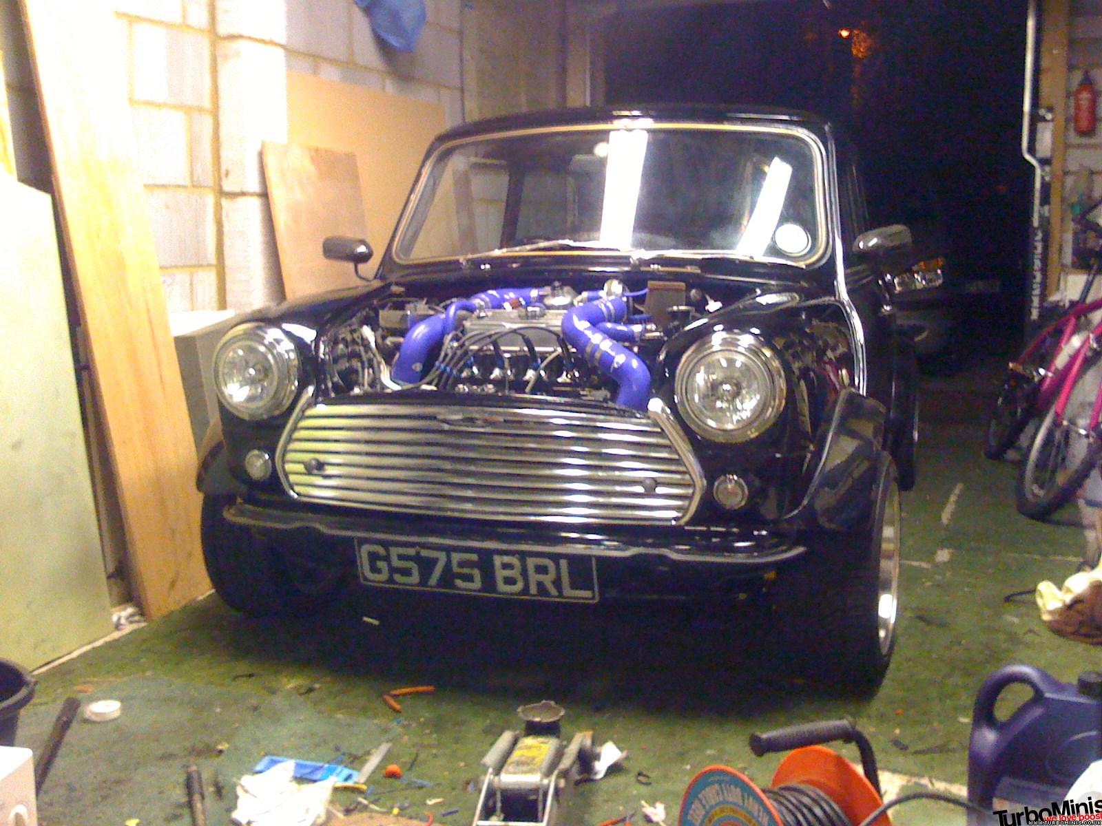

I started the car for the first time!!! Fired up straight away!
Sounds totally awesome! apart from the rockers hitting the cover. I have ground as much as I dare off the rocker cover and pushed it as far back as possible, but it's still catching somewhere.
New rocker cover on the shopping list then.
I'm pretty sure that the fuelling etc is close as it was set up properly on Carls car, and the only thing that has changed is the head and turbo (same turbo, the one I had did not has as much play). But I will still take it for a rolling road session as soon as I've got it mot'd.
I'm really excited now and relieved that everything is looking good, no smoke whatsoever and good oil pressure.

Tried pushing it back as much as possible, and ground loads off the inside-back, but it still catches. I would think that it's because the head has had a skim to get the compression back up to 8.4, thus altering the angle of the rockers slightly. With the MG cover, it is fine, so I'll either use one of these or get the Minispares 'clears all know brands of high-lift rocker' cover.

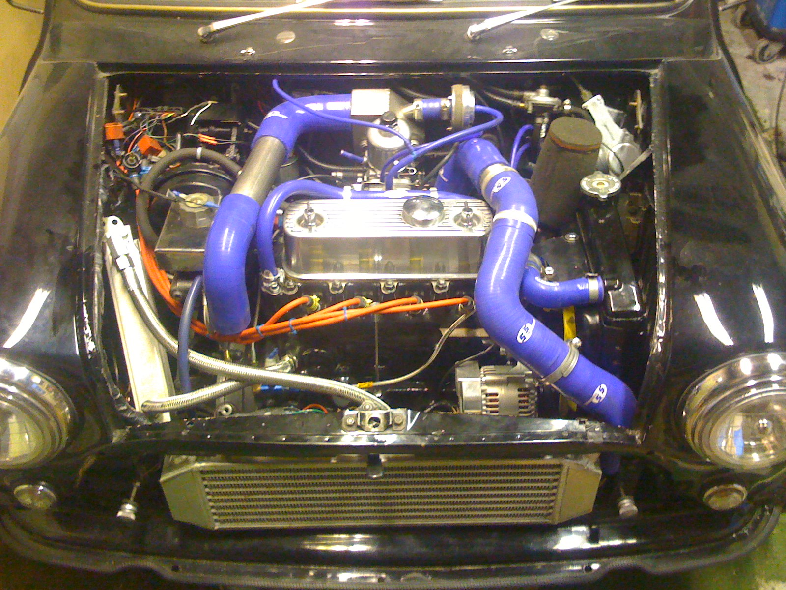

Mot Tomorrow!
All seems well, other than the under bonnet temp being a little higher than I'd like.
Once it's legal, I'll be getting the suspension setup and then onto the rolling road next week. I think that a new rad will be on the shopping list, but I will be trying a heater matrix in the inner wing first.
