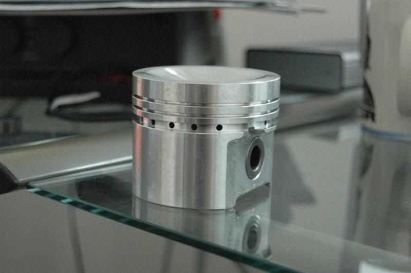

Woo hoo! Arrived today after the UK post office balls up
Look great, no slots in sight. These are for a temporary engine while I save for a 16v, hope to get them in for machining next week.

After a few emails with Andy I've also ordered a set, BUT, he tells me only the +094 and +114 have the oil drain holes as shown in dn98mini's photo - the std/020/040/060 apparently have the dreaded "slots" shown much earlier in the thread.
I've gone up 2 sizes on what I could have got away with on a rebore to get the better ones (094 in my case).

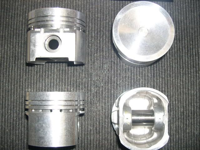

The 1275 +094 and 114 sets look like this:
Please note unlike the 1275 STD/020/040/060 these have holes behind the oil ring not a slot.
Thought I may bring this to your attention.

Well mine arrived today (1275 +094", ie, 73.0mm) and is the better design (I confirmed this with Andy for the 1275s before buying)
Whether the smaller ones (normal oversizes) COULD be made to the same design is a good question, I've sacrificed one (maybe two) rebores to get this design.
