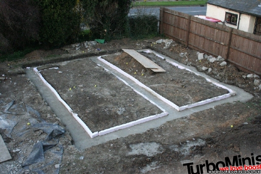

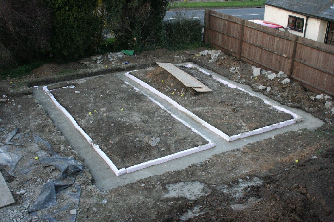

Well things have moved on, but not with the mini. My garage build has started and the footings (or ground beam as it happens) is in. The propper building should start after Easter.
http://www.twin-turbo.co.uk

2 garages?

I will have 2 garages, but the one you see is a big double. I will put up photos as it grows.

O/T why do you footing down the middle?
Probably to tie in the walls as its fair sized garage.

What you see is a ground beam on top of pilings. On to that I am putting a block and beam floor. Without the centre section I would need 6m beams, which are expensive. With the centre section I only need 3m beams. It all sort of makes sence.

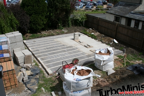

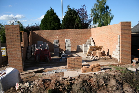

Finally the garage has started to be built properly. The floor is now down and the walls will start next week.
if you dont mind me asking ben, what does a build like this cost?
What is the advantage to a block and beam floor? Over a concrete floor? Or do you have soft ground or something?

Answers in order. It is costing me about 18k (ish) and will hopefully include the driveway too. I am sure it could be done cheeper (see the answer to toms question).
I am having the block and beam floor because it was cheaper. My issue was that I had pilings to allow for the clay and trees so a block and beam onto of the pilings and ground beam was slightly better.

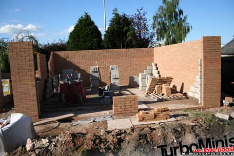

Things are moving along slowly.

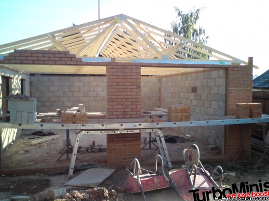

Carp picture, more progress. Any time soon I may be able to get on with the car. Not sure I am ready for that!
