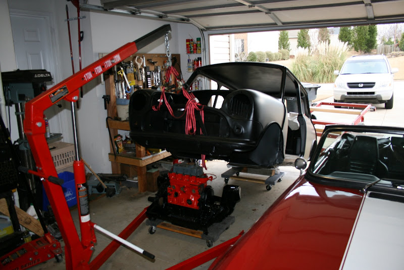

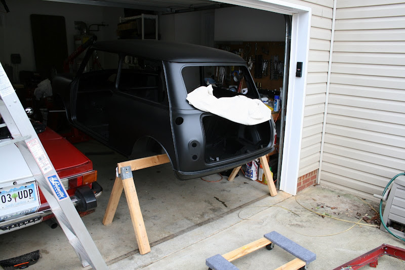

Put the engine in the car so that I could start fabricating the header and to figure out which turbo to go with.
I like the flat black against the red!

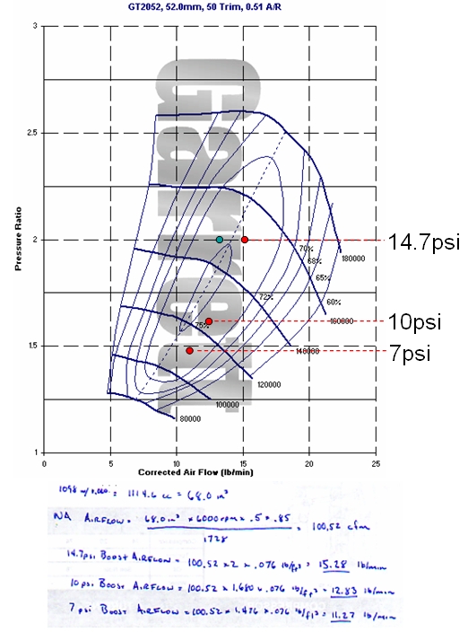

I am down to the turbo selection, I have been reading old posts for a while now and I think I have settled on the Garrett GT2052.
The engine is 1098, +.020 bore, Max Rpm is 6000. I am more interested in quick launches, not to interested in high speed. I have not settled on the boost, so I was looking for a compressor that would allow me to increase the psi and still work well.
Any opinions or suggestions are welcome!

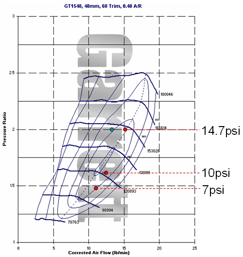

With respect, I think your air flow calcs are incorrect.
For a 1098 at 6000 rpm on 14.7 psi boost with a good intercooler, I get 13.7 lb/min and 132 hp.
Mikes1098
152 Posts
Member #: 2190
South Carolina, USA
Thanks Paul! I somehow slightly shifted the picture behind the dots -- I corrected it and added my math. I put the blue/green dot at your 13.7 number. If that is the airflow, this turbo is starting to look too big -- I may have to go to the GT1548.
You mind looking at my calculations to help me find my mistake? Thanks.
Your calcs do not appear to take account of the density change due to temperature.
This is how I do it:
You could use the Gt1548 which is a modern equivalent of the old T2 or you could consider a GT1752 from a Saab.

Thanks Paul -- I will have to study that other thread. I did not think you had to take in account of the density change if you were sucking in ambient air, now if you were sucking in engine compartment air then there would be a clear density change.

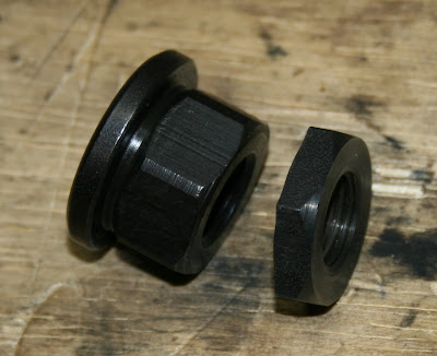

Found a new plunger stop nut for the clutch.

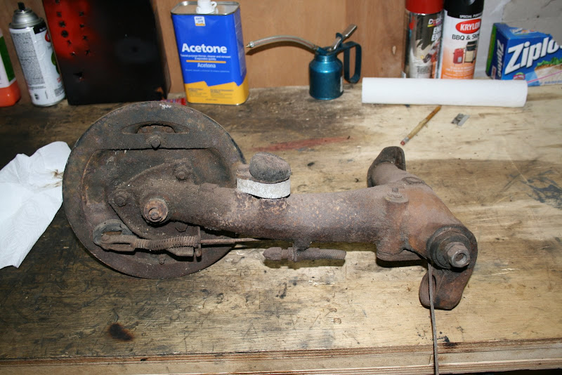

Started taking apart the rear radius arms. They are in rough shape.
It's the density change due to temperature rise through the turbo and then back down agian through the intercooler rather than changes in intake temperature. You need to work out the density of the charge as it goes into the cylinder.

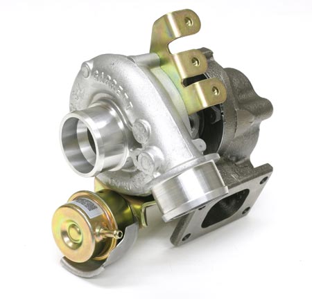

Alright boys, bit the bullet and ordered the turbo. I settled on the Garrett GT1548 - 466755 - 3.

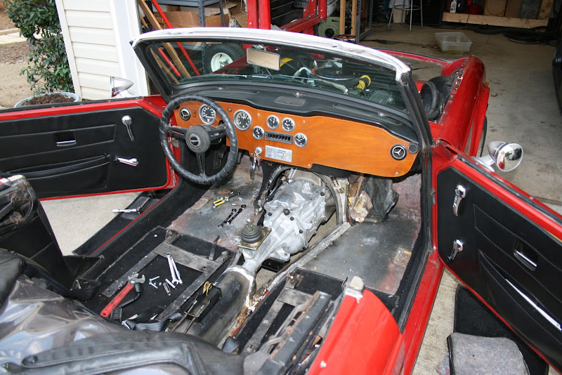

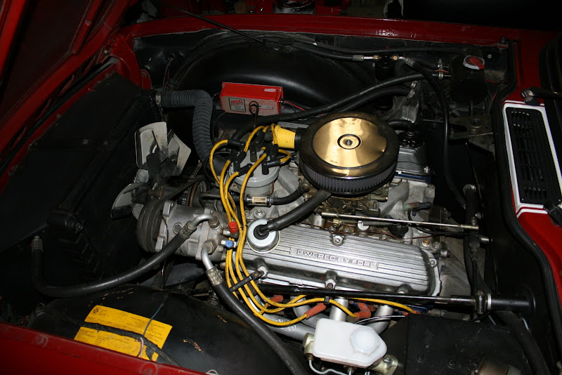

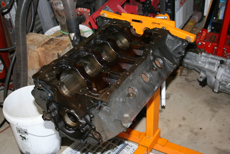

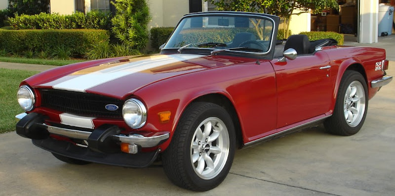

Some may know that I have a TR6 with a 5.0 liter in it. This was my first project and have been driving it for almost 14 years now.

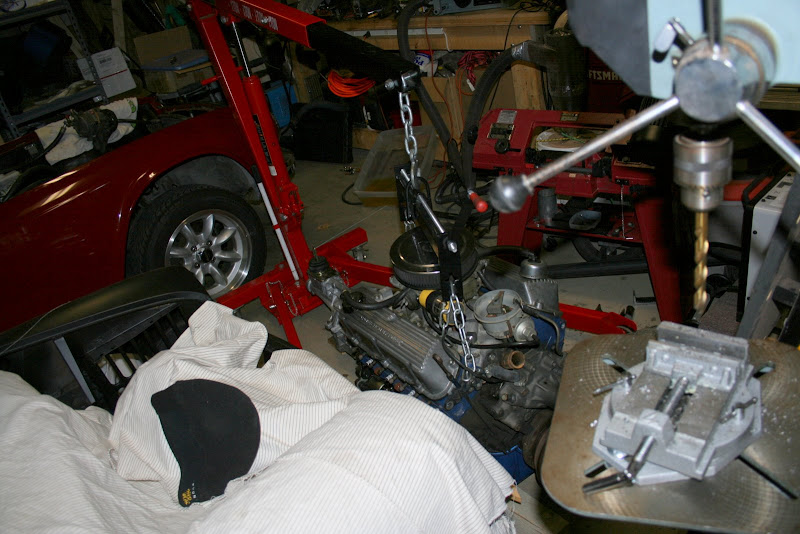

After many miles and plenty of abuse, I finally managed to spin a bearing so the engine must come out.
The was a picture before I started tearing it apart.
I am committed now.

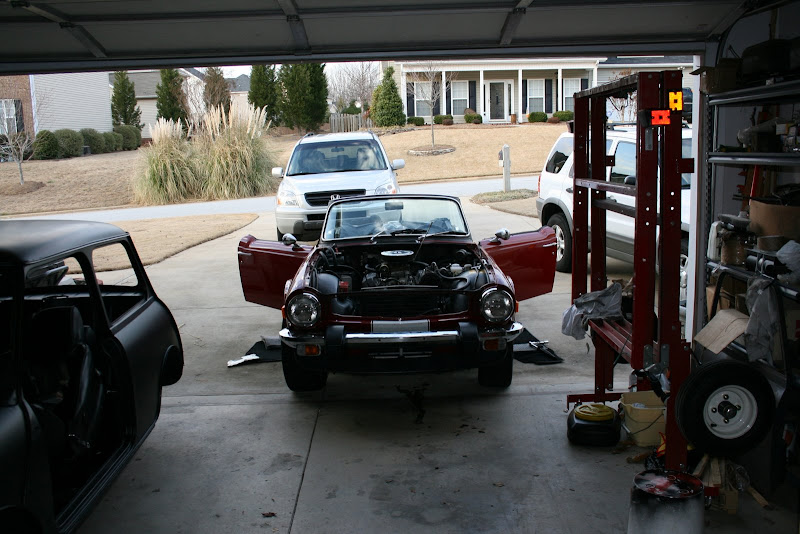

It is official, I need a bigger garage. I got the engine out just as it started to rain, so I panicked and shoved everything in the garage. I am amazed it all fit.

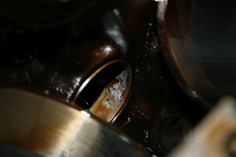

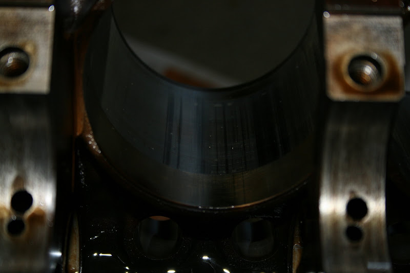

I got the engine completely torn down. Overall it looked pretty good, just worn out. Then I found what was making the noise and causing my oil pressure problems -- a CAM BEARING! It clearly got starved of oil at one time. I have never seen a cam bearing go bad before.
The bores did not look that bad, we will see if I can get away with just a hone.
