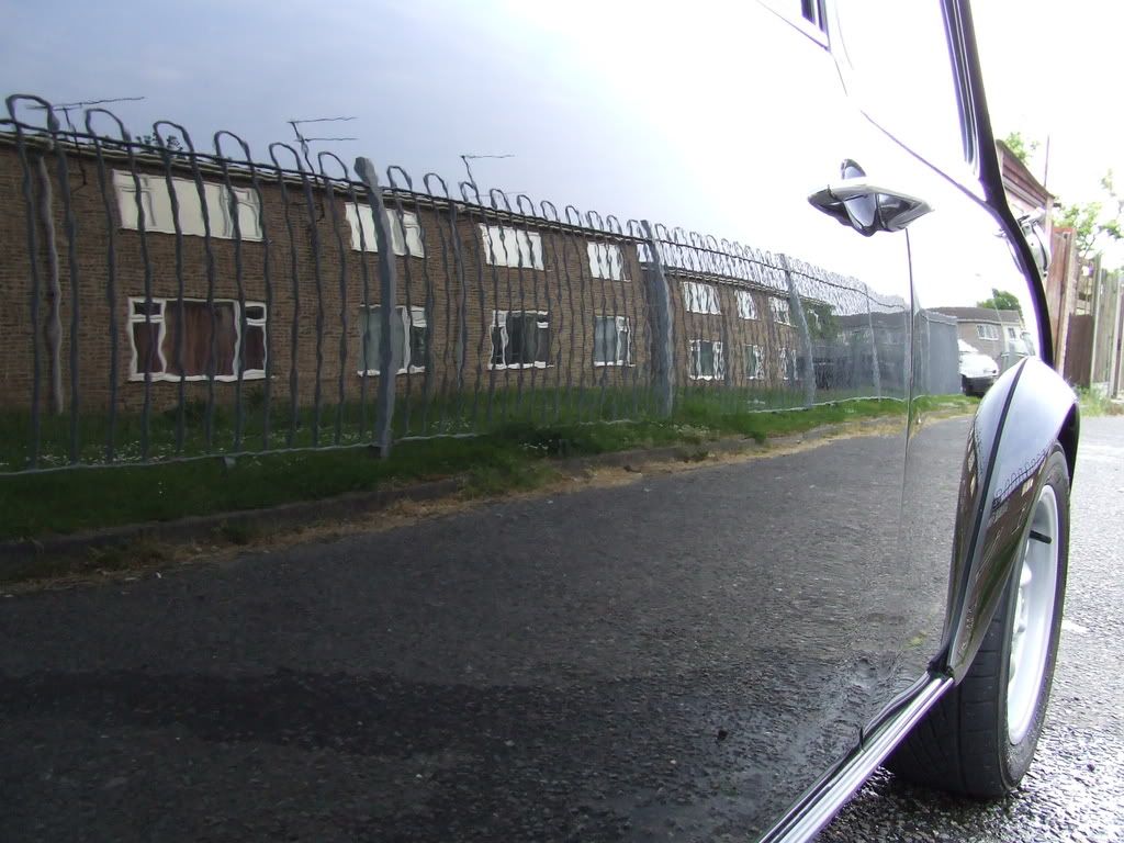

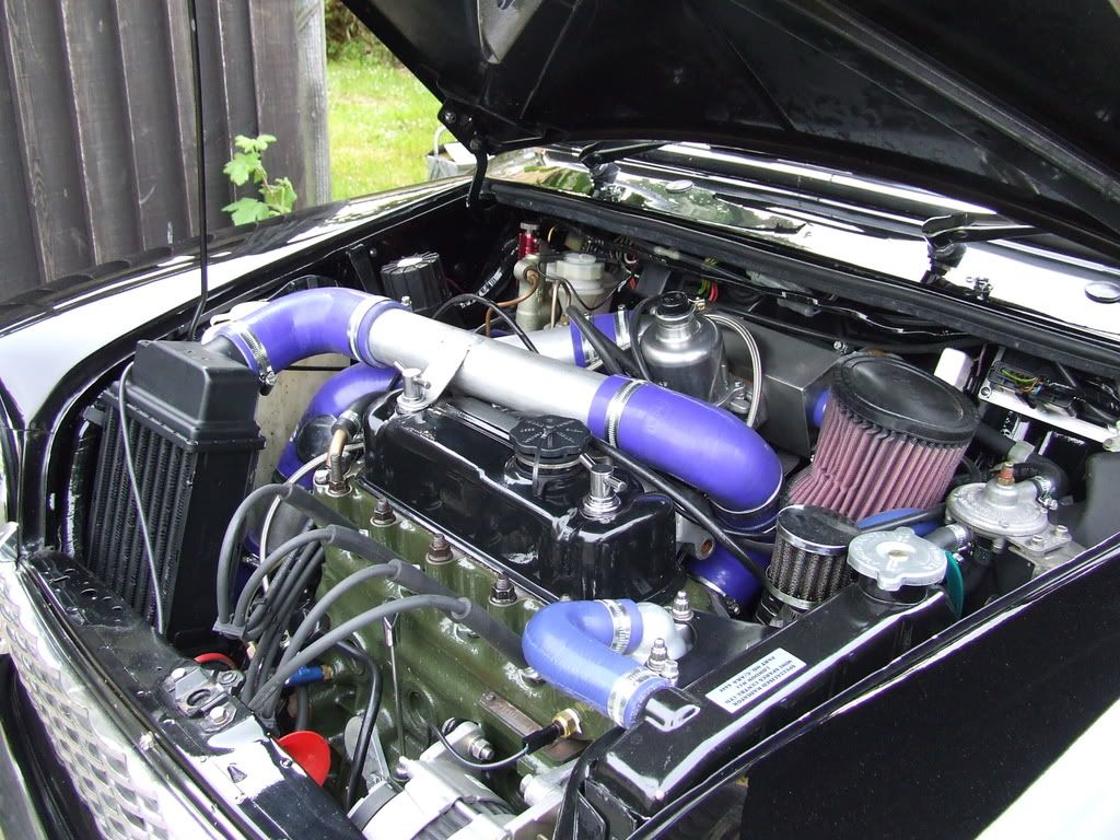

Well she is all finished (for now) and shiney, fueled up and ready for london to brighton. Just thought I would post a few before and after pics.
before
After
Im well chuffed to say the least, its nice to see her without the red mirrors bonnet stripes and coachline, a welcome change.
Shane

that looks so nice. I love how it is still really standard look, no holes hacked in it etc. *happy*
MarkGTT
3249 Posts
Member #: 1194
Shropshire.
nice and tidy, i like it! *happy*
giallofly
4436 Posts
Member #: 164
The Stig..
Newport Pagnell
That is a realy neat install, well done.
