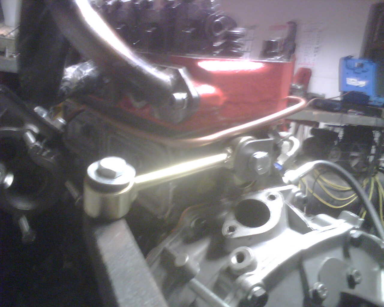

My dash arrived on Friday and we got some grinding done on both manifolds yesterday. pics:

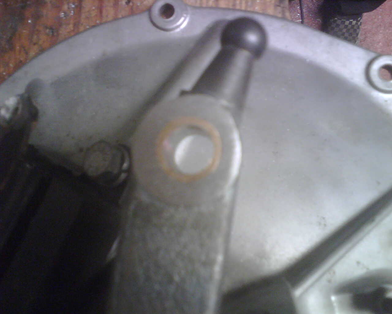

We where Buse boys today we got trough loads of problams that have been causing lack of sleep. Gary will post some nice pic and a bit more, info later I just taught Id upload this picture of the late inovation we came up with.
we have increced the pin size and bushed the arm will be intresting to see how this holds up.

Cheers Paul, here's my pics
Bushed clutch arm
Inlet manifold all ground out. The exhaust is done aswell. Both just need external grinding now

looks good
did you build up the end of the arm with weld or something?
why didnt you just offset the bush?
GaryOS
1424 Posts
Member #: 2810
Formally spanner181187
Dublin, Ireland
Nah, its a new arm so no need to build up weld. We just wanted to try to reduce friction at that poit to hopefully reduce wear. We'll se what happens

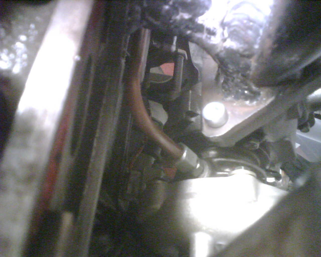

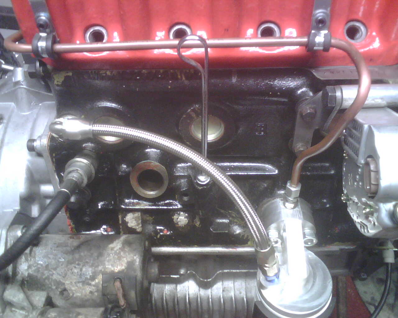

Due to college being gay I've only got to work on the engine once in the last 3 weeks. So here's what I got done:
Turbo oil return
Dizzy bung/breather. Not finished yet

be careful you dont attached the turbo too rigid in too many placed, it might want to move around a shade when the manifold gets hot
