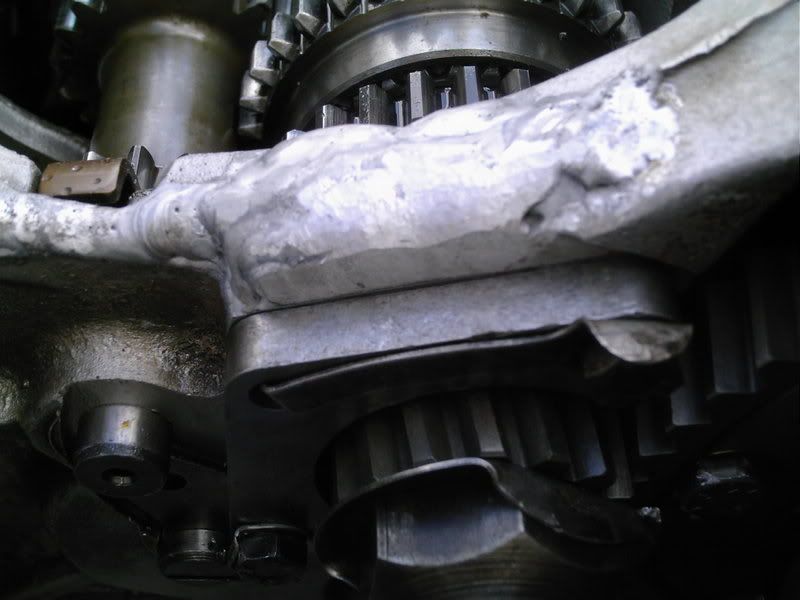

all back together as Tom popped up and gave me a hand to get it up and runnig ,

Might seem like a silly idea....
but is there enough material to drill through the webbing from the diff area, tap it and screw in a HT steel threaded bar ? ( an 90deg to mainshaft )
Or build a much larger steel C-clip, to cover more and secure to more of the web , and perhaps the layshaft to a degree ?
Or similar type of internal brace ?

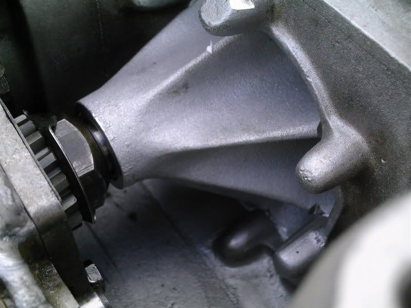

Looks just like the KAD mainshaft support that TD does not favour?
On 5th Sep, 2011 Vegard said:
yes nice one guys glad she is back. as for the top photo, i've never seen one of then main shaft support things before, any more info on it mate?
http://www.kad-uk.com/gearbox.htm
Lot's of info here:
http://www.turbominis.co.uk/forums/index.php?p=vt&tid=9221
Edited by Rob H on 5th Aug, 2008.
I am not saying it's bad - I'm just saying i'm not convinced of its benefits at this time, and it could actually be not doing as much good as we think. I guess this will be the ultimate test.
I'm going to have to do some bloody anaylsis on this I can tell... *frown*

i knew what you were getting at Dave with regards bearing loading ,
but felt i had to give one a go,
now i am more than inpressed with the support housing , but not with the product as a finished item but more so for its fit,
after following the instructions from Colin at KAD, which was to build up the mainshaft dia with weld , a little at a time to not distort or bugger up the heat treatment, then turned down to accept the hardened sleave that the needles run on, with this done and the sleeve tapped onto the end of the mainshaft,
i espected the housing to need a tap home due to any tiny missalignments in the case and the cover,
it was not to be, it dropped on practically under its own weight,
i would descride the fit as "perfect," nothing less, .
carl
From what i remember of daves coments on the kad support (correct me if i'm wrong as i can't be arsed to go and find the thread) he said that he thought it would/could cause the bearings to be loaded up more and would hense be a backward step,
however, I guess in this case wearing bearings out quicker would be preferential to punching the diff through the back of the case.

cheers for the link Rob, i mut have mist the post.
your comments put me straight off Carl. So not a straight forward fit. and no speedo drive.
Speedo still driven in the normal mannor?

theres all the bores in the casing for the speedo drive, but ive bunged them up,
yep, from the front engine, lol

has this welded case been used in anger yet carl?
I'm prepping a 4 bolt (remote) case at the mo and am wondering whether to do this while its apart....
What grade rods did you use?
Its done more than run in anger, its run a 10.83!
