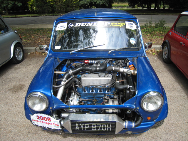

On 28th Aug, 2008 Minibar72 said:
Nice! This Swede is also infected by the turbo-bug:
