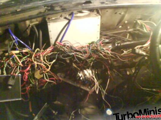

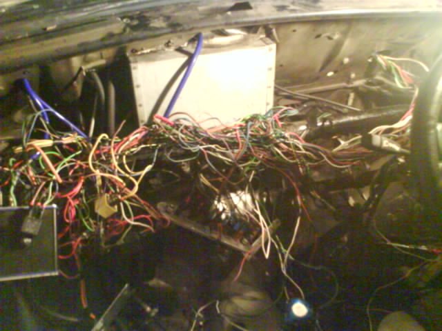

Thought I'd best sort the loom out once and for all, it was like an explosion of wires.....

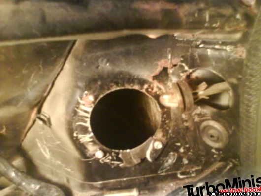

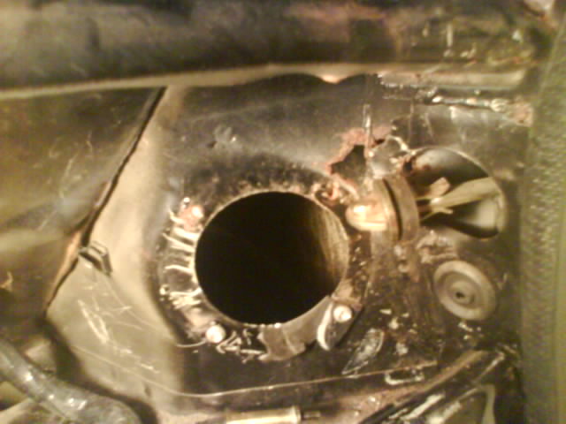

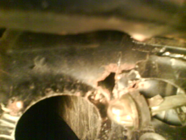

Found a couple of bits of rust in an awkward place, not sure what to do with them? Any suggestions of how to sort it? *oh well*

HOLY COW!!!!!!!!!!!!
Whats happened behind your dash? has a silly string can multipack exploded?
HAHAHAHAHHAHA
i reckon about 5 golf balls have commited hari kari behind there !!
The spaghetti I had for dinner was laid out in a more orderly fasion than this! *hehe!*
Im pretty much starting from scratch, got to be about 10-15m worth I can chop out I recon.

WOW! thats erm... a mess lol
The rust get some dremel action on it, cut out the rotten bit then go over it with a wire brush in a drill or something easy to get in the gap when its out and sorted weld a small plate in *happy*
just think of it this way, if i didnt start this weight loss the rust would of got worse and it woudl of been harder to find and sort it all then *wink*
Rust is heavier, it contains oxygen *hehe!*

The only thing is the rust goes past the kind of door post section (not sure what its called) If I cut the top off to get to the rust behind, would it be okay to leave out? Im glad ive caught it ealry though.

Twisted Fire Starter
It was quite neatly taped up, but then one thing lead to another and after an hour of foreplay it ended up like this. Lol
Edited by matty on 5th Nov, 2008.
eeeeeeww ,,,sounds like theres one photo hasnt worked ....thank god !!
Thats not rust. Its honeycomb racing metal *happy*

Thats a shitload of wires!!! My loom is like that, but just not as dense lol, need to sort mine out properly really but tangled wires/extension leads/shoe laces really piss me off haha!
Holes are lighter than solid metal *wink*
Edited by richminiturbo. on 6th Nov, 2008.
I managed to get 2KG of rust out of the gaps in the plated over plated floor pan on my mates 1275gt. I just couldnt believe the mountain of rust that was on the floor after I had brushed it out!! It was no surprise then when there was nothing solid to weld to. LOL he said just patch it up and I said you just cant weld to fresh air.
isn't rust lighter than titanium?

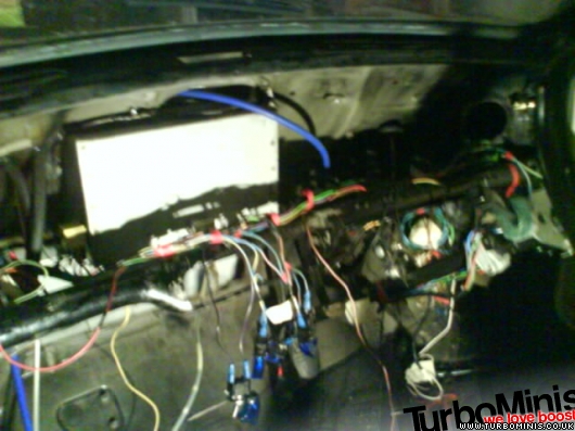

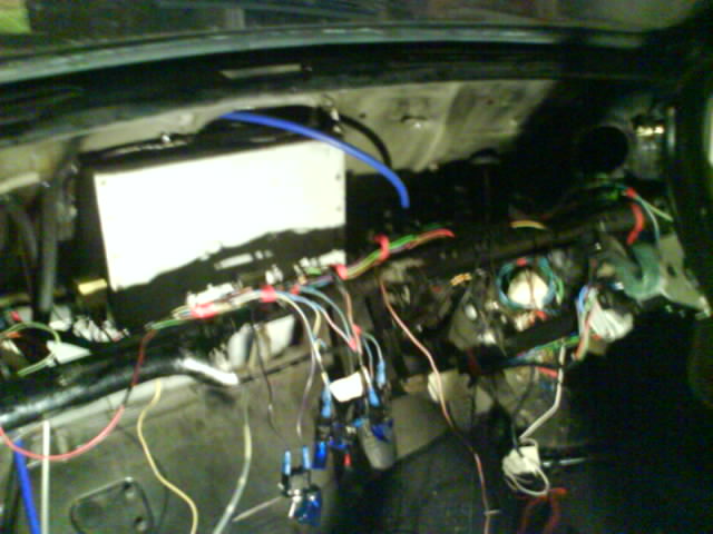

Haven't managed to do too much more weight removal as the wiring has taken all my time to sort out. Ive got about half the amount of wires than before though. Lol
Thanks to Paul Wiginton for giving me the spare loom, I managed to rob most of it to make a good loom up!
Still need wrapping, but is much neater than before!

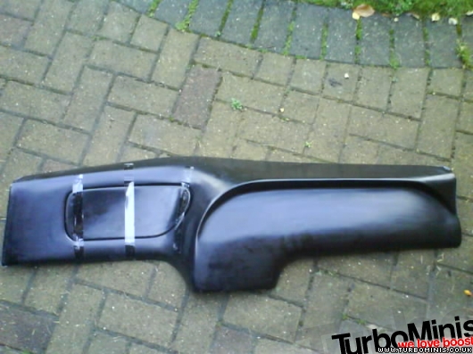

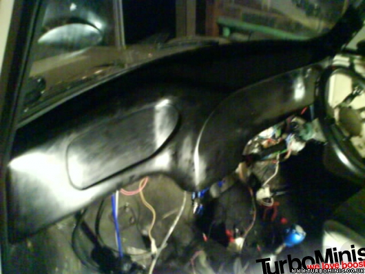

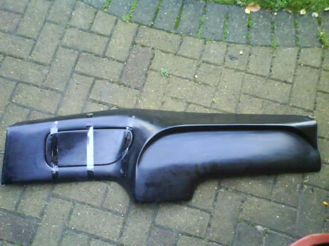

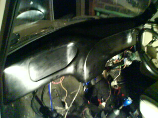

My new dash to go in.
My new dash in place...just need to work out how to fix it in? *Confused*
Edited by matty on 10th Nov, 2008.
i bet the wiring save quite alot though?
dash looks gurdddd. oh and cant see the clocks...just me??
True, I haven't weighed to bag of wires yet, probably a fair amount in their though!
The dash is a damn good fit, will need a little tweaking, should look good flocked! *tongue*

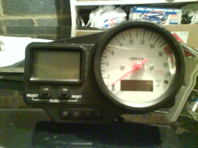

How are you sorting the speedo Matty?
I have a cunning plan, just need to work out the frequency
Mine runs on a +5v-0V signal, so im going to use a VR sensor and toothed sprocket. I need to find out what the gear ratios are for an R6 then I can make the sprocket the right size to give me the correct speed. *wink* Plan B would be to use one of them frequnecy converters to get the speed calibrated and use some kind of pulse generator.
Whats Your plan?
I have a speed sensor off a Rover which looks very easy to adapt to the Mini speedo drive. Need to work out the frequency of the speedo set to work out what drive gears are needed.
Little fucking around *wink*
I was looking at the Suzuki GSXR workshop manual, and the speed sensor is on the gearbox output. I cant quite work out the reluctor profile, but its not much bigger than the retaining nut.
The Rover speed sensor is 12v though, not sure about the clock set, but i am looking at something off a car anyways now :) still need to resolve the speed sensor issue though
