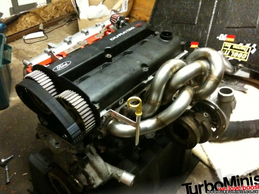

Bare engine was a £grand, Turbo free, Throttle bodies/Plenum/Injectors £75 all in, Manifold £350 for a favour (normally well over double that!)
The rest of the little bits were robbed off the old engine

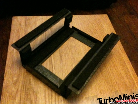

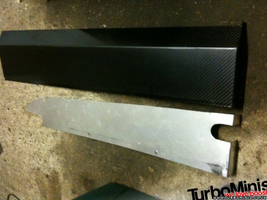

So ive started remaking the bits im not happy with. Made a new ecu bracket and fitted both side 'parcel shelves' yesterday. Plumbed in the vac system to the Throttle body setup, fitted the MAP sensor to a new bracket.
Ive also made a template so I can make the door skins and rear quarters from carbon. Looks easy, so will make a panel next week and see how it looks. I want the structure of the steel door to avoid all the annoying problems with that, but will re-skin the door with 0.8mm of carbon, leaving the steel body of the door to support it.

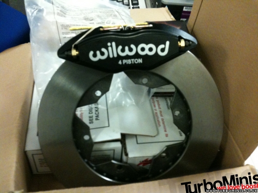

And with some help from Mr Wakely Ive now got these
Disc bells have been drawn up, and the 7075 billets have been ordered, ready to make them.

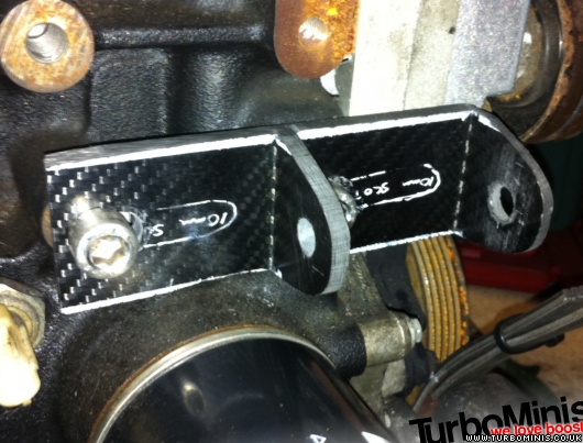

Ive just finished trimming the ECU Bracket aswell

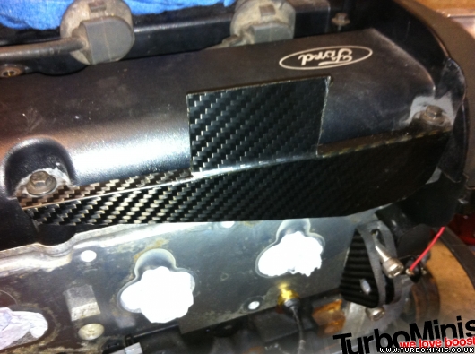

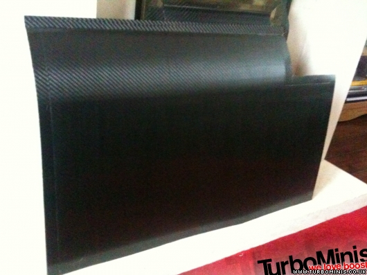

Had a go at a set of Carbon door skins
Had this idea in my head for quite a while, and had to know what the gains would be. Whilst the new skins fit, and sit flush with the outer skin. Its just doesnt have the weight saving I was after. Its has the "Carbon" factor, but thats not what I'm about. But I have a new plan, I'll take a mould off these before completing, and selling them. Its all about learning I suppose.

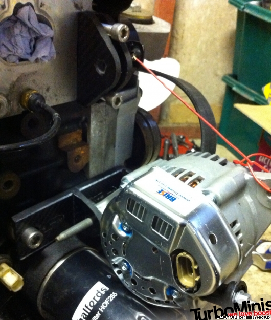

As I cant weld, there was only one way I was ever going to make a new alternator mount!
Made a top mount aswell.

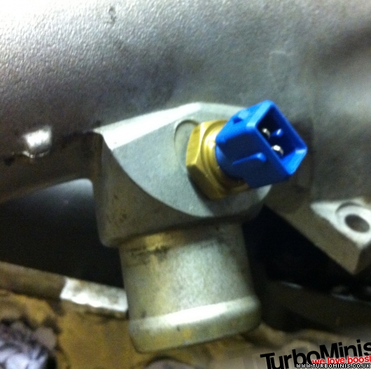

Drilled and tapped the inlet plenum for the Air Temp Sensor

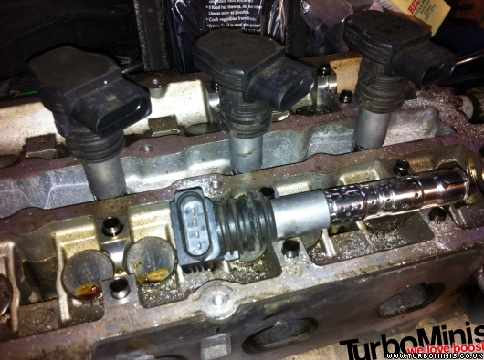

Also started looking at the feasability of fitting coil-on-plug. The RS lads seem to swear by the standard ford setup, even for high BHP setups. So I may abandon the idea, although it does look good!?
Disc bells and Caliper brackets are in progress. Ive also started fitting the flywheel/clutch setup ive sourced.

Disc bells and calliper brackets have arrived, sending them over to get hard anodised before bolting the wilwood 10" discs and wilwood callipers.
