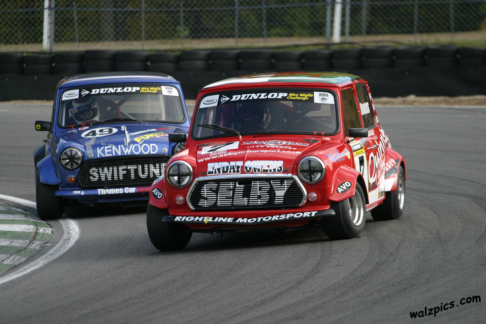

Cripes, what castor do these run?
Why do you say that Nic?
My guess is between 5 and 8
Looks great paul.
As those arms are so tilted they are almost facing the floor
It does run a lot of castor, particularly noticeable on this photo attached.
