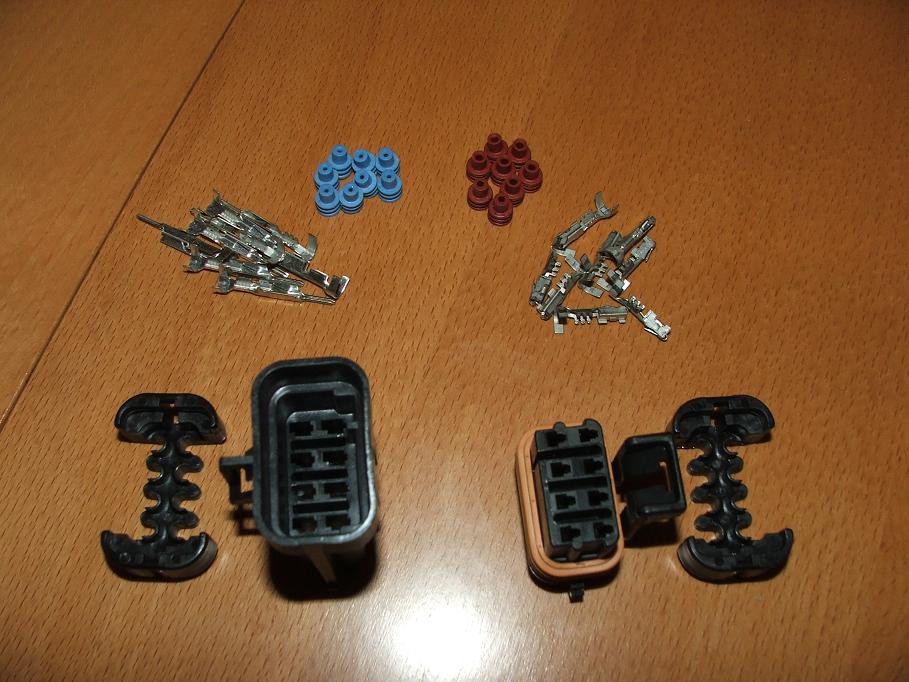

Hi, new member here. I've been following Paul S's progress on his sequential injection project for a while now. I don't own a Mini, but I'm working on a similar project: MGB 'B' series 1800. It shares some of the same challenges as the Mini 'A' series, in that it has the siamesed inlet ports, and a 5-port head.
I'm working on the ignition right now and have been putting together much the same setup for that as Paul. I'd like to share a little bit of what I've found. I'm using a slightly different LS2 coil - the ones without the heatsinks, but they share the same connectors. I found the mating connectors at several places here in the US and ordered a few. The connector is a "Delphi Metripack 150" series, 8-cavity.
These are the part numbers and the prices from the place I ordered from:
http://www.KeefePerformance.com
Description: 12047937 metripack 150 connector,
Item No: 12047937
Unit price: $1.38 USD
Description: 12066304 - 8 cavity 150 metripack lock,
Item No: 12066304
Unit price: $0.29 USD
Description: 12048074 150 metripack female terminal,
Item No: 12048074
Unit price: $0.17 USD
(8 needed)
Description: White Metripack Seal 15324976,
Item No: 15324976
Unit price: $0.14 USD
(8 needed)
Hope this helps.
http://www.keefeperformance.com/metripack150/12047937.html

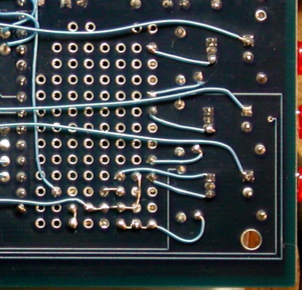

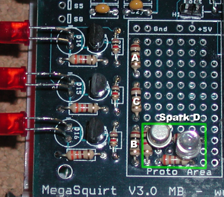

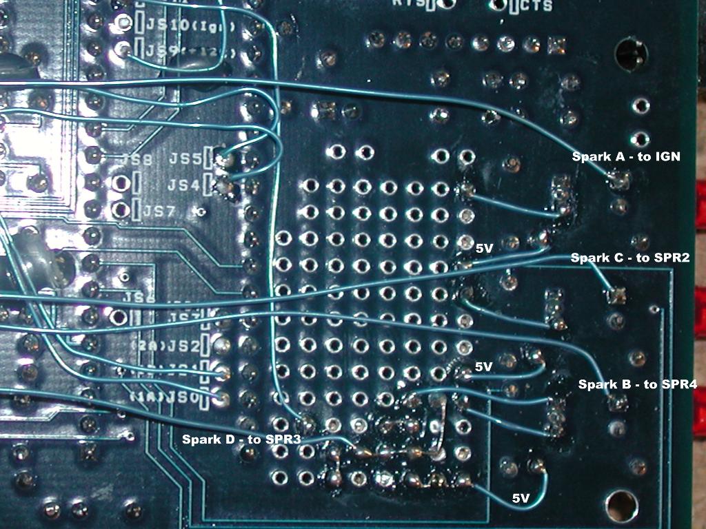

I've made mods to the rev3 board to set up for 4-sparks, 5V logic level output. This is basicly my implementation of what's documented here:
http://www.msextra.com/ms2extra/MS2-Extra_Ignition.htm
toward bottom of page 'ground switching'
I used a 2n2222 to build the 4th 'spark-D' circuit, just copying the other 3 LED drive circuits.

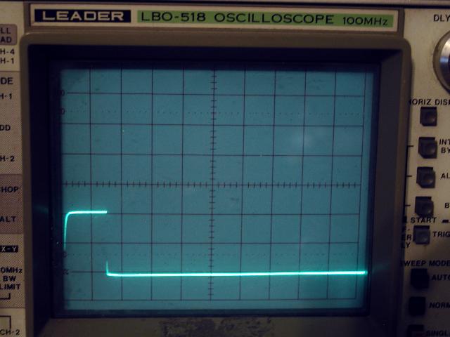

The LS2 coil appears to want a high-going pulse for the dwell period. This means set the spark output setting in "Ignition Options" to "Going Low (Normal)". My understanding is that it has a built in dwell limiter though, so if you go over something like 5ms setting it just internally limits it to about 5ms.
Here's a scope trace of the IGN output that's driving spark A from the modified circuit, at 1.5ms dwell (the other 3 spark signals look the same):
Edited by Gerald O on 2nd Apr, 2009.

Gerald,
Just a little advice: you should clean the flux off the board. It can cause annoying problems because it can be conductive or become conductive after a while (because it absorbs moisture).
Use isopropyl alcohol (rubbing alcohol) to clean the board (99% works best).
Jean
http://www.jbperf.com/
Gerald O
8 Posts
Member #: 5706
Raleigh, North Carolina, US
Yes, I will do that, thanks.
I just made the mods this evening, but it will get cleaned next. :)
The rest of the board was already cleaned before.
Better now? *happy*
