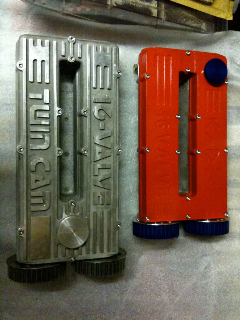

for anyone interested, heres the major difference between the long and short cam carriers on a KAD head....Its 65mm different. Pulleys are smaller too.
Its not quite a chop job either, as the right hand (from front) cam carrier cover stud drillings are in a different position.
6966 Posts
you flash bastard.lol
carl
manifold
203 Posts
Member #: 1734
Lancaster
*wink* yes it does look a bit tarty!
