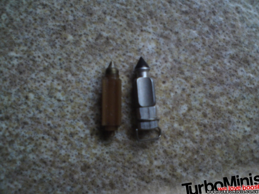

So i've whipped the carb off again to have a proper look at things (again).
Heres a picutre of the needle valves, standard (left), "high-flow" from Avonbar on the right.
I looked down the brass needle valve chamber (the thing that screws into the carb body) and compared it to another one. The only other one I had being off a HIF38.
Comparing the holes that the tip of the needle valves sit in, the one that came off my HIF44 is about 1/3rd larger in diameter than the HIF38, is this right?
Would I have a problem putting the one from the 38 into my HIF44 body? And im not sure, but I think the standard needle valve I have is from the 38, would this matter?

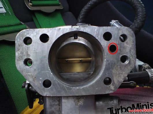

And last but not least. In the picture below, what is the hole circled in red for? As When I take the carb off fuel comes out of it, and this is on the plenum side, but im unsure what its for/if it should let fuel though it?
Ta
